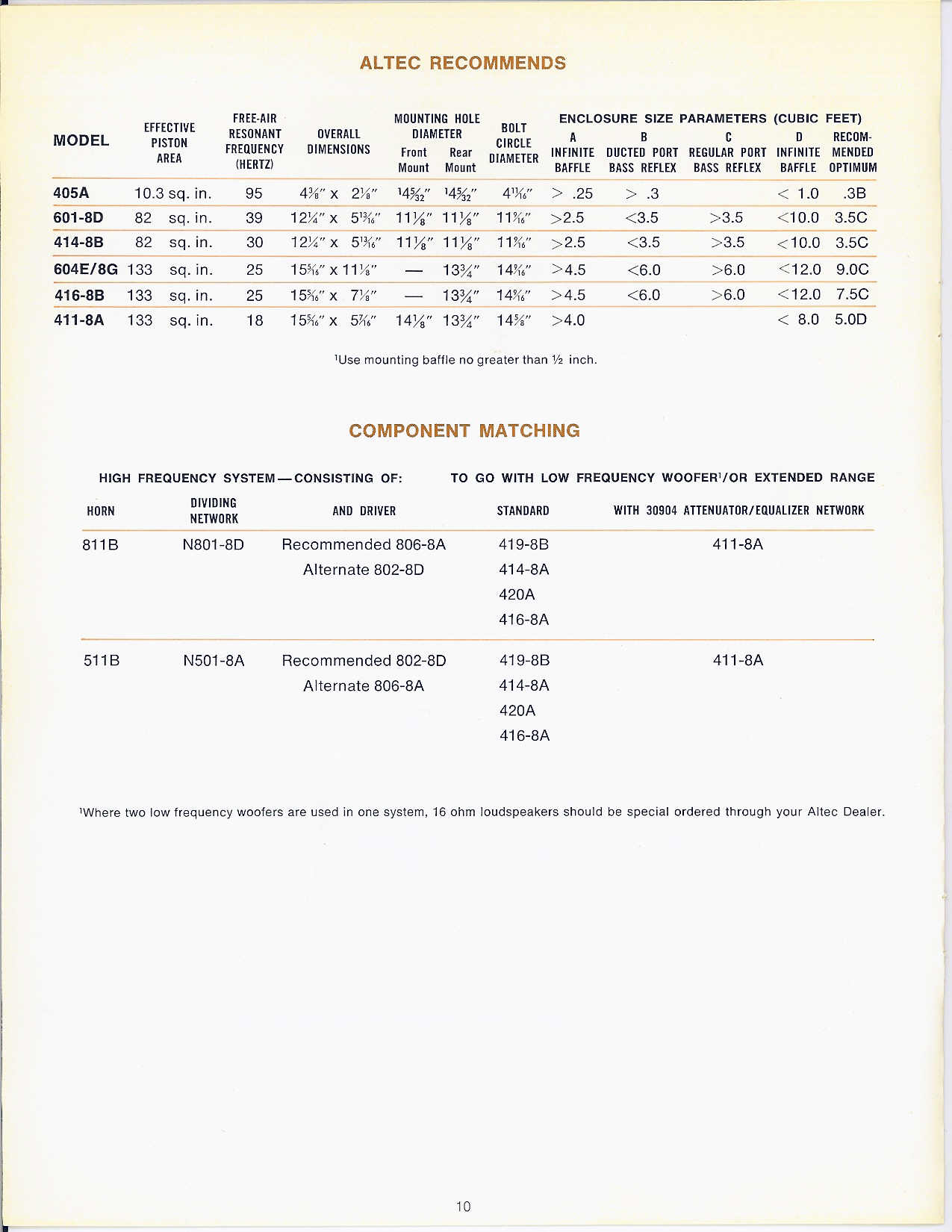

These are basically 414 woofers, so the classic alignment is ~6.5 ft^3 tuned to actual driver Fs, which typically yields Altec's 'West Coast Sound', i.e. prominent mid bass with decent power handling whereas ~10 ft^3 gets a more balanced sound all the way down to Fs in a typical room, though with reduced power handling down low unless there's significant [small] room gain.
Ideally the driver will be centered at average seated ear height and down from the cab's inside dimension ~33-40%, so these two will determine total cab height and make the baffle as wide as practical, which of course will be limited by its minimum depth = ~1.5x driver depth.
The vent will ideally be down from the inside top ~0.8-0.86x.
Altec's typical damping of 1-2" [your choice] acoustic fiberglass insulation [OC 703 nowadays] on the top, one side, back down about 60-70% is normally plenty, though you may want to do the vintage 'click' [impulse] test to confirm the vents are damped enough by the cab's high aspect ratio TL pipe harmonics.

On your 601c the woofer is basically the same as a 414 series and it seems Altec recommends a 3.5 cubic foot ported cabinet. I am using Altec 416 8b and i run them in the recommended 7.5 cubic foot cabinet with two 4"diameter 5" deep ports this tunes them down to about 32hz they sound amazing. The 3.5 cubic foot cabinet will limit your deep bass but you can always add a good sealed sub.
Thank you guys, this help me a lot, I just made calculations and the Altec Stonehenge I enclosures at 37.5'' H, 16'' W and 14 1/4'' D would give me 3.82 Ft cube with 0.75 thich material just about what I need, and the drivers are higher than the Karlson design. They look cool to ! Thank's!
