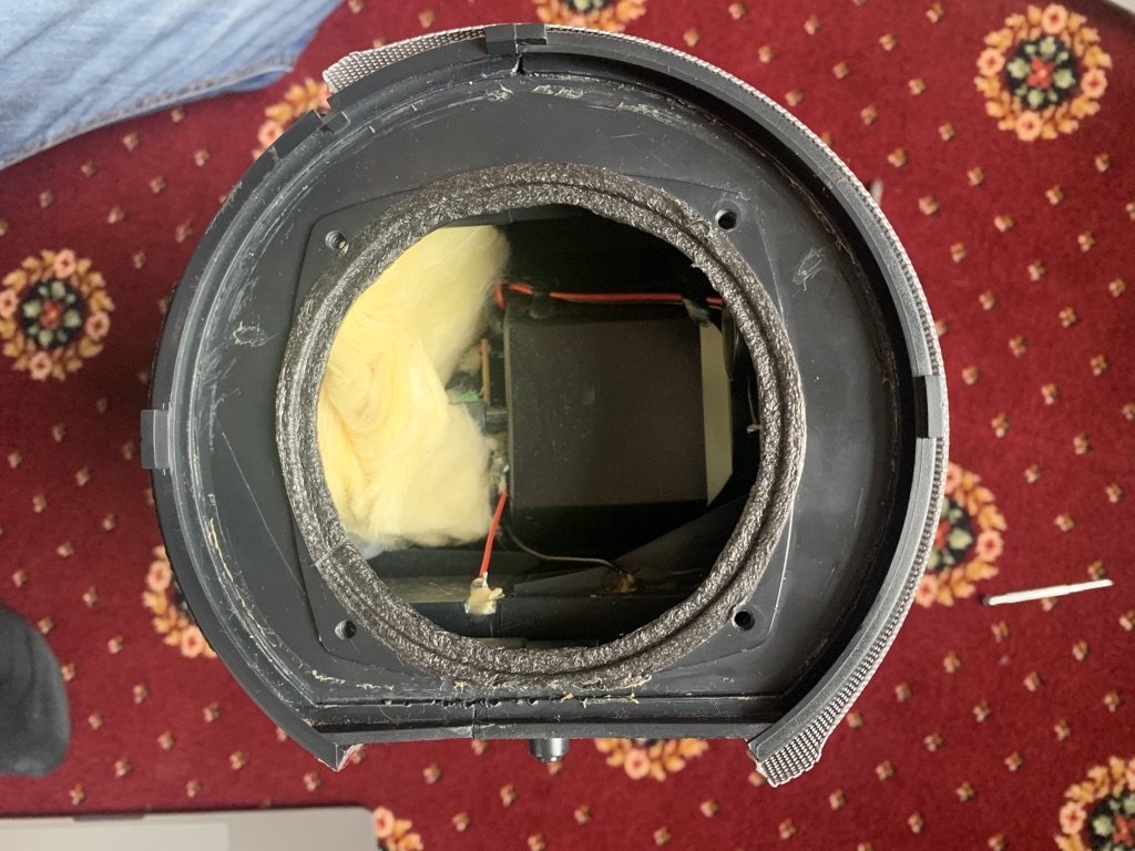

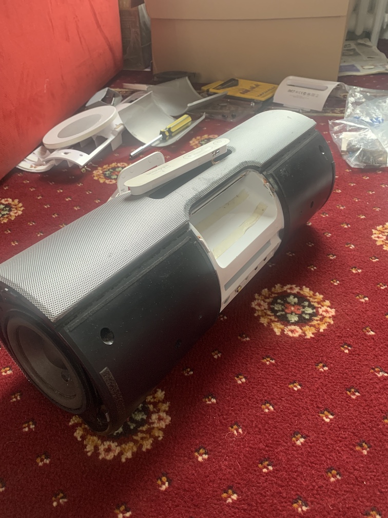

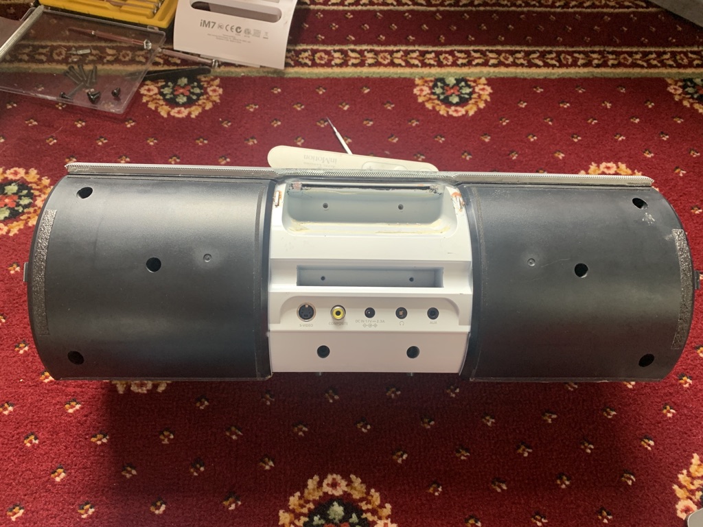

Hi, I'm hoping someone here might be able to help me to open up my own iM7.
The DC barrel is faulty and I'm hoping to replace it, but the iM7 seems to be glued together at every stage!
I've got both side speakers unscrewed (following this iFixit guide) but the two halves just will not separate (see Step 7).
It sounds like one or two of you have managed to reach the circuit board inside the iM7 - do you have any words of advice on prising it apart?

Did you remove the mesh grilles over the speakers, not sure but I think that they
hook over the other half.
I don't actually remember the trick to open it.
I wrote this in post #11 but I don't have the unit in front of me so I'm not
sure about the details:
"OK got it, there is a slot that is glued in, pry from underneath the plastic."
I don't remember if the slot was some sort of cover or if there are screws in the slot, sorry.
Thanks for taking the time to reply.
I've removed the grille from the back but not the front. I wasn't sure if it should be removed, as the plastic surround around the iPod 'holder' felt like it didn't want to come out.
If that's a step I've missed then I'm happy to give that another go.
