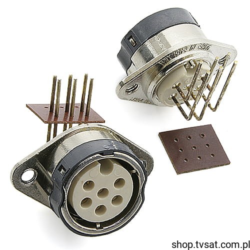

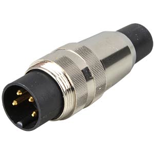

Alternative to Belling Lee's DIN Plug/Socket L1904A/L1904C - from Linn's Lingo or MOSE's Control Unit to 110VAC Synchronous Motor (e. g. LP-12)
Belling Lee's Series 1904 (go to post #2 under
https://www.diyaudio.com/community/...pole-l1904-for-lingo-why-so-expensive.242545/

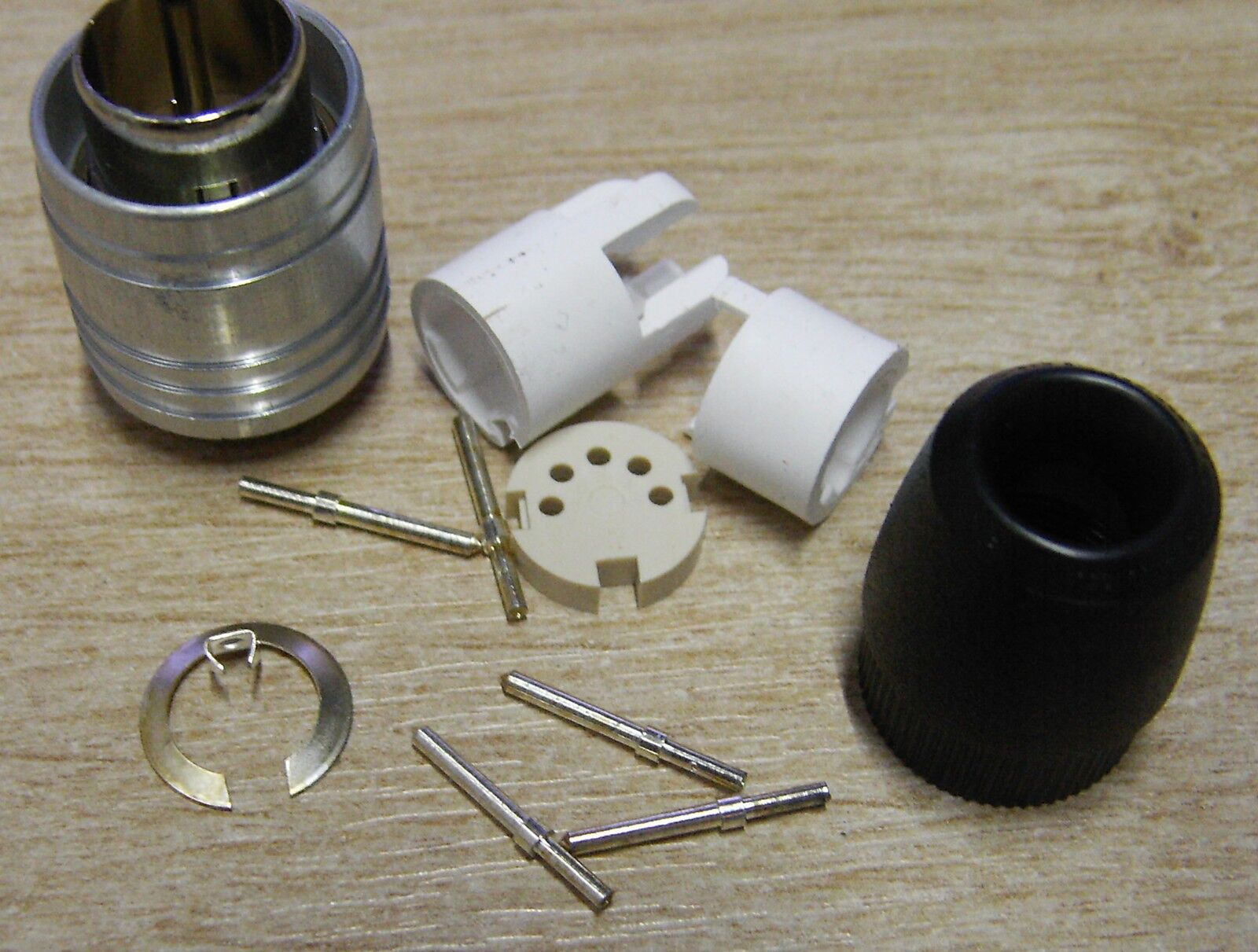

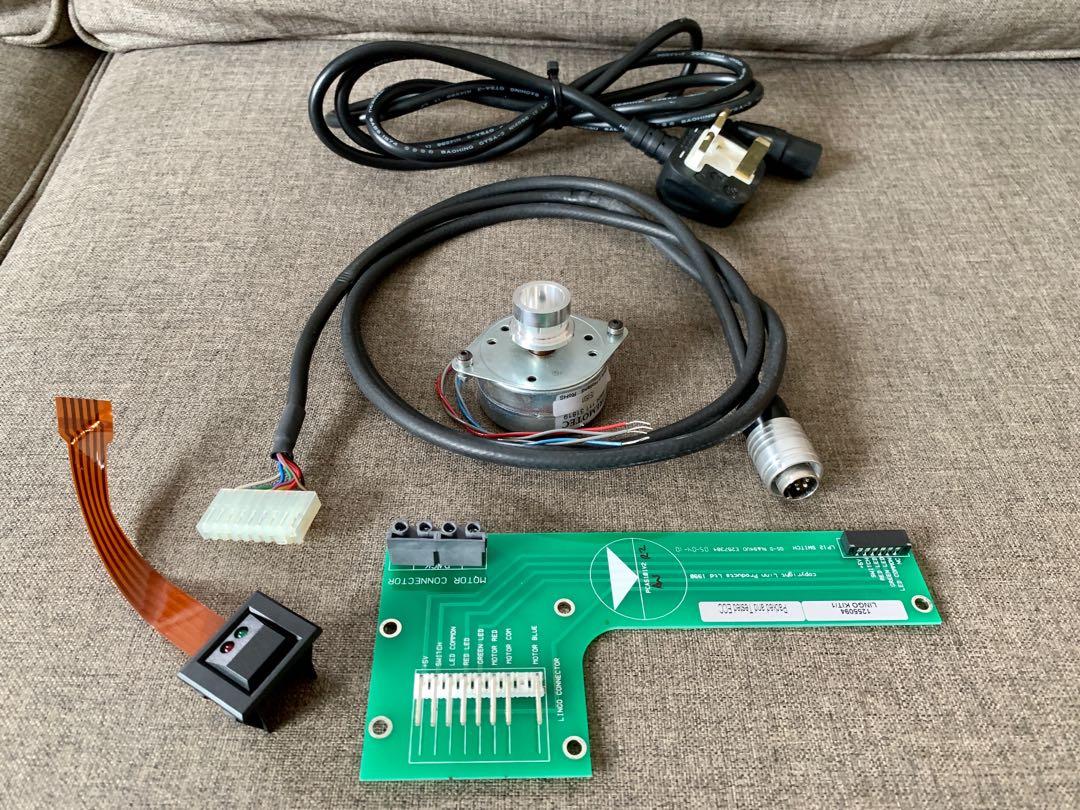

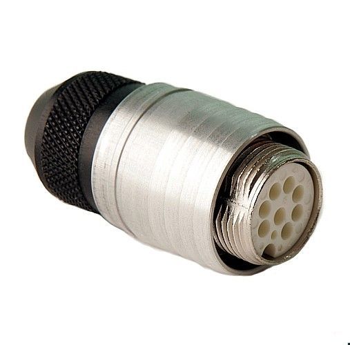

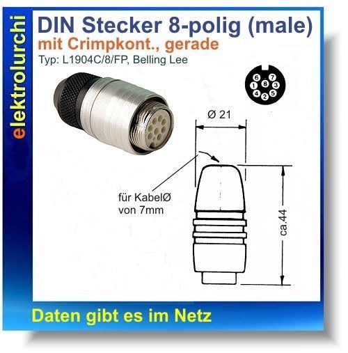

for the associated datasheet) is both too expensive and only partly available as NOS part (some Images of this connector parts in the attachment). Therefore I am looking for other appropriate and currently available connector brands.

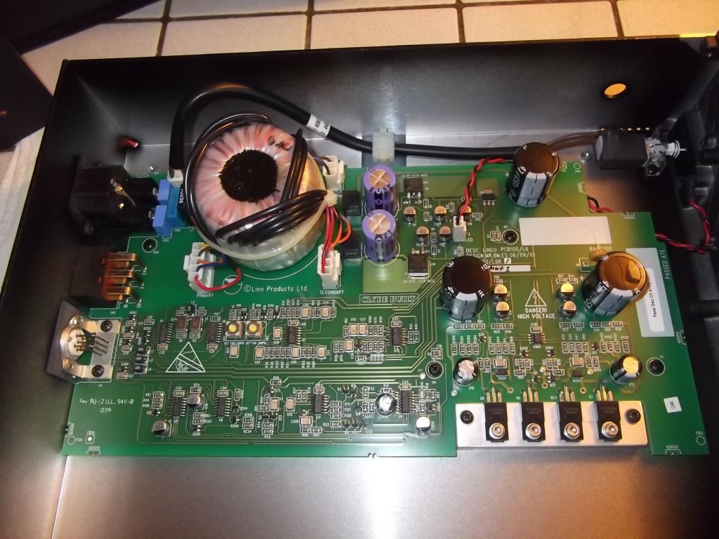

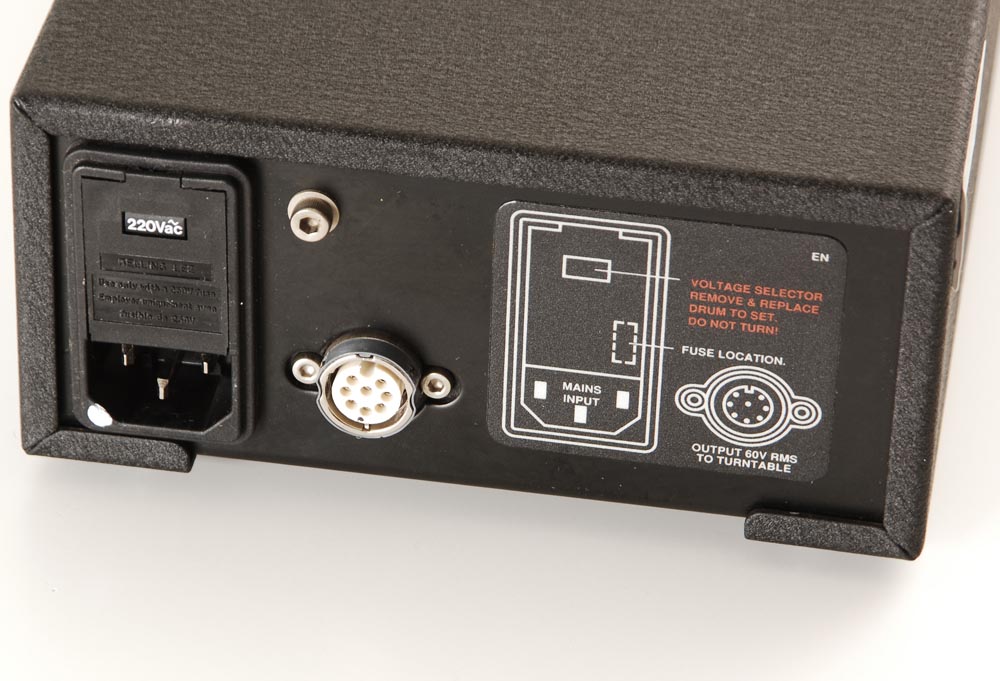

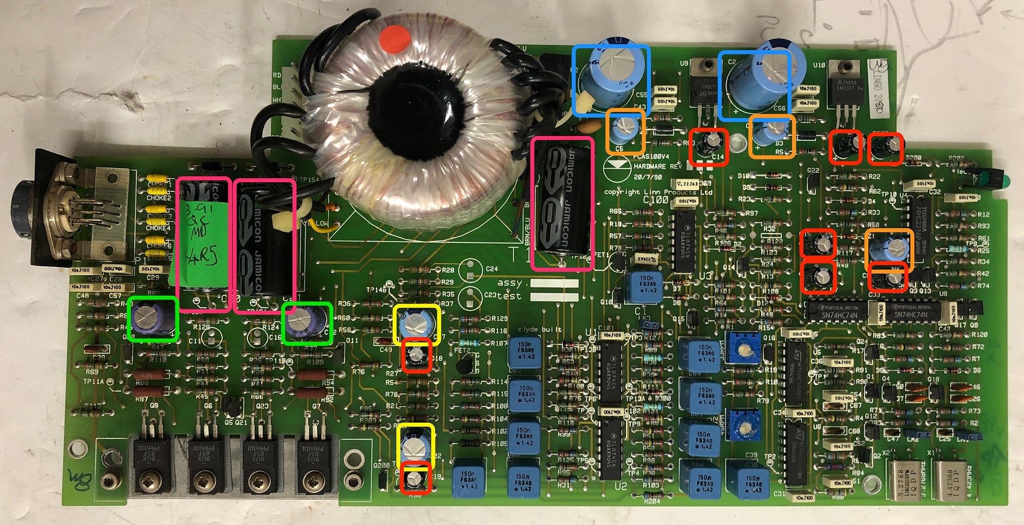

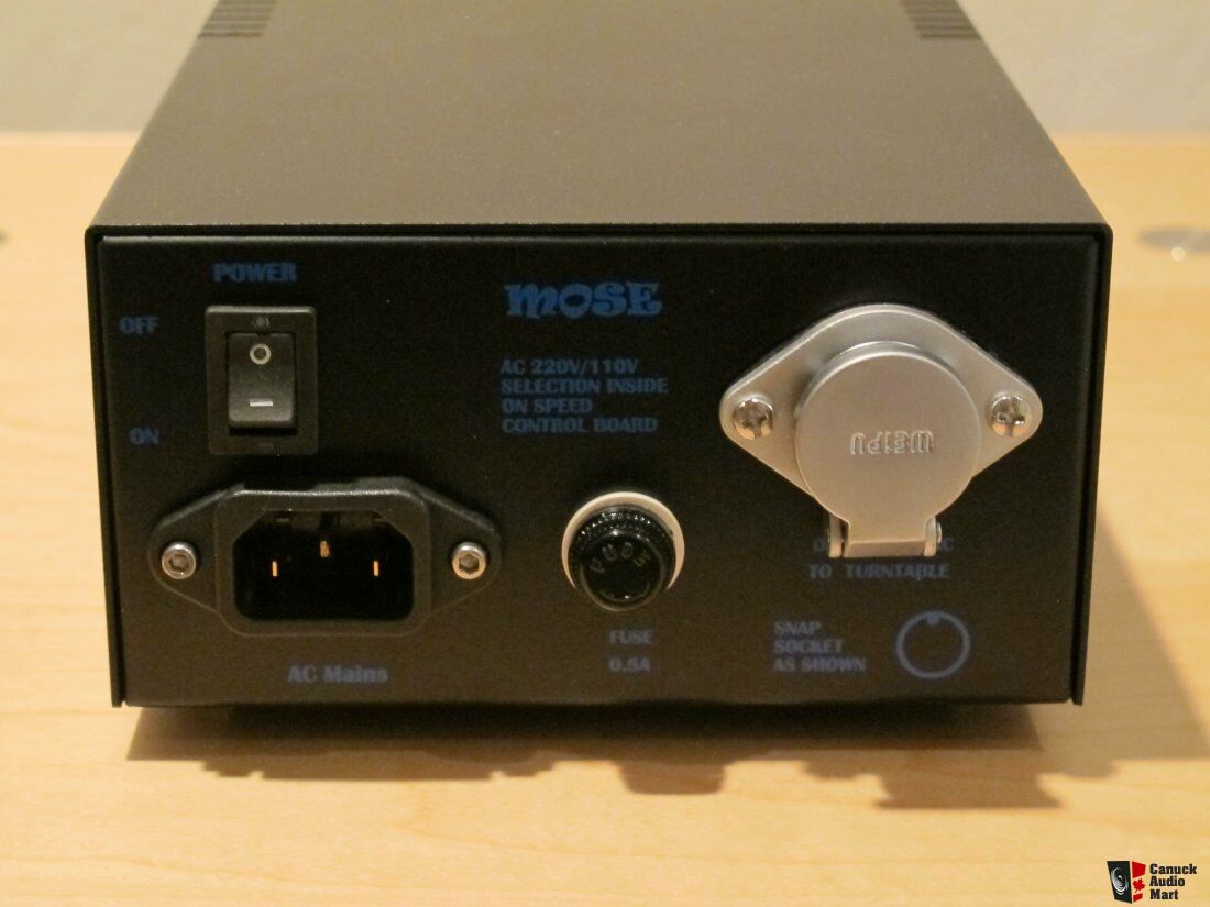

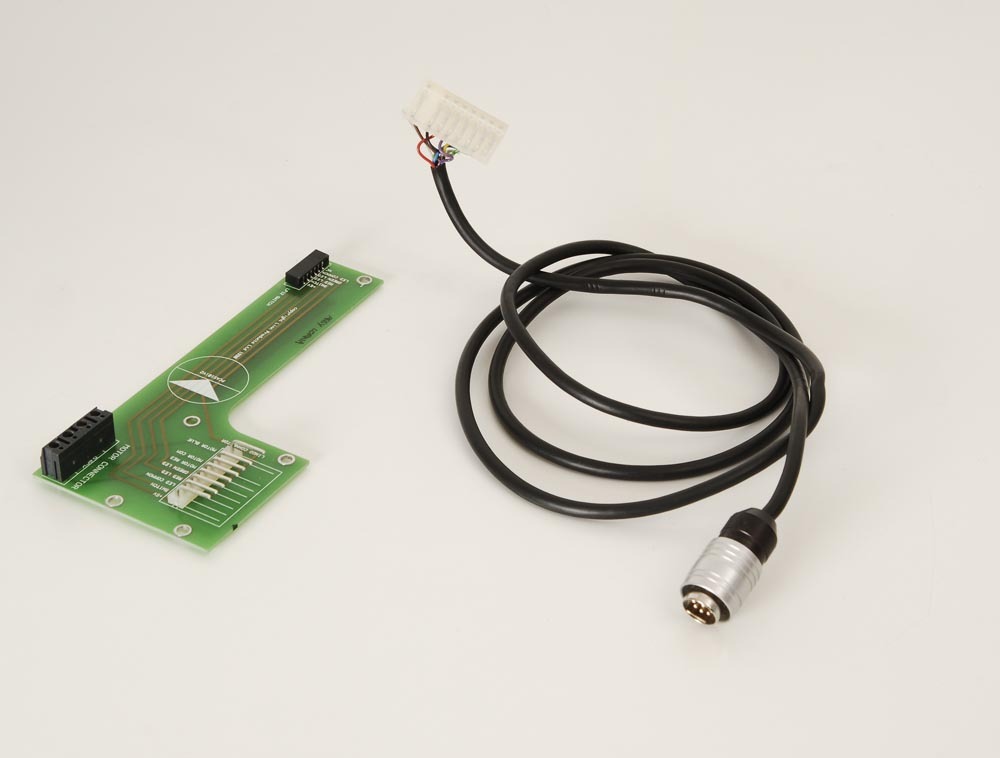

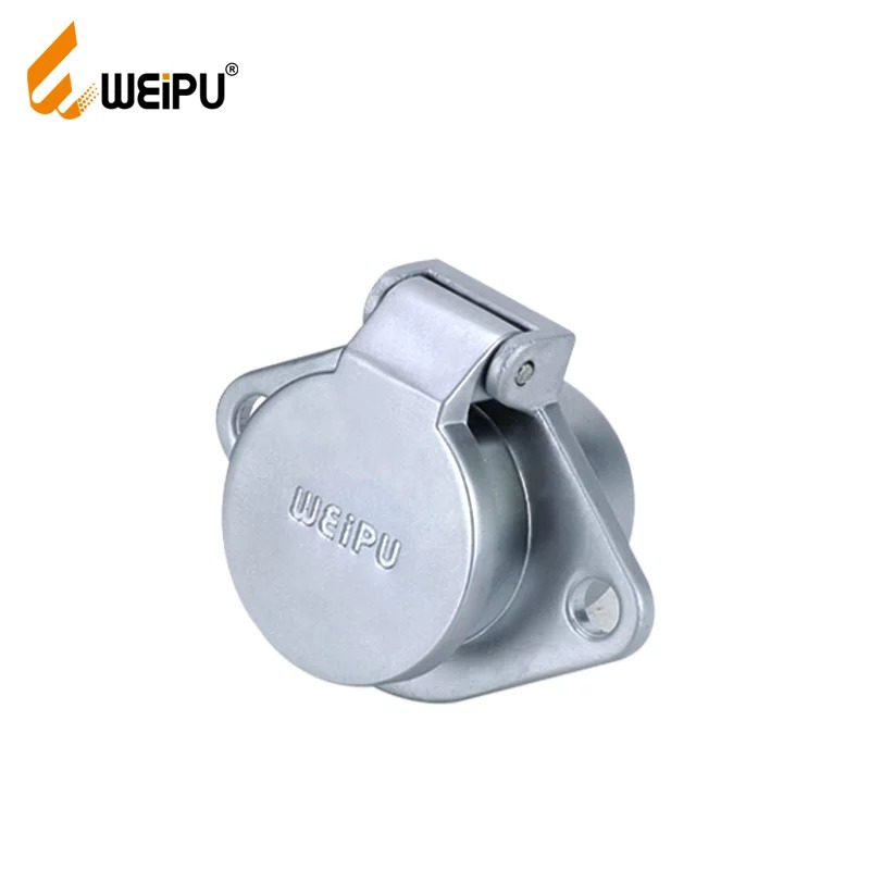

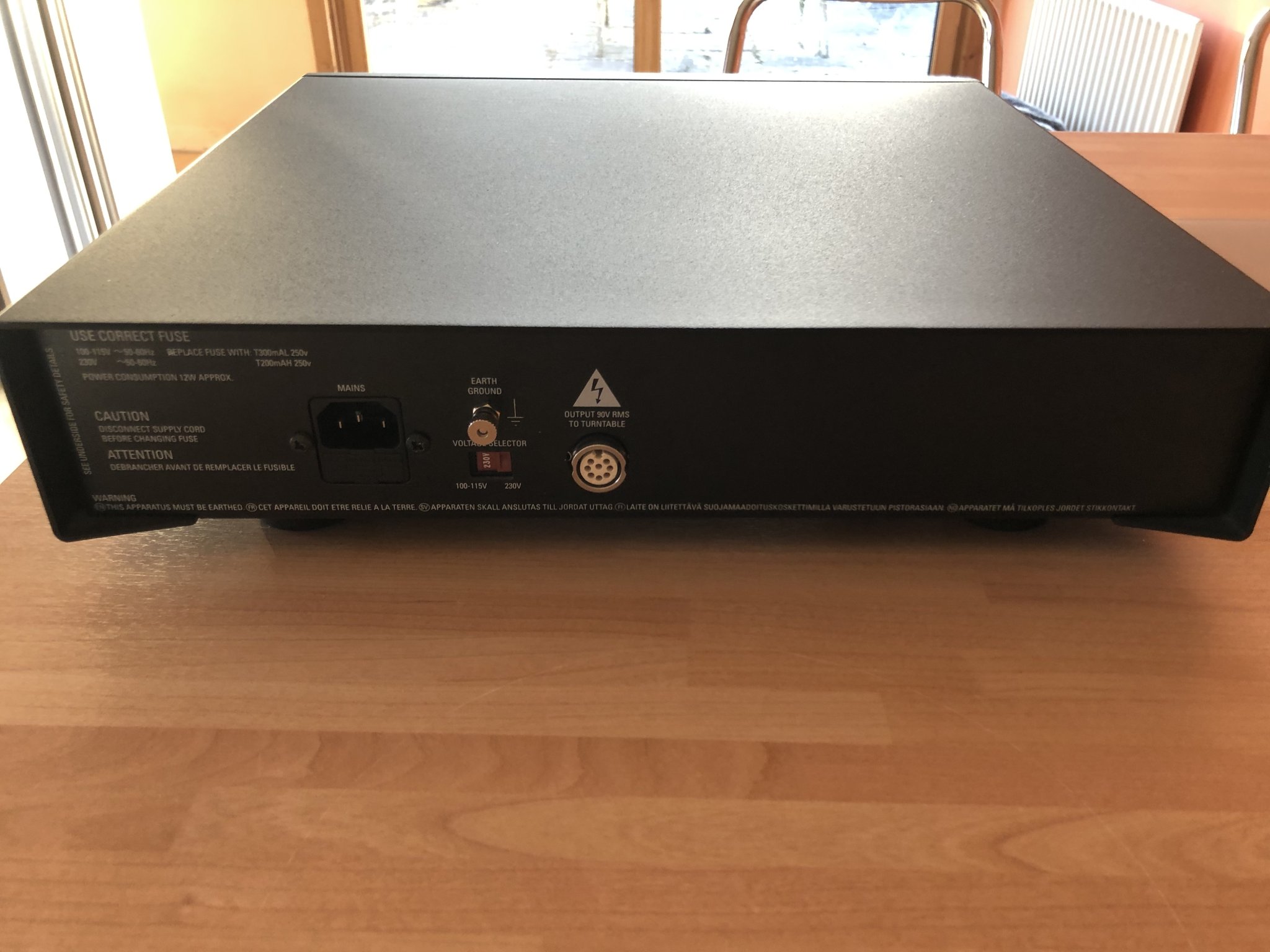

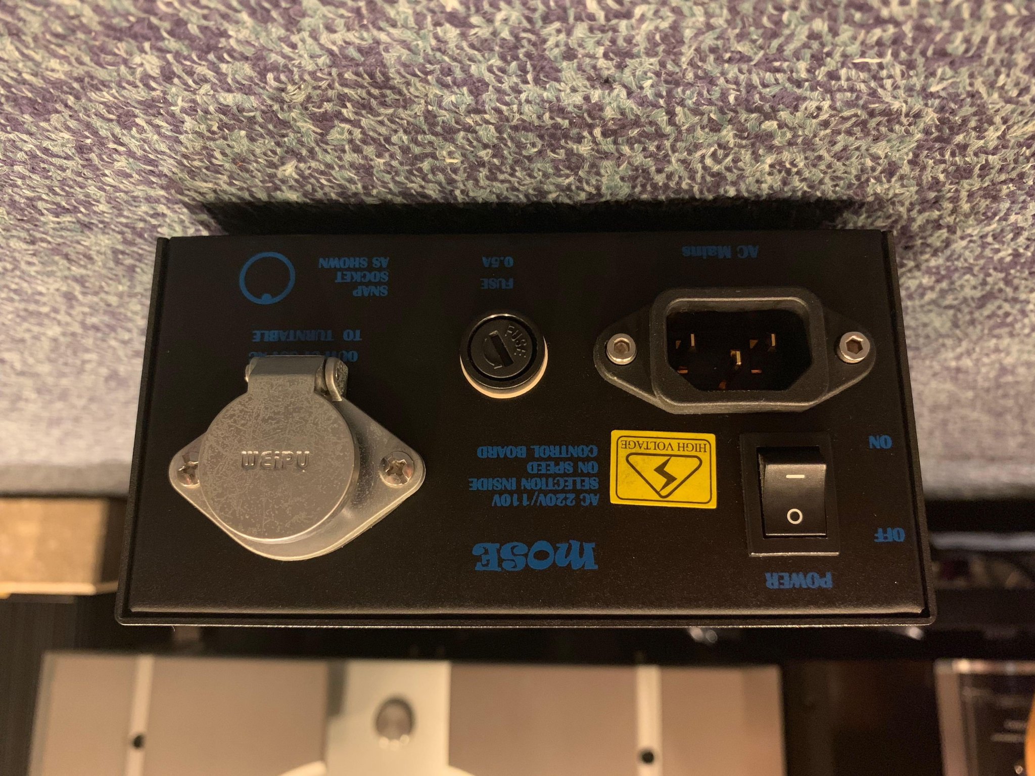

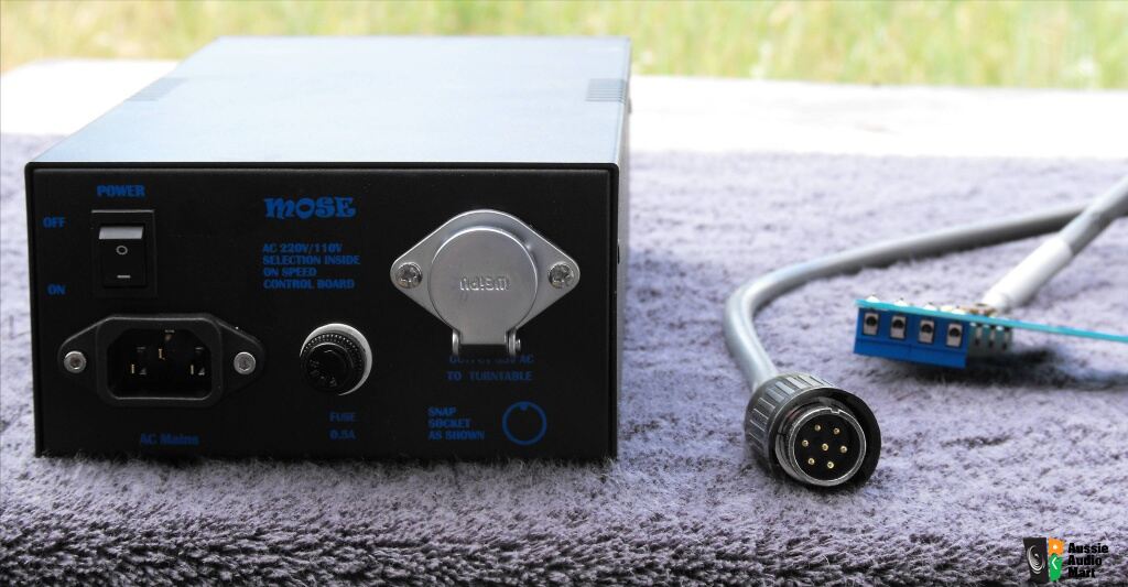

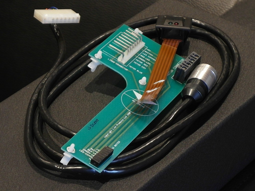

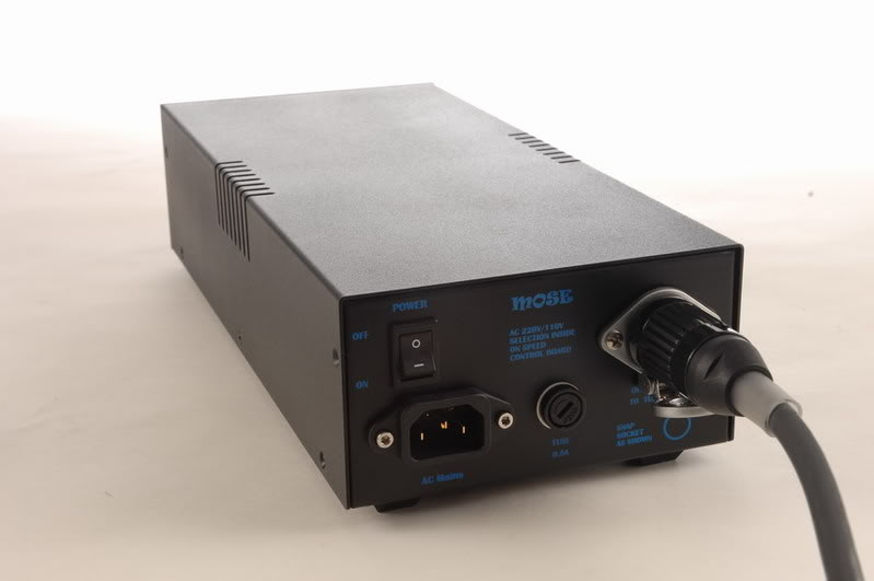

The MOSE motor control unit with Hercules PCB uses the brand WEiPU - I guess the WP20 series - obviously obsolet in the meantime:
https://www.weipuconnector.com/products/sa20/
https://www.in2connect.uk.com/wp-content/uploads/2022/02/Weipu-WP20-Series-Catalogue.pdf - go to the attached files in post #2.

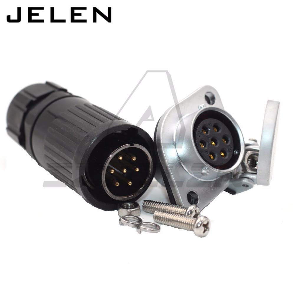

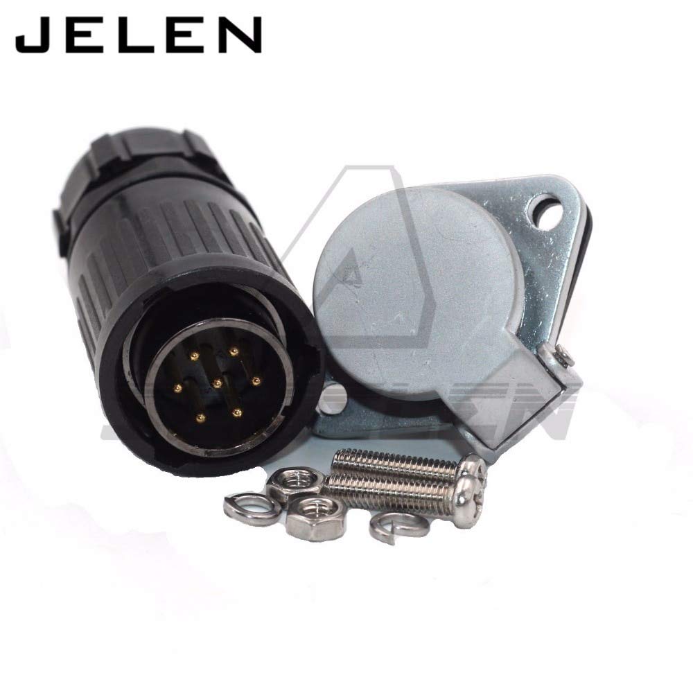

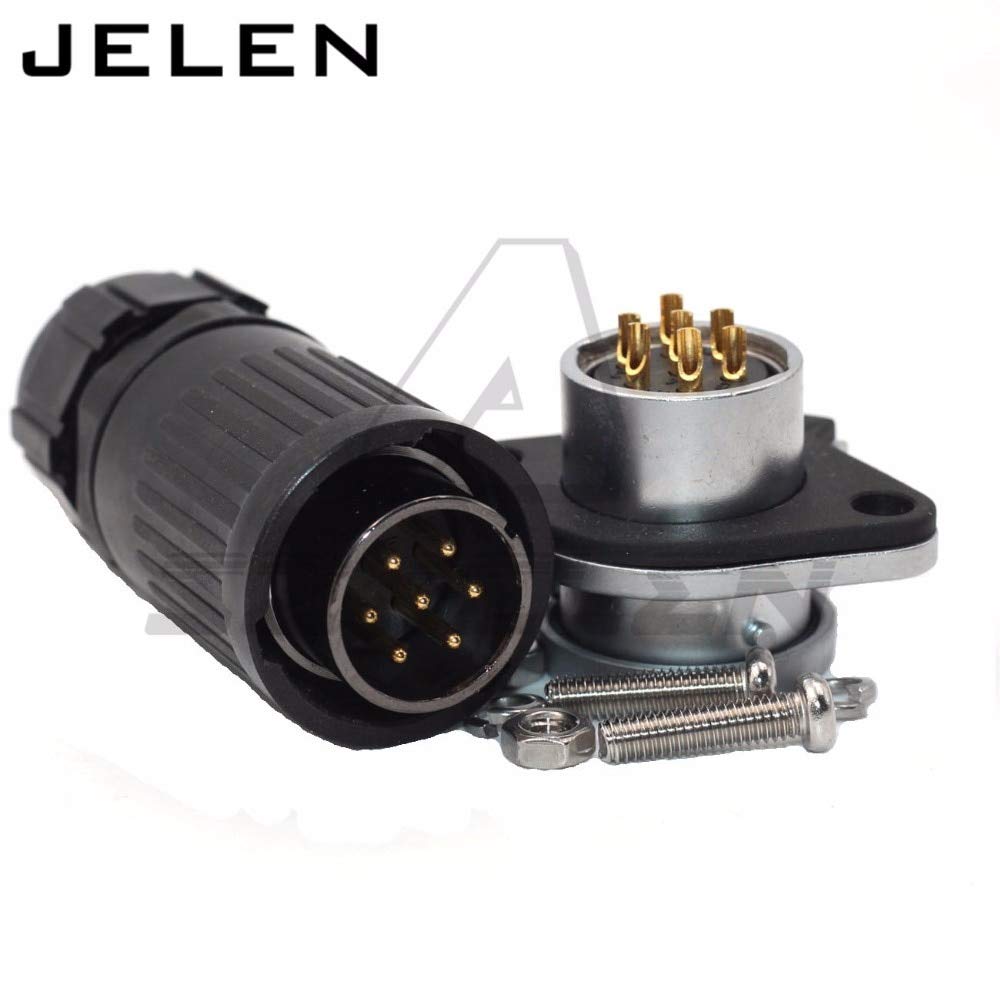

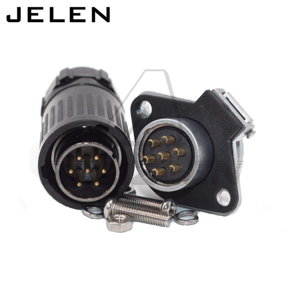

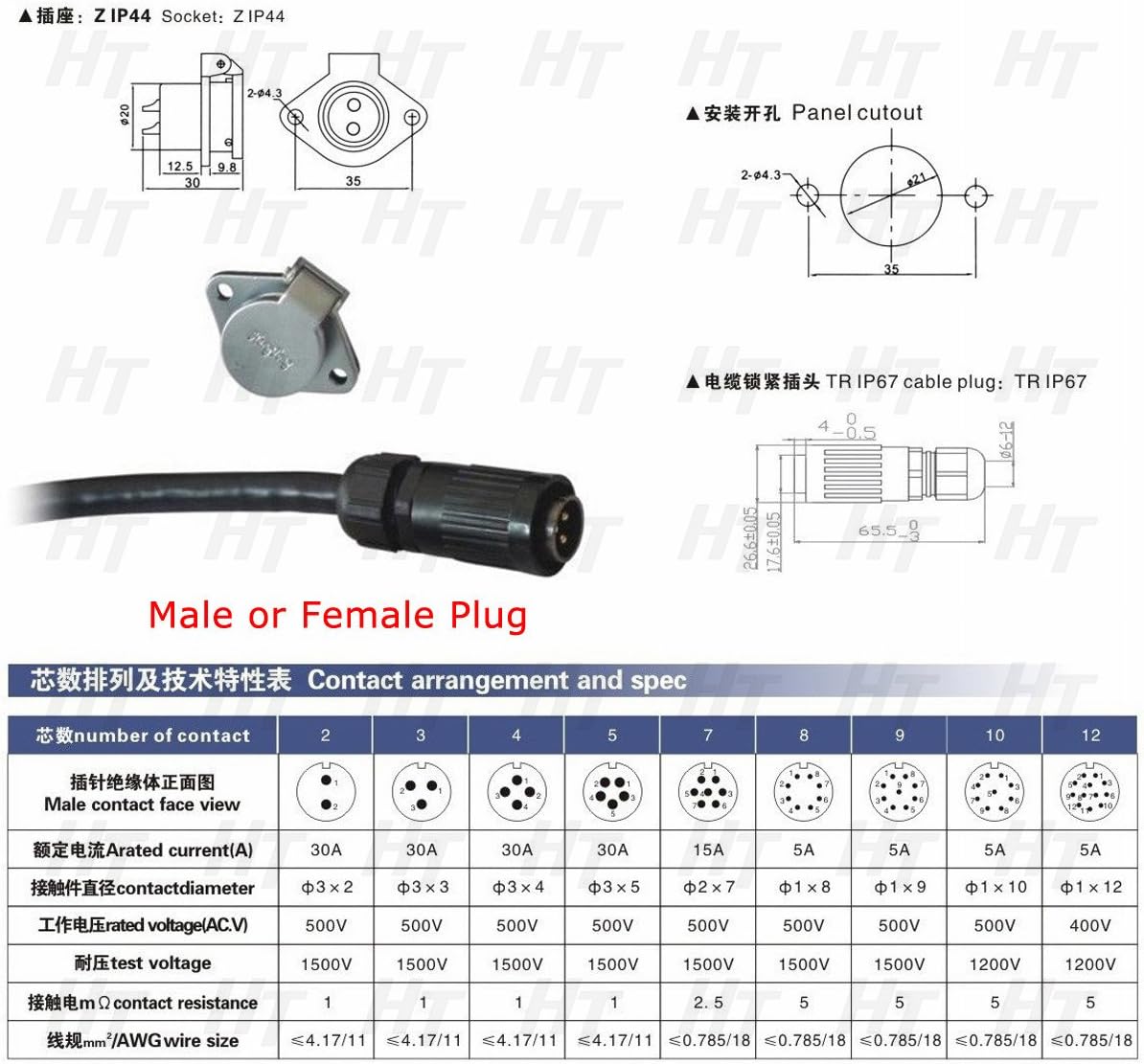

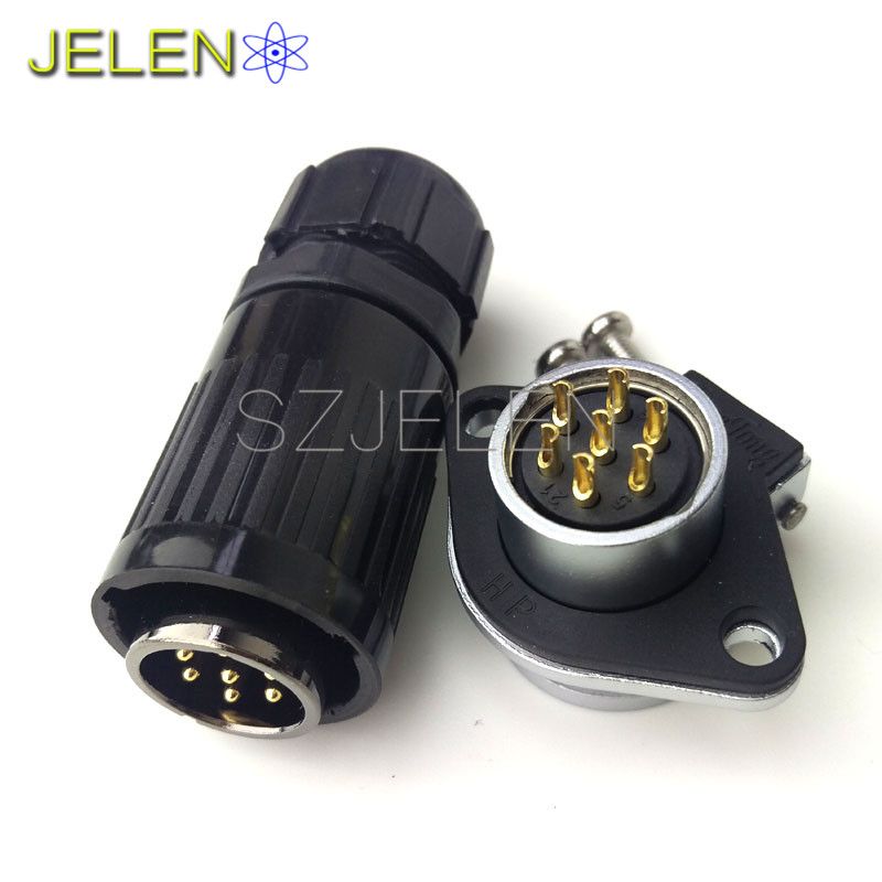

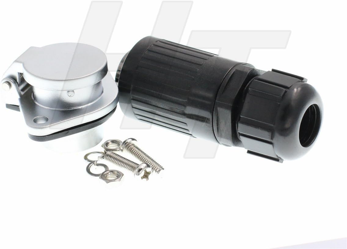

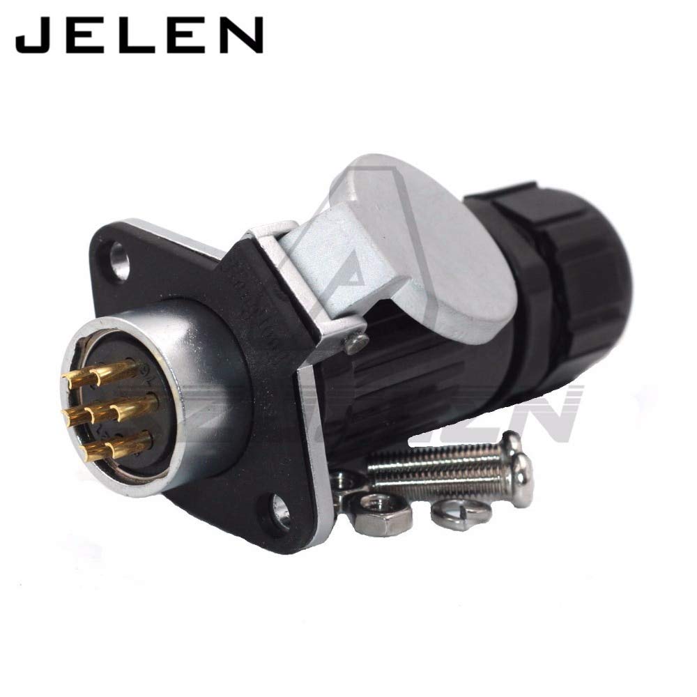

Jelen's HP20 and HE20 seems to be clones from Weipu's WP20 Series and only available in far east - go also to the images in post #2.

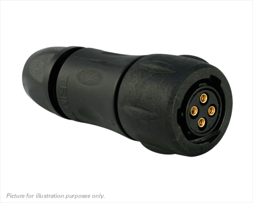

In post #3 from above mentioned URL there is a recommend to the brand Eaton-Souriau, and the UTS series. Maybe the 4-pin and 5-pin are suited - go to pg.68 (4-pin) and page 72 (5-pin) under
https://www.eaton.com/content/dam/e...proof-plastic-connector-UTS-catalog-en-eu.pdf
e. g. this version:
https://de.souriau.com/de-DE/uts-se...ies-uts-series-plastic-waterproof-ip6869k-142

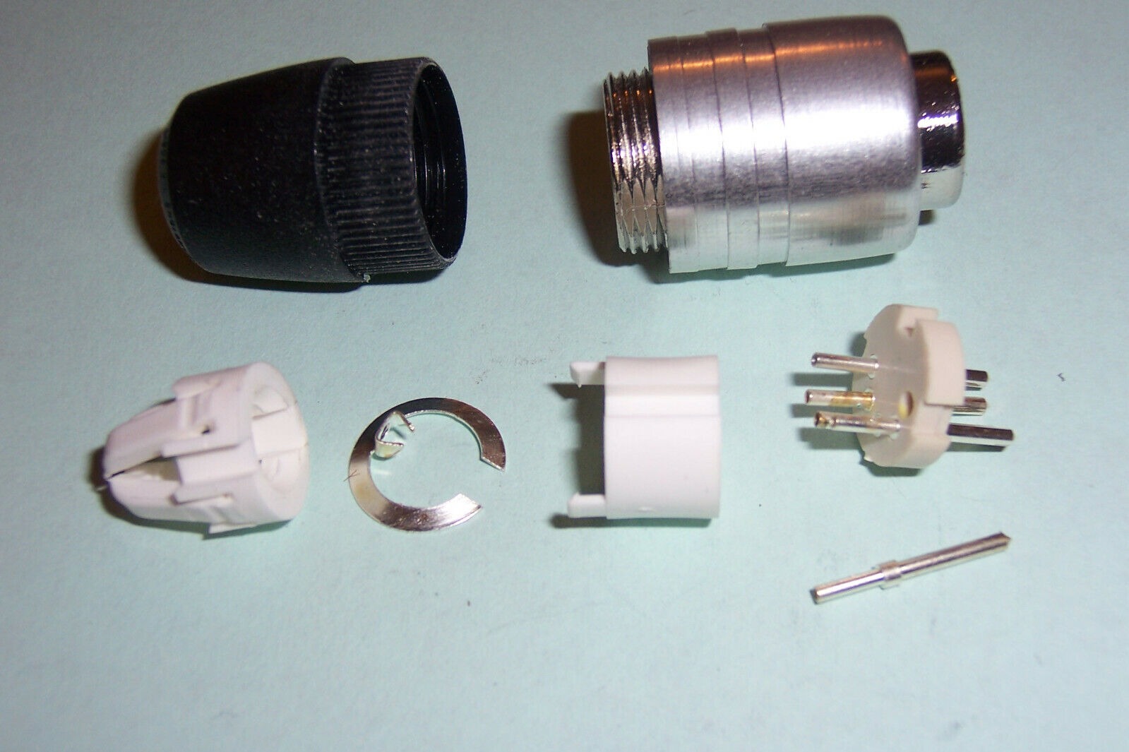

WEiPU WP20 and JELEN's HP20/HE20 series - for connection between Hercules motor control and 110VAC synchronous motor
  • Weipu-WP20-Series-Catalogue.pdf

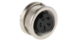

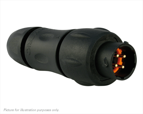

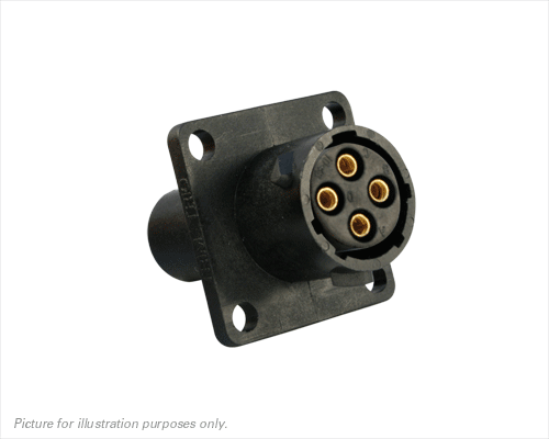

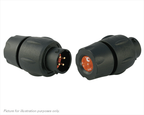

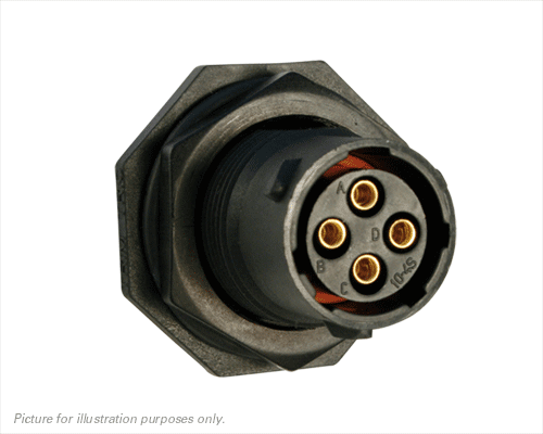

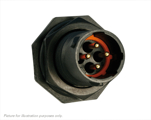

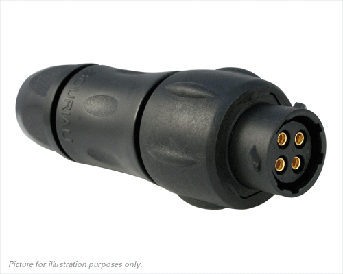

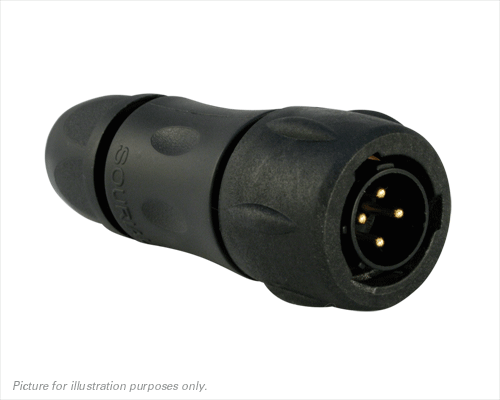

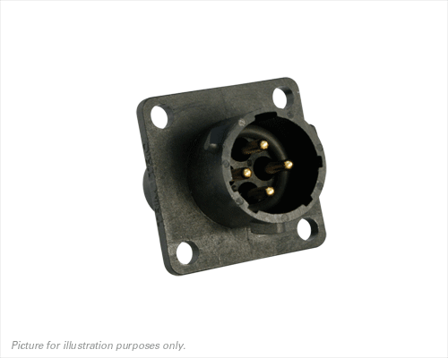

UTS series from Eaton-Souriau looks interesting and seems to be a reliable and safety choice for diy projects.

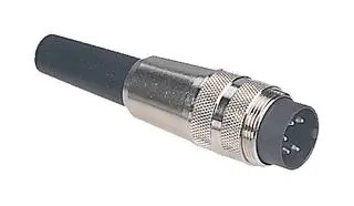

In the eleventh PDF attachment (overview UTS series) are only mentioned the male connectors from image No 1-5, which are suited to the female connector "UTS6JC104S" from image No 6.
The female connectors from image No 7-9, which are all suited to the male connector "UTS6JC104P" from image No 10, is not mentioned in the overview in eleventh PDF attachment, which initially confused me a little bit.
Here the URL's of EATON SOURIAU UTS Series
Wall Mount resp Panel Mount Plug/Einbau-Stecker UTS0104P (Male, P=Plug - Plastic square flange)
https://de.souriau.com/de-DE/uts-series-uts-series-uts-series-fiber-optic-connector-uts-series-uts-series-plastic-waterproof
https://www.mouser.de/ProductDetail/Souriau/UTS0104P?qs=IZeJX%2FTuQpnlGolyZaJbvw%3D%3D (10 €)
Wall Mount resp Panel Mount Plug/Einbau-Stecker UTS7104P (Male, P=Plug)
https://de.souriau.com/de-DE/uts-series-uts-series-uts-series-fiber-optic-connector-uts-series-uts-series-plastic-waterproof-30
https://www.mouser.de/ProductDetail/Souriau/UTS7104P?qs=mr%2FYtQLfk95WDpA02rYWKQ%3D%3D (10€)

Cable Mount Plug/Kabelstecker UTS6JC104P (Male, P=Plug, cable gland/Kabelverschraubung)
https://de.souriau.com/de-DE/uts-series-uts-series-fiber-optic-connector-uts-series-uts-series-plastic-waterproof-ip6869k-137
https://www.mouser.at/ProductDetail/Souriau/UTS6JC104P?qs=mr%2FYtQLfk96KUKeIa87PgA%3D%3D (18€)
Wall Mount resp Panel Mount Socket/Einbaubuchse UTS0104S (Female, S=Socket - Plastic square flange)
https://www.souriau.com/en-en/uts-series-uts-series-uts-series-fiber-optic-connector-uts-series-uts-series-plastic-waterproof-1
https://www.mouser.de/ProductDetail/Souriau/UTS0104S?qs=IZeJX%2FTuQpkDdNCt2Iw0tQ%3D%3D (10€)
Wall Mount resp Panel Mount Socket/Einbaubuchse UTS7104S (Female, S=Socket)
https://de.souriau.com/de-DE/uts-series-uts-series-uts-series-fiber-optic-connector-uts-series-uts-series-plastic-waterproof-32
https://www.mouser.de/ProductDetail/Souriau/UTS7104S?qs=mr%2FYtQLfk94%2FW3362YlmIg%3D%3D (11 €)
Cable Mount Socket/Kabelbuchse UTS6JC104S (Female, S=Socket)
https://de.souriau.com/de-DE/uts-series-uts-series-fiber-optic-connector-uts-series-uts-series-plastic-waterproof-ip6869k-139
https://www.mouser.de/ProductDetail/Souriau/UTS6JC104S?qs=mr%2FYtQLfk959ZRFIIw3GVw%3D%3D (15 €)
