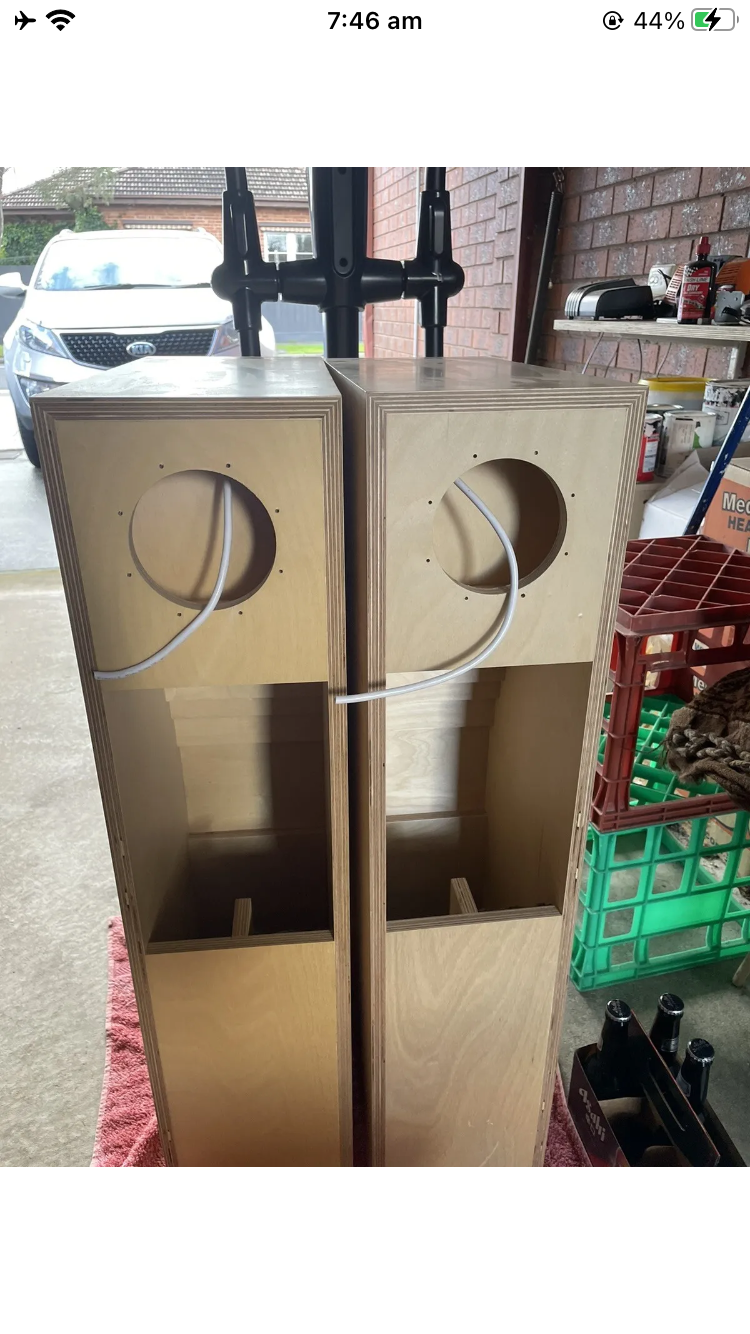

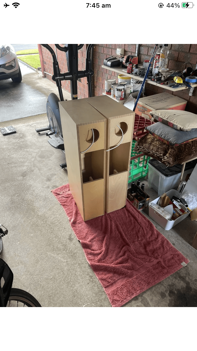

Hello I picked up some beautifully made cabs yesterday and they were made for a fostex fe108sigma. I couldn’t pass them by for the quality build and price. At the time the driver requirements was unknown.
I have attached pics of the cabs.
does anyone know of a budget driver I can put in these that would sound good? At hand I have fe103 sol & ff105wk’s. I just missed the opportunity to get some early 103/4’s.
can anyone recommend a driver I. Can try in these horns even mark audio or TB that may sound great. I’d like some 4” mark audio as a bit of difference but using the forementioned fostex would keep the project prece Down.
I’ve attached pics of the cab. It’s well known . If nothing else will work I will try and get some fe108 sigmas but they are in a high price bracket & in Australia a pain to buy! Fostex and mark audio have distributers that are much more attractive due to shining. Happy with second hand too.

Based solely on published specs, the 105WK is a near enough drop-in with maybe a bit less* 'robust' (mid) bass due to lower* Qts. Regardless, suggest trying one before 'we' spend anymore time on it. 😉

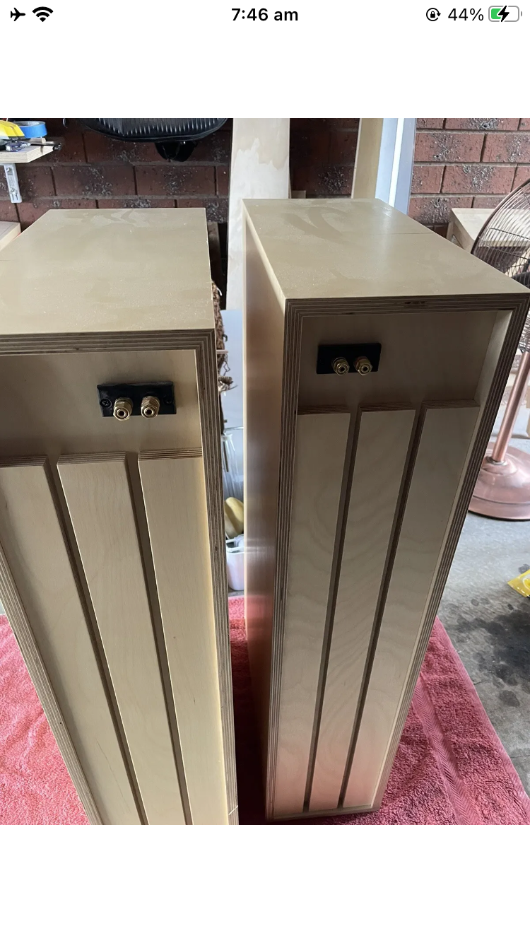

FYI/FWIW/YMMV: Not keen on filled knotted plywood, so if any hint of cab related noise, recommend mass loading them with heavy weight perched on top (typically requires ~cab weight).
* Oops! Edit per p10: May need a bit of series resistance to 'fill up' the cab a bit.

Thanks both. I got the cabs for less than a sheet of plywood & it turns out they were very professionally built & finished I just couldn’t pass them buy. Someone put a lot of effort & money into building them, they were not your average build.
The ply that I was told was Tasmanian oak doesn’t have any notches. I was very impressed with the quality of materials & perfect finish - mitre joints rather than square joints so I they are way better than what I can build. 2 months in and I’ve still not finished the cabs for my fostex mg-130hr’s almost finished & I have had a new born!!

FF125wk is an outlier in this series with the most serious ringing. 100Hz up the FF105wk sounds better, the bass extention is largely etermined by the horn.
I would stick with FF105.
But both drivers can be improved with a few mods.
The horn is not the greatest but it is not bad. Note that a commercail builder tried to sell inferior versions of this horn for something like $5k.

Yes, quite nice overall and for sure one of the best deals ever short of free, but what is the small light tan pieces visible on edge then, if not filler putty?
