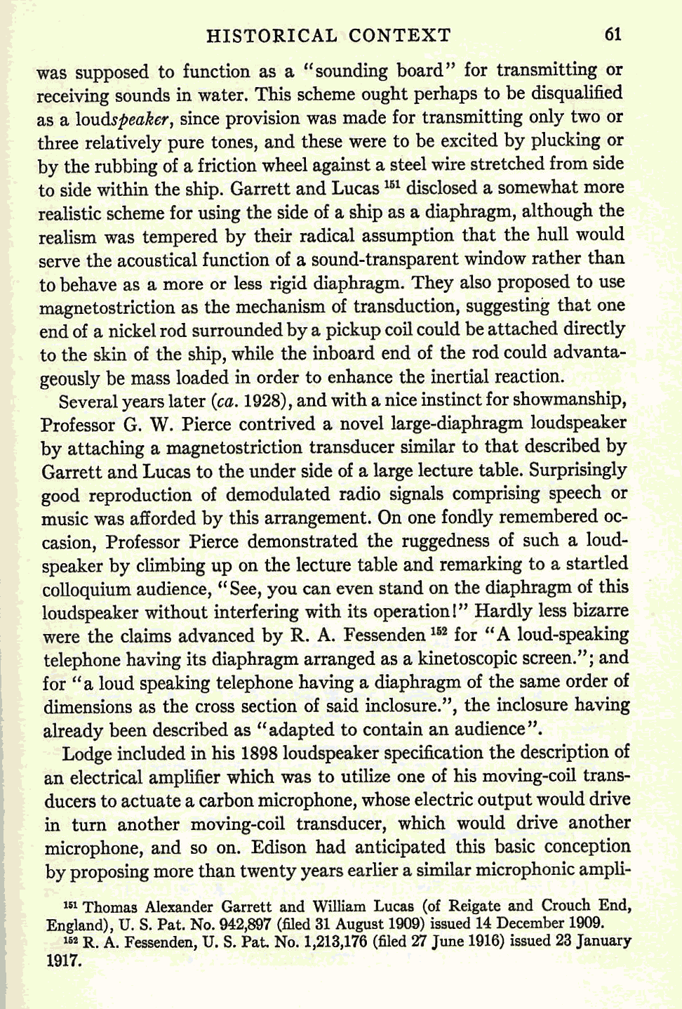

> the ONLY place I've read about them:
Hunt has a couple mentions on a couple of pages.
HUNT, F V, Electroacoustics, Harvard University Press, Cambridge, MA (1954)
The 1954 printing can be found on used-book sites. There is a 1980s reprint by the ASA. I found a bad PDF which is surely bootleg infringement. Harvard arranged for on-demand reprints/PDFs, not cheap, but may be worth it: it's got more action than a Shell Scott novel.

I first read of those carbon mic amplifiers here. Actually this is the ONLY place I've read about them:
Electro-Mechanical amplifiers
This is it! This is the concept I had in mind. From the aforementioned article. I would think that a simple plunger sliding against a resistance coil would do the trick. Might last longer as well.
"Mere lack of resource has never blocked human ingenuity, and there was a handy fact to exploit. Carbon microphones, as used universally in telephones until the mid-1960's, are not mere transducers that turn sound power into electrical power, but actually give a power gain of about a hundred times. The microphone is a variable resistance, made up of fine carbon granules, that controls the flow of current from a DC power supply; it does not merely convert acoustic energy into electricity. This power-amplification technology was the essential basis of the first practical telephone systems."
