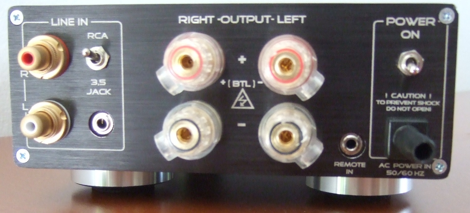

If you do not need complex CNC machining, many Copy/Print/Marketing shops offer laser jobs and can nicely sign a standard black anodized face/backplate by laser. That was my procedure: I created the design in vector PDF, put the file on USB flash and went to the shop. The result is resistant to any wear and looks absolutely professional. Cost about 10€ for the laser signing, drilled and completed by myself.
