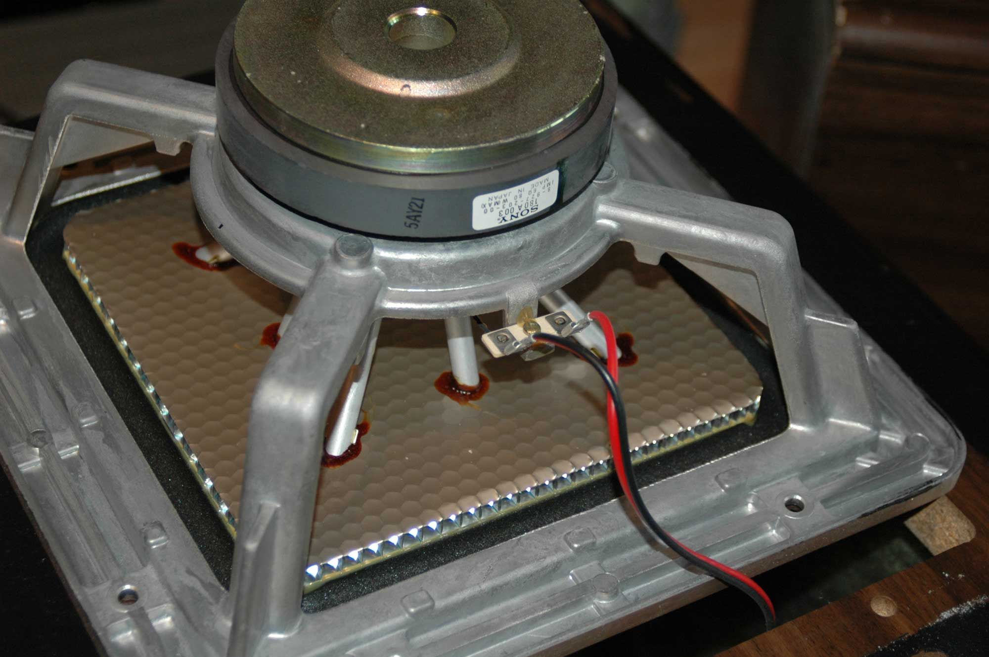

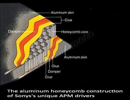

Sony's APM (Accurate Pistonic Motion) woofers also featured a honeycomb core sandwiched beween two thin aluminium skins.

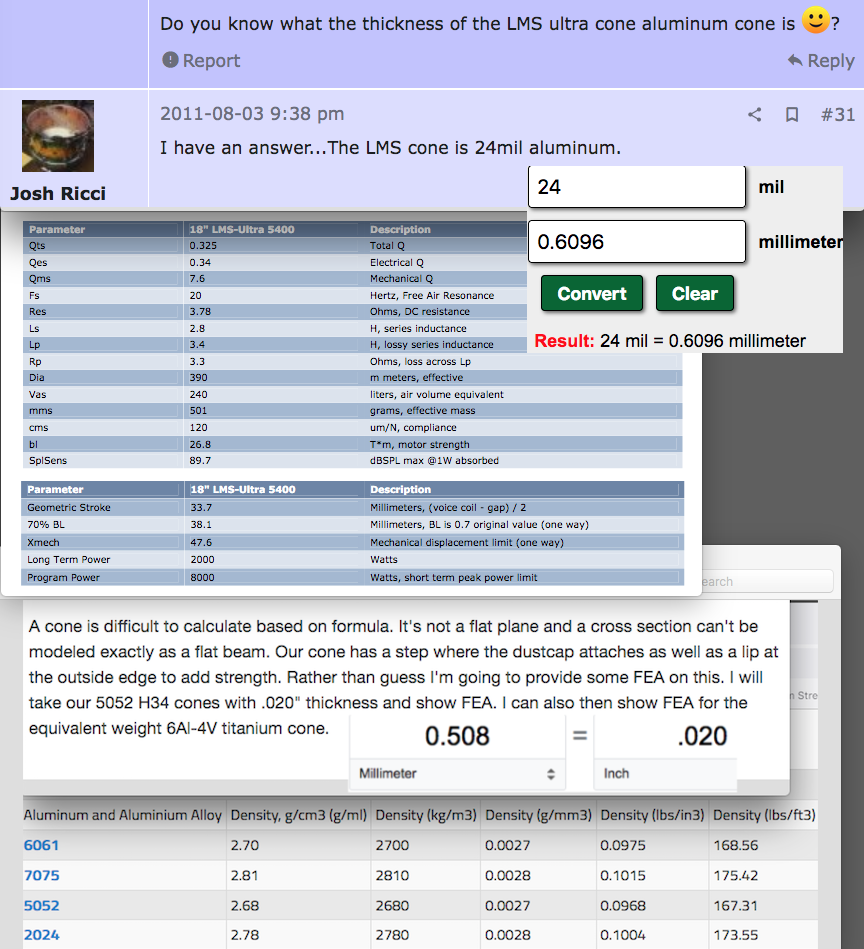

18" aluminum cone woofers are around .5-.6mm thick, some aluminum passive radiators around 1mm, though weight is an advantage with them.

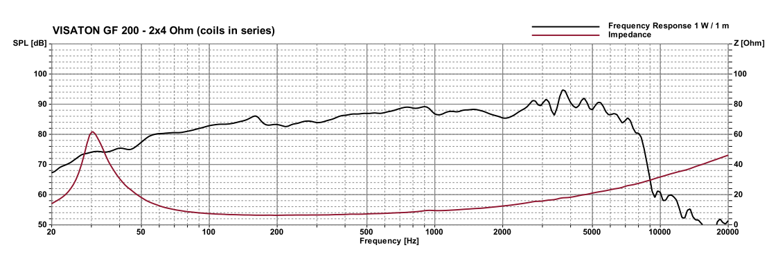

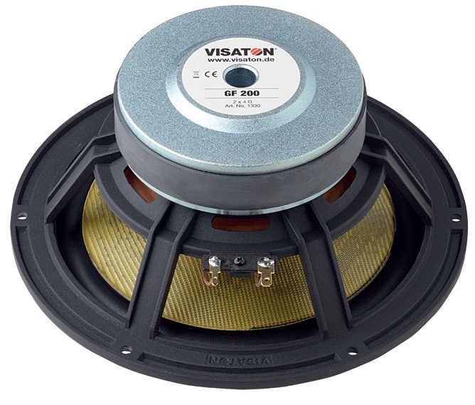

From what I've seen glass/kevlar cones tend to get their first frequency kink or breakup peaks lower in frequency than aluminum or paper. This often has a benign or even musical sound, tending to emphasize melody fundamentals, but if you manage to get the treble and mids balanced it becomes evident as a problem and is more difficult to correct. In this sense paper or poly cones are nice in that you can apply damping compound to the surround to correct the problem, but it is difficult or impossible to adequately damp a heavier cone material like glass or aluminum.
The GF-200 woofer shows this problem quite clearly at 900Hz if you overlook the vast vertical scale (THANKS Visaton, no really, thanks for deceiving us with squashed driver charts, I'm SURE we couldn't spend our money better elsewhere):
