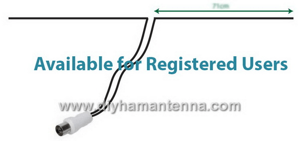

As makeshift FM antenna, is ok to use a thin wire with a length of about 75 cm.
Should I connect both Ground and Line or line is enough? As it not makes difference in gain quality when I tested.
pcan's suggestion, when connected to Line only, is sufficient in an area with good signal strength.
Alternatively, you can make a dipole using twin speaker wire, each horizontal branch 75 cm long, one connected to Line and the other to Ground.

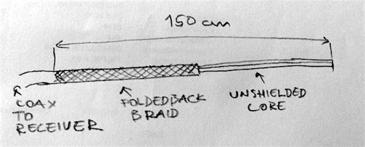

You can separate out the screen and core of coaxial cable in a similar fashion to #6 above in order to form a dipole aerial.
It may work better if you are locating the dipole some distance away from your receiver.

The FM band is about 100MHz, ie 3 meters so a 1/4 wave is 75cm. A single dipole configuration gives an impedance of 73 Ohms, a good match for 75 Ohm coax.

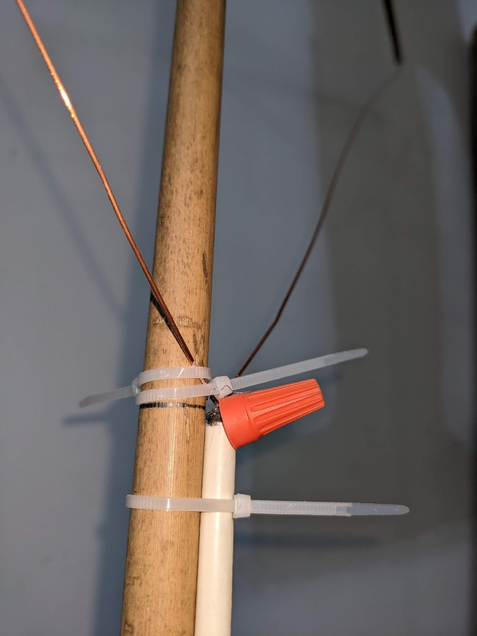

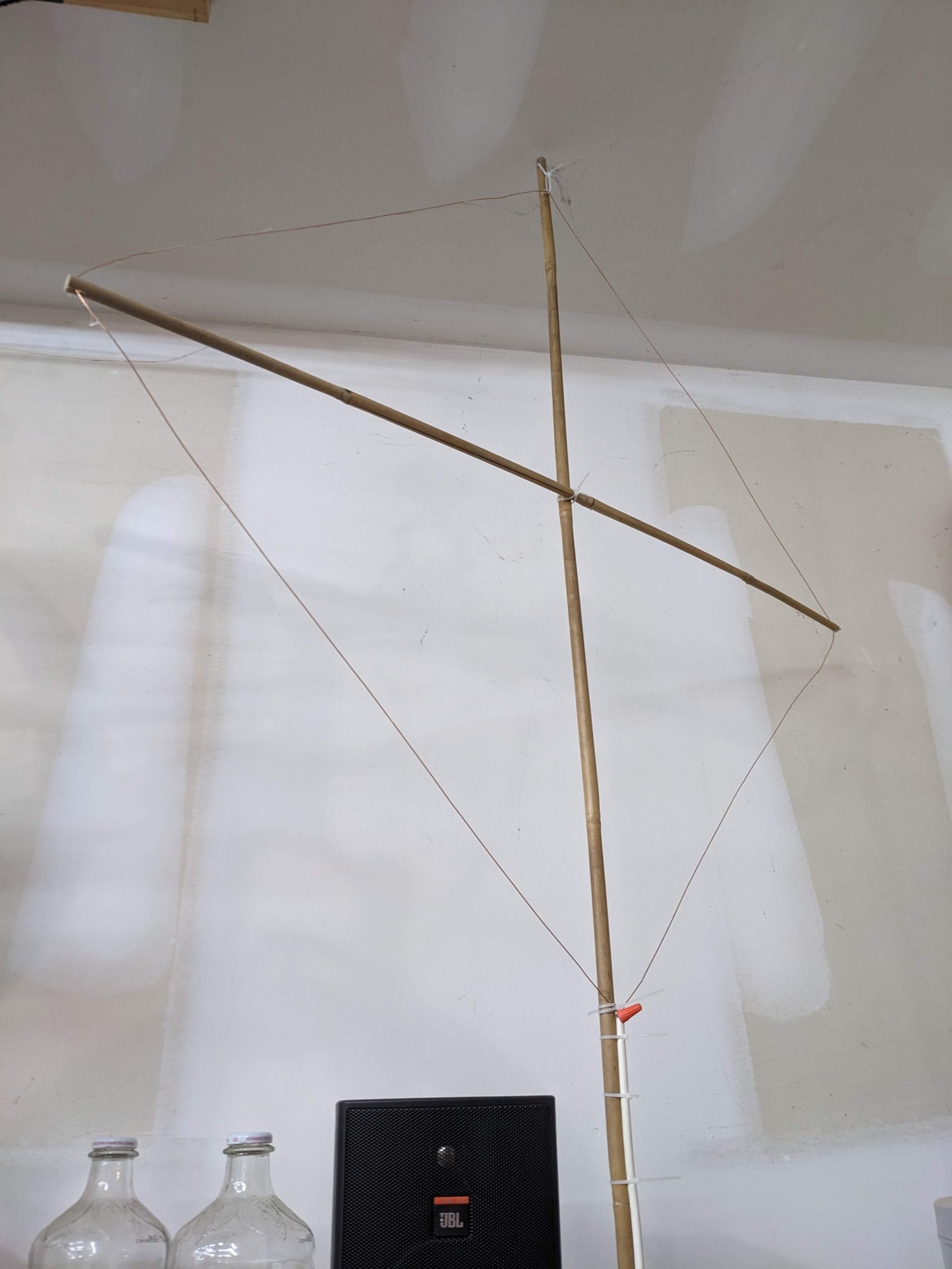

If you are in a poor FM reception spot, here is an alternative. I am not a ham or radio guy so I can't say it works better or worse than a dipole, I think it's just easier to relocate and [aim] or orient. Maybe it would be useful to get the bearing right for your preferred station, then figure out how to mount the dipole.

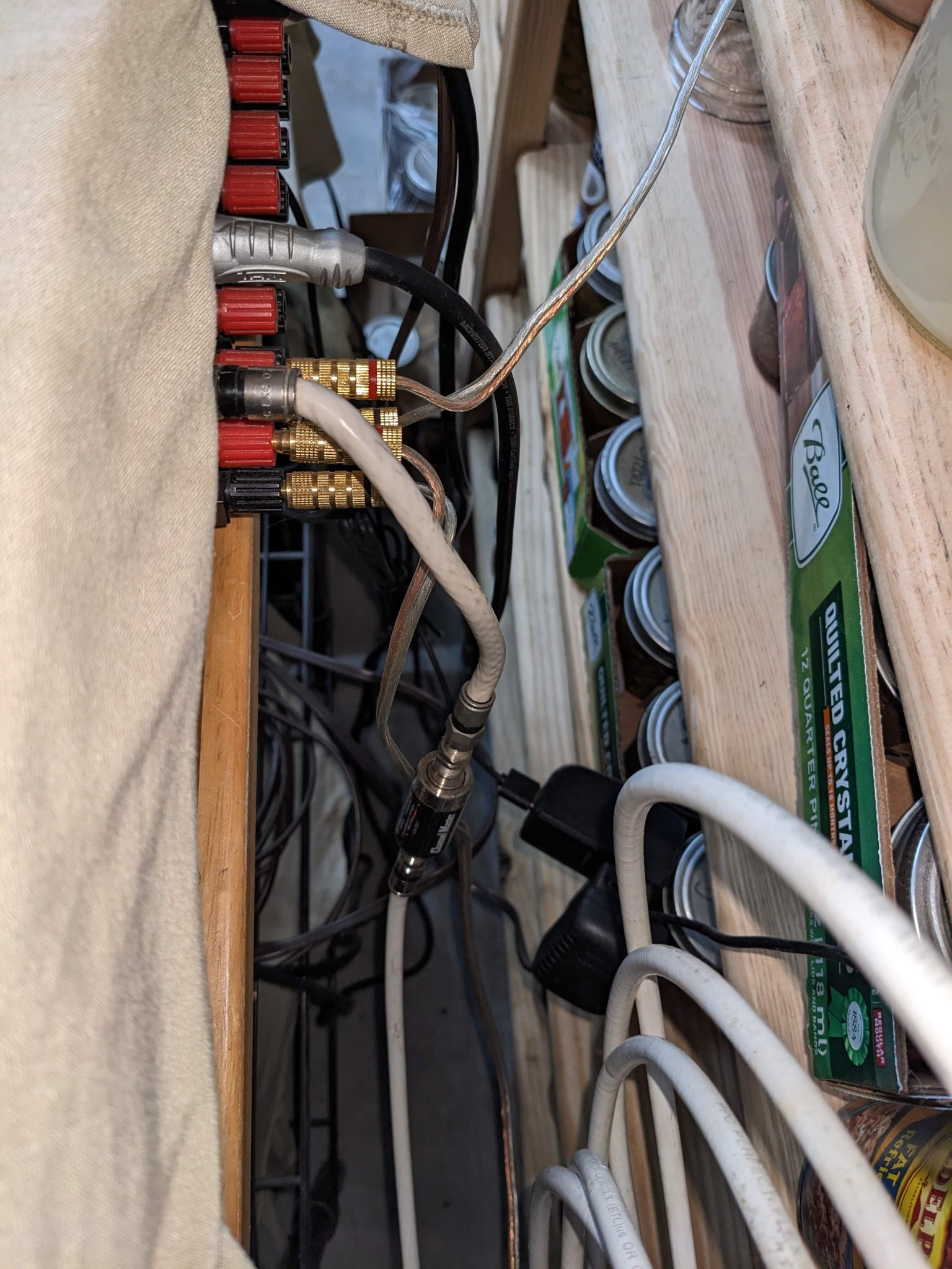

The dongle at the back of the receiver isn't required, I have added a LTE blocker because I am close to cell towers here.
I forgot to take a closeup of the top tension adjuster, but that's just two zip ties - one in the slot and one on the wire.
And the orientation of which corner is on top apparently matters for some stations (circular vs horizontal vs vertical polarization, but I couldn't explain it).
Here are some instructions. Not sure if this is the site I originally found, you can hunt around for a "full loop FM antenna" if it's not clear.
https://mikestechblog.com/build-an-indoor-fm-antenna-with-these-plans/
