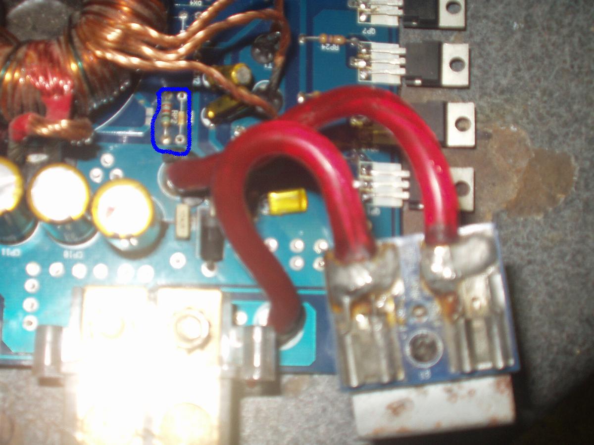

Ok I replaced the power supply fets with the originals. Also replaced the drivers and gate resistors And a couple caps and a few other resistors in the supply.
If i try to power the amp up no light come on but i can hear the relay kick on.
Amp has 1.0 volts on leg 1 of the power supply fet and 13.5 on middle leg.
AMp does not produce rail or regulated voltage.
Wondering where i go from here?
Ok i dont get this amp.
In the Pics there is a spot for a 47 ohm resistor right now i have it removed.
As soon as i apply power and ground no remote the resistor smokes within 1 sec
I pulled the driver boards for the power supply and it still smokes within a sec.
1 side of the resistor connects to a 47 uf 25 volts cap
the other side connects first to the 22 ohms resistor in the pic then goes to a diode which tests fine then goes to the relay.
If i measure across tthe pads of the 477 ohm resistor i get 13.92 volts on the pads.
Wondering what might cause this resistor to smoke within 1 sec?
Duh
Heres the pics

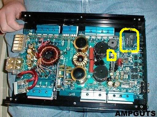

Didnt notice it til now someone at one point removed the caps from the class D board.
Anyone know what value caps theese are?? the ones circled they are white
Also anyone know what relay goes in this amp since the cover to the one that in it is missing?
