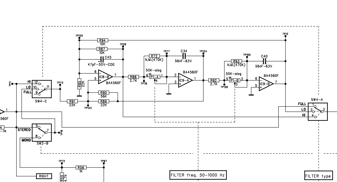

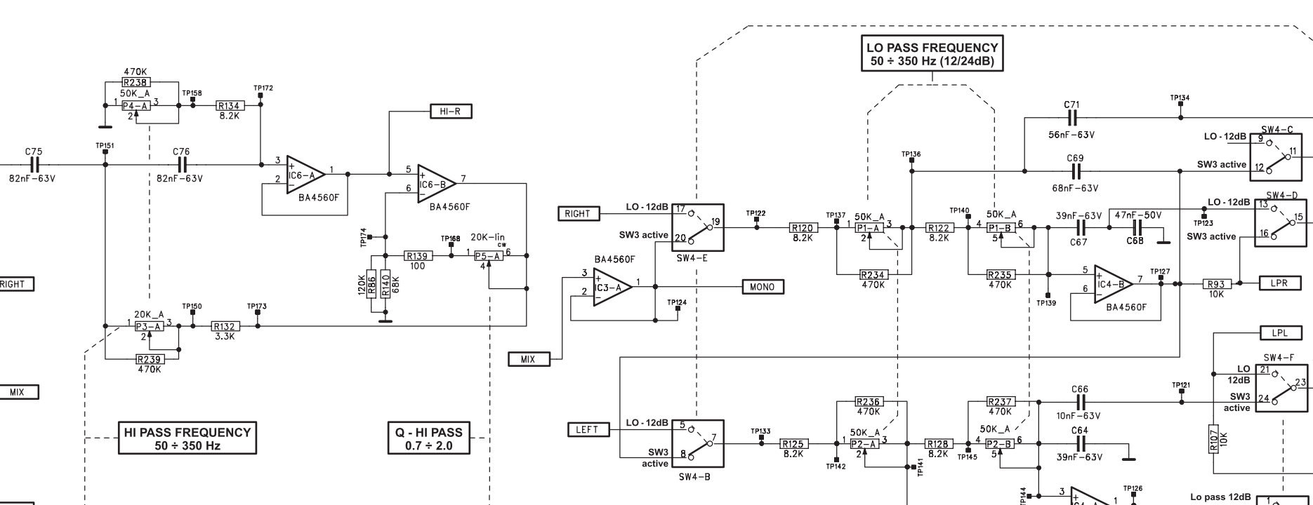

Is this the sallen key circuit or the state variable circuit circuit (compare to attached)?

I'd say it mostly resembles the state variable variant, as there is no way to set Q or filter steepness on these. I know Audison added more complicated filters for the SRX1-3 channel variants, to allow for better incorporation of subwoofers, but the 4ch variant I have only offers 12dB variable frequency. And knowing that, I came to the unsurprising conclusion of being bit of a dummy here - a 12db Filter will always use 2 caps per channel, so to filter 4 channels with 12dB, one definitely needs 8 caps - so I strongly suppose the 82nF bank is also involved.
Hmm interesting - correct me if I misunderstand this, but from my practical measure-ability, assuming the sallen key filter, the caps within a filter block (like C75/C76 on the sallenkey schematics) should show a direct connection; for the state variable filter like C34 and C40 on the state variable schematics, there is definitely a kohm resistance between them.
On my board, I find a direct connection between pairs of 82nF caps and a noticable resistance between all the 56nF caps - so I guess they used both architectures there, the 82nF being used in the channels 1+2 HP as sallen key, and the 56nF use state variable for the switchable LP/HP for Ch 3+4... At any rate, the replacements capacities should be the same (1/25 the original capacity to generate 25x the original cutoff frequency), right?

Yes, if anyone had the actual precise schematics for that amp available that would of course help - but I already have to thank you for the SRX2-ones, I think they cleared it up for me fairly well, especially since even the cap values match what I have on my board, and on further test I found a direct connection between opamp inverting input (pin 2), a 56nF cap and the variable resistor -> state variable, while the 82nF caps connect to non-inverting opamp input pin3 -> sallen key.
I found a calculator for Sallen-Key-Highpass-Filters [link], which seems to generate exactly the frequency change of f ~1/C assuming the resistors are kept constant, and for the state variable (which is the same as the already mentioned ESP Project 148 [link]) I had that relationship of f ~ 1/(R*C) in mind all along.
