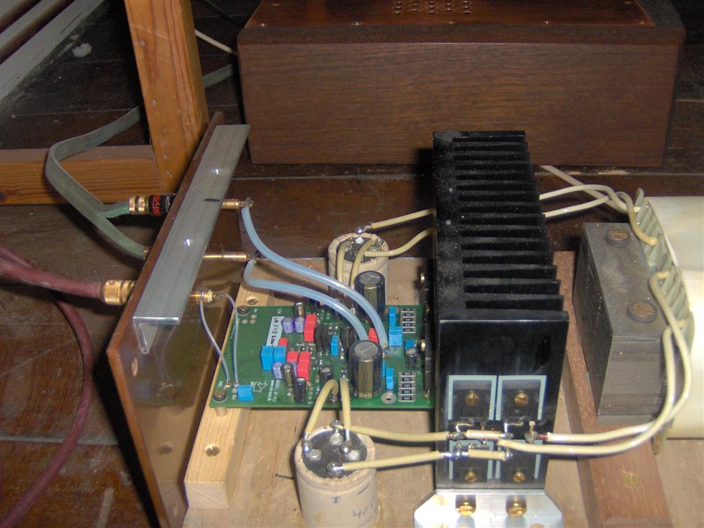

Surpricingly, my "small" 40watt monos driving his Kappa9 sounded better
It was loud enough, but ofcourse not with the exstreme power of Nakamichi
But my monos sounded more fluend, more easy going
The really strange thing is that they only have one single pair output devices
And just one single pair of Jensen 4-pole supply caps
My conclusion wtih Kappa9 is that they improve a lot from very fine sounding amps
Its simply not enough to just be tough
If you can afford them, I think some of Anthony Holtons bigger modules running on lower voltage should manage
HUGE "classA" heatsinks and MONSTER power supply needed
I will estimate cost to be around 2000USD minimum
btw, amp boards are MIRAND, designed by Sonny
sorry for the dust, renovating house
but it shows that the convection cooling works
