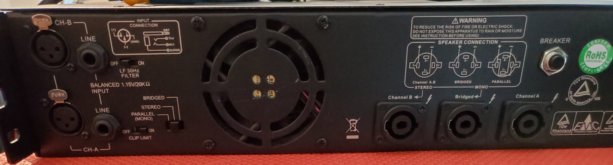

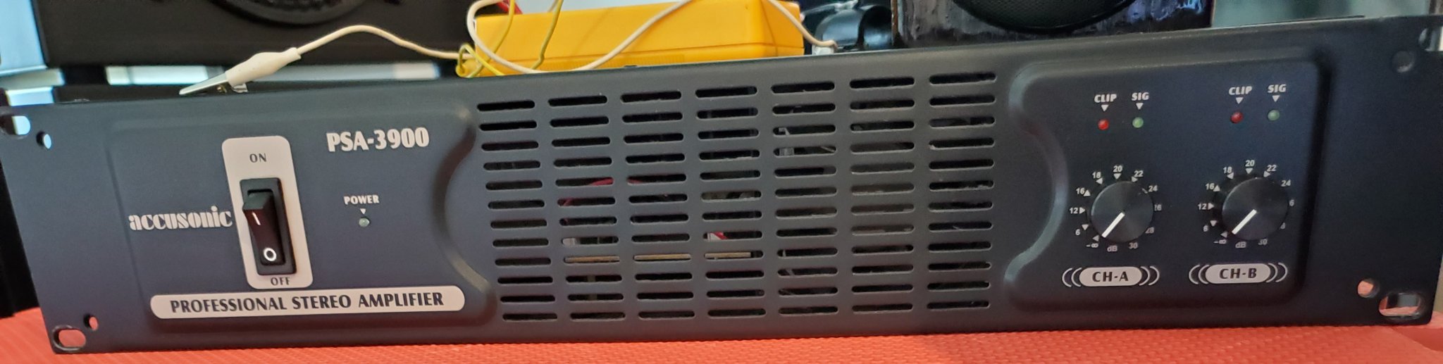

I've got 4 Accusonic/Show amps (2 x PSA-3900, 2 x PSA-31500), all four of them were working in all modes (stereo, bridged, parallel/mono). The following day I was testing them out and all of a sudden all four amps only work in bridged mode but not stereo mode or parallel/mono mode. Has anyone ever seen or heard of this before? I'm testing each one on their own so it shouldn't be a power supply/voltage drop issue. The only thing the four of them had in common is that they were all plugged into the same power bar running through a DBX drive rack PA2. So I tried them individually on a different power bar and a different outlet with a direct signal to each amp, bypassing the DRPA2 and still have the same issue. What would cause 4 individual amps to all lose stereo mode at the same time? I have verified the following during my trouble shooting:
pics of front and back attached.
Thanks in advance for any insight or trouble shooting suggestions. I feel like there is a very simple and obvious answer to this but I'm not sure what I'm missing.
- speaker is working: used mutiple working speakers with no luck
- speakon cable is working: wired correctly to pins 1+/1-
- signal is working: balanced signal being sent
- power supply is working: breaker has been reset
- breakers on all amps are all reset
- clip limit is on but i've tried it off as well with no luck
- 30hz filter is off but i've tried it on as well with no luck
- bridged mode: signal showing on both channels when channel A pot is used, as designed. sound is being sent to bridged output channel.
- stereo mode: Signal is showing on both channels A and B. sound is not being sent to output channels A or B.
- parallel(mono) mode: Signal is showing on channel A as designed. sound is not being sent to output channels A or B.
SOmething outside the amps. Something about your signal source or connection scheme perhaps.
That was my first thought which is why i isolated it back to basics. A single channel signal out from my mixer directly into a single amp using a single cable into a single speaker. no other amps are connected yet they all behave the same way when i test them individually.SOmething outside the amps. Something about your signal source or connection scheme perhaps.
yes, correct. the amp sends signal to +1 +2 bridged. Stereo is supposed to use +-1. I have verified that the cables are wired +-1 so they should work in stereo but they don't. they only work in bridged while wired +-1. I tried to rewire the cable in +1+2 but then it didn't work in bridged when it should have. how would that be?Speakons are wired for bridge +1 +2. Stereo or Parallel use +-1
The confusing part is that the whole system worked the day before with the same cables, same amps, same speakers, and same signal. The very next day all four amps had the same issue and nothing changed.

Check continuity on the speakons / cables. Look at the backside of the amp females. Connectors could be bad or perhaps a dirty Stereo / Bridge switch
Thanks for the tips. I checked continuity on the cables several times and used multiple known working cables to eliminate that variable. Connectors could be dirty but I think its statistically impossible for all 4 amps to malfunction simultaneously and resolve itself simultaneously if the female terminals were bad. The stereo bridge switch could be faulty but again wouldn't explain the simultaneous malfunction and resolution of all 4 amps. Has to be voltage related since it's the only thing the 4 amps share when they malfunction together.Check continuity on the speakons / cables. Look at the backside of the amp females. Connectors could be bad or perhaps a dirty Stereo / Bridge switch
When you test these amps, are you feeding it from a mixer in stereo? Try feeding only ONE side at a time. DOes the side making no sound now work? Likewise, take a signal and feed it to both left and right inputs with a Y-cord. I am not yet convinced it isn't a signal source problem. As you say, there is no mechanism for all four amps having the exact same trouble at the exact same time.
Initially when i first discovered the problem it was running stereo inputs but in order to trouble shoot, I tested each channel of each amp individually with a single cable and single balanced line signal. Channel A nor B worked in stereo mode but oddly the bridged output worked with a 1+1- pinned cable and should not have. This would indicate some kind of pin short at the bridged output since both 1- and 2- should have been dead. But after it resolved it self randomly, channel output A and B both worked again. like you said there is no mechanism across 4 individual amps being tested separately to produce identical malfunctions at the same time and then reverse itself. It has to be a wall voltage issue or something common, maybe a ground loop issue/lifted ground issue or something.When you test these amps, are you feeding it from a mixer in stereo? Try feeding only ONE side at a time. DOes the side making no sound now work? Likewise, take a signal and feed it to both left and right inputs with a Y-cord. I am not yet convinced it isn't a signal source problem. As you say, there is no mechanism for all four amps having the exact same trouble at the exact same time.
If you use some other amp in bridge mode, you might find both channels are working, they are just out of phase with each other. SO if one side is dead, the other side is still going, so a #1 cord would still work on that channel. A wise man said, "When you see hoofprints in the dirt, think horses, not zebras. (Or maybe when you hear hoofbeats...doesn't matter) I think it would take a serious wall voltage problem to do this selectively. And ground loops more likely to make it hummy.
Looking at your rear panel, I don't see the other two pins as being dead, I just see them as unused. The bridge connector tells you to use the two particular terminals.

In bridge mode, an amplifier used both channels together, so only one input can be used. SO we have to pick one input, it feeds a channel, and then a reverse phase version of the signal is fed to the other channel. That leaves nothing for the other input to do. If you have one side of a stereo signal connected to that input, it just goes no further. The amp is not a mixer, so if you feed the amp stereo but have it in bridge mode, ony one side of the audio gets amplified. You cannot play stereo through a bridged amp.

This might help, this modern amp has internally wired connectors especially for bridge. In the old days, to bridge an amp, you made a special cord and used the banana jacks. You connected channel A plus to the speaker terminal and channel B plus to the other speaker terminal. The ground terminals of both channels remain unused.

That is exactly what the pin diagram shows is happening with bridged mode. 1+ and 2+ are being used for bridged mode and according to the block diagram that appears to be the case with this amp.This might help, this modern amp has internally wired connectors especially for bridge. In the old days, to bridge an amp, you made a special cord and used the banana jacks. You connected channel A plus to the speaker terminal and channel B plus to the other speaker terminal. The ground terminals of both channels remain unused.
