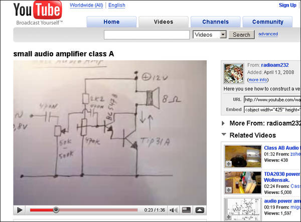

Should be noted here, that there were in past some amplifiers
that had loudspeaker as the bias component,
to feed the amplifier a small current for start up.
radioam232 Simple Class A.
This amplifier defintely will have some dc-offset!
Now, he is only using very small Class A current. And it works.
As can be seen from his videos.
He has got 203 youtube videos - most related to electronics 🙂
small audio amplifier class A
http://www.youtube.com/watch?v=waK38uzRgBw
small audio amplifier class A tested
http://www.youtube.com/watch?v=TfpOIH7k7lQ
