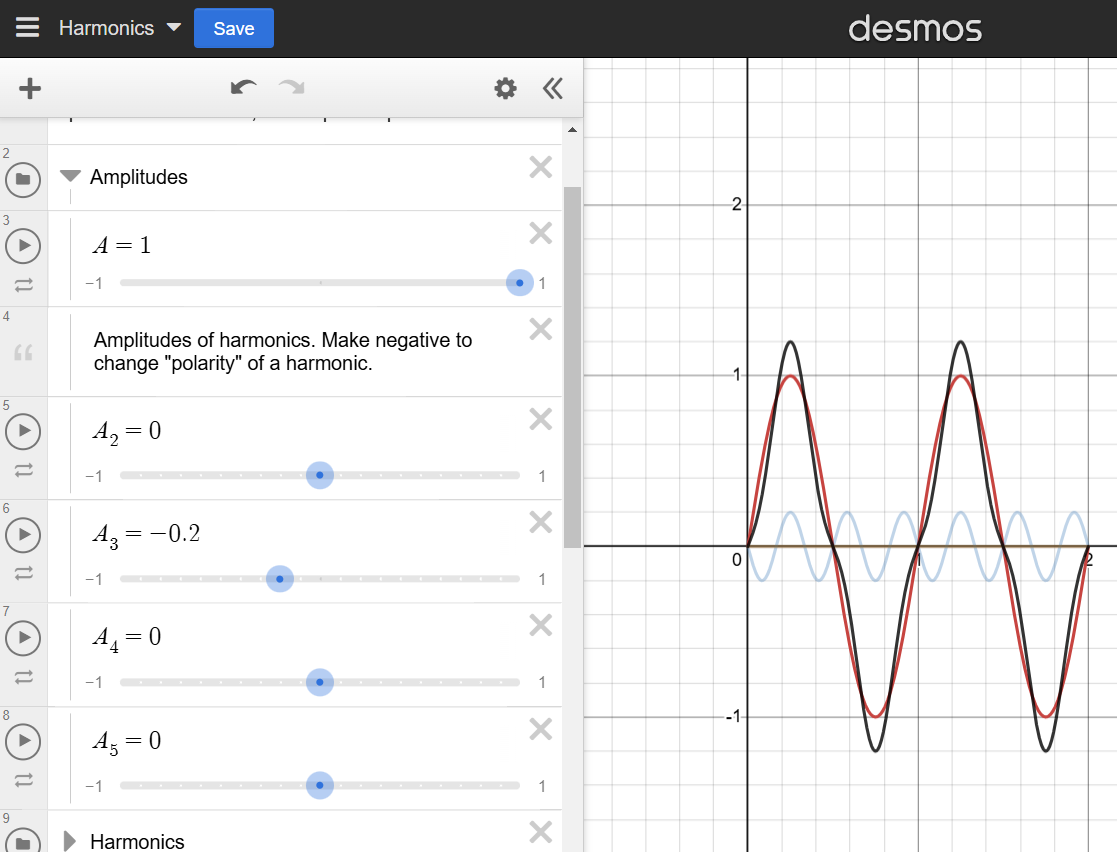

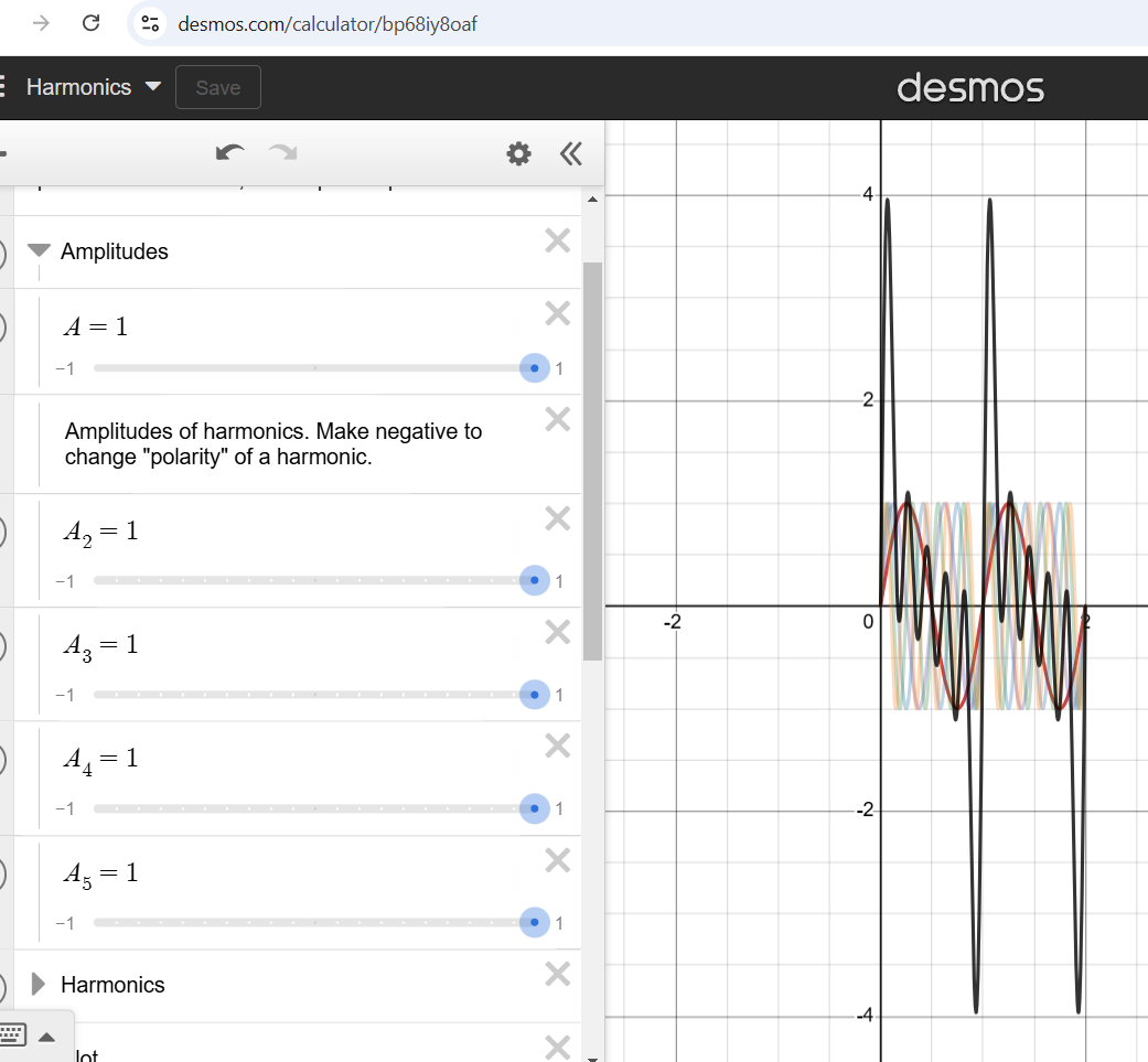

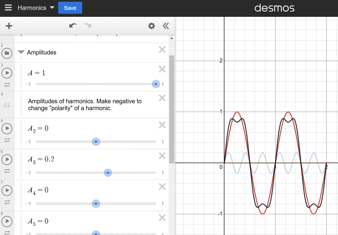

Here, extremely simple demonstration and fun tool to play with 😀 https://www.desmos.com/calculator/cwwofvwsqk
It's merely simple plot of some fundamental frequency and four harmonics whose amplitude / phase you can play with and try and mix/match them to get highest possible combined amplitude peak.
Cycle length is set to 1 and amplitude 1, the display plots two fundamental cycles. As you see, when the harmonics are added to the fundamental they together superimpose and every fundamental cycle make huge amplitude peak up to 4. If you start making amplitudes of the harmonics to zero all that is left is the fundamental with amplitude of 1.
Now, if you set the fundamental to 1 and all harmonics to zero, and start adding any of the harmonics the superposition amplitude goes up or down. Even order harmonics always boost the amplitude, while odd harmonics in positive phase compress!
What this means, that if auditory system considers this original sound harmonics lining up every fundamental cycle to determine whether to pay attention to it or not, iow determines how you perceive the sound, then this is critical stuff. Original harmonics means that every instrument, except sine wave generator, sound consists of fundamental tone and overtones, the harmonics, basic stuff right. What the test here kind of indicates, that if the fundamental cycle here is any of those original harmonics of original sound, certain added harmonics will boost them, while others would reduce them. This means to me, that it's possible that particular amplifier harmonics signature will help brain to detect sounds from each other on a recording, or just more broadly whether brain pays attention to sound of the recording or not. What the playback equipment can do is add noise to the room (unrelated to sound, like distortion, or excessive reflections), which reduces this SNR, could also delay some of them like group delay in loudspeakers reducing the superposition amplitude, while it also could help by amplifying harmonics. At least this is how I think it could work out.
Same thing happens just by changing listening distance, which changes ratio of direct and reflected sound, where the reflections reduce SNR like so and brain doesn't pay attention to your stereo sound unless you get close enough to speakers so that the sounds on the recording have sufficient SNR over the "noise", all sounds in the room bombarding the ear, so that your brain locks in to the direct sound. This means there is particular listening distance where your brain switches state: if you are closer to speakers than this distance, your brain pays attention to sound and you get very nice perception of what is on the recording. If you take step further from the transition your brain loses the attention and all you perceive is "noise" basically, the sound of recording fused as one with all noises in your room, clarity and localization reduces and so on. It's just very different perception of hifi stereo either side of the transition depending whether your brain pays involuntary attention to the music or not 😉 This is the Griesinger Limit of Localization Distance.
I speculate the transition is available with any speakers in any room, actually any sound source in any space, because this is property of our own auditory system, and not property of speakers or the room. Listening test to find it is relatively easy, I've found easiest just to play mono noise, like pink noise, for maximally strong dry phantom center image. Then move yourself back and forth on center line between speakers staying equidistant to both trying to listen where perception of the phantom center changes. Eyes closed listen "size" of the noise, when you think it gets focus, shrinks to very small you have it. Contrary, when you are further away, brain not paying attention, the phantom center is hazy spacious blob somewhere in the room where the speakers are. If you don't get these differences to appear, try toe-in the speakers and bring them closer and try again. You'd always have the hazy sound otherside of the room, and should always have the focus when you are very close to speaekers. Trick is try to notice where, at which listening distance, the perception between the two seems to change. I speculate that with typical speakers in reflective room this distance can be quite close, while on some high directivity speakers and managed acoustics it is further away. As a reference, I have relatively high directivity system with waveguide tweeter and cardioid mid in a typical family living room and the transition is about 2.2m from speaker to ear. Yours could be closer or farther. Now, if you want to listen your amplifier effect on music and to stereo image, find the transition and move yourself both sides of it to AB test stereo image, indirectly control your own auditory system to toggle stereo image by moving a little 😉
Drawing from the same phenomenon, you likely hear not much difference between two good amplifiers if you listen too far, because room early refections ruin the information anyway and makes your brain not listen. So, find the transition to make sure your brain pays attention, and then listen for the small differenses like swapping a good amp to another good amp.
