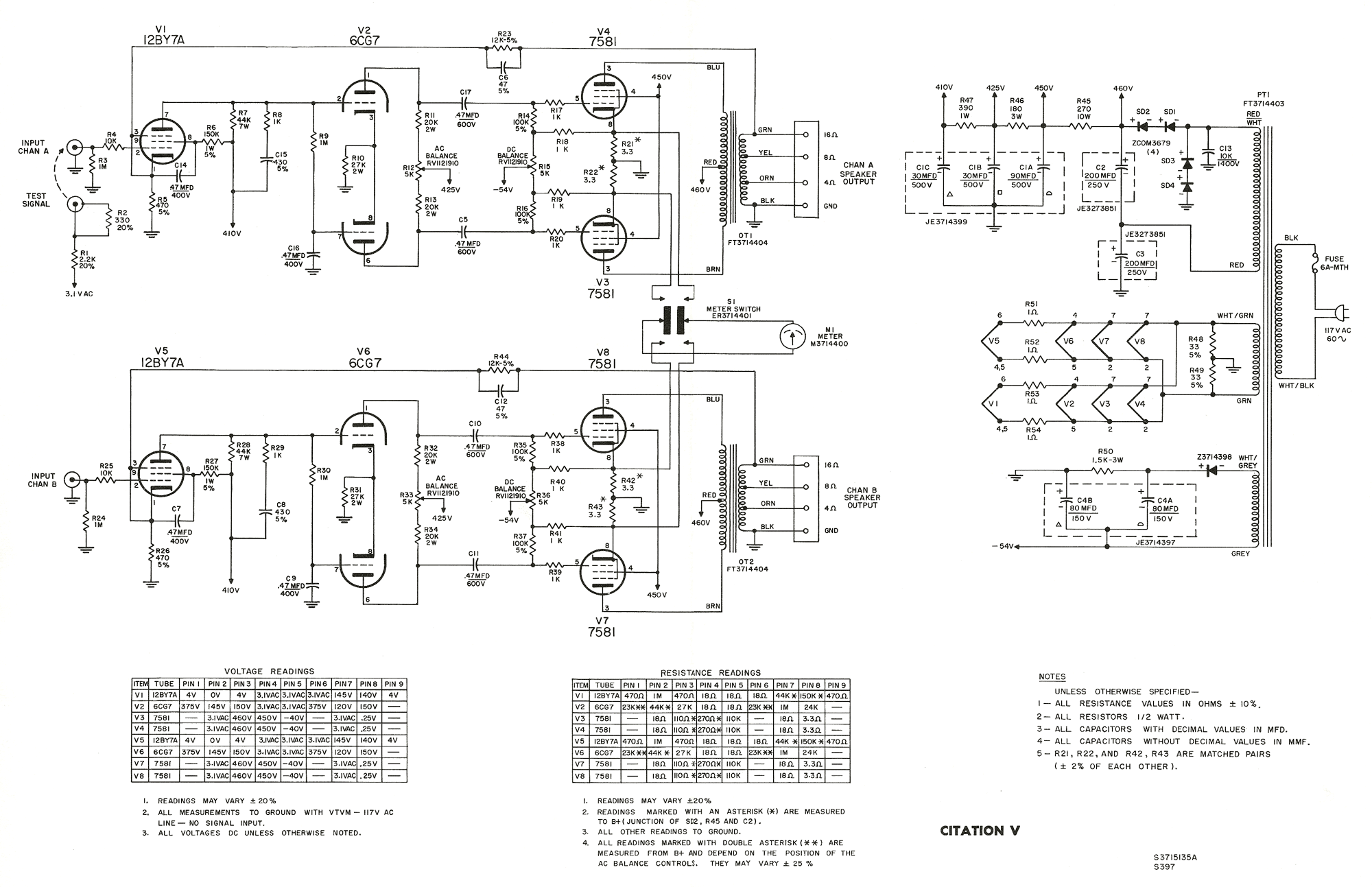

Darned tootin' push/pull is they way to go, less bankruptcy set in. IMO, using the Harman-Kardon Citation V (a superior Mullard style topology implementation), with 6L6GC O/P tubes, is a good place to start the project.

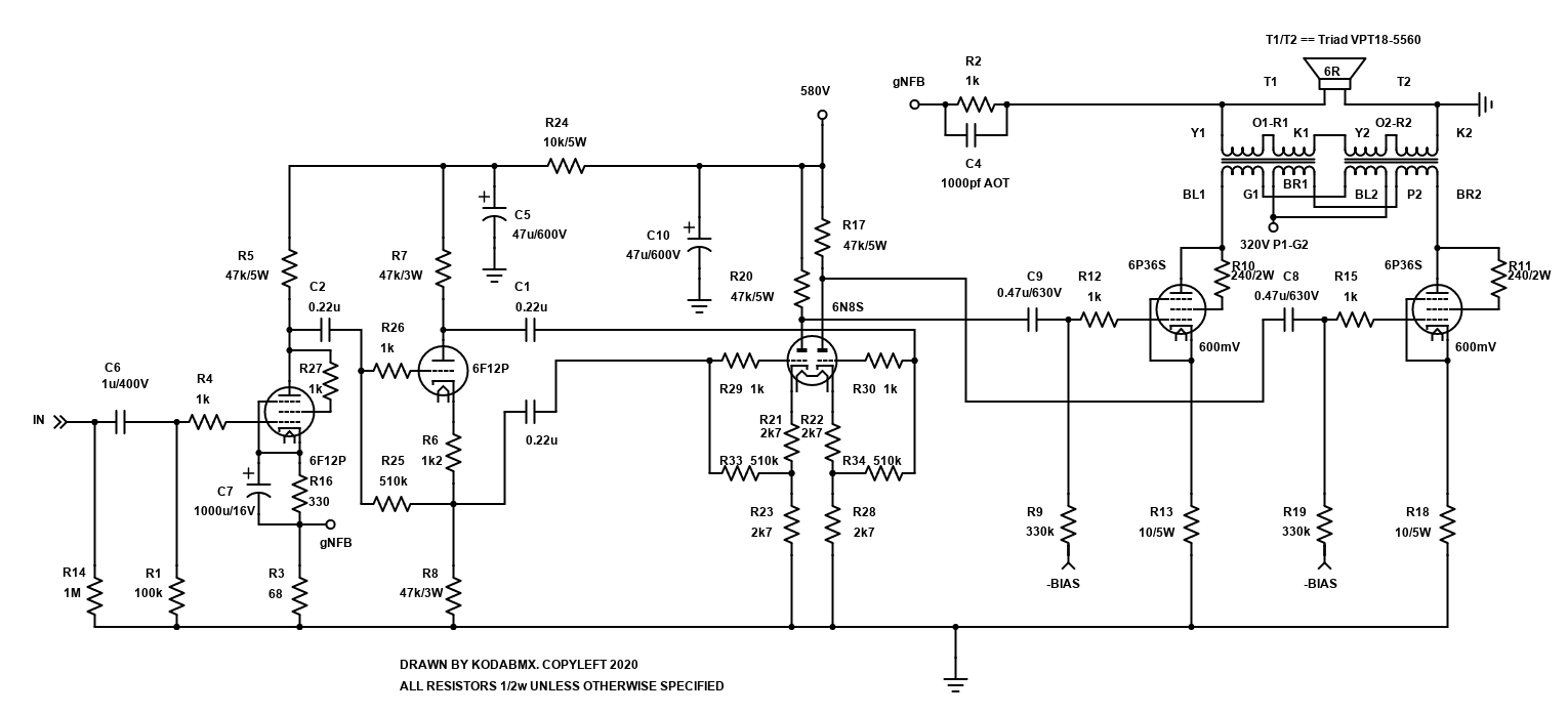

This is an example of my Williamson-esque design using 6P 36S tubes for output. It will deliver ~50W of triode power. I have circuit boards for the VA/PI/Driver and boards for 6P 36S, 6P 45S, and 6P 31S (or 6BQ6, 6L6, EL34, KT***) are on the way.

Unlike Eli, I prefer Williamson topologies
Williamson style is fine, but it is very vulnerable to low frequency instability and costly, low phase shift, O/P "iron" seems "required". OTOH, Mullard style is somewhat forgiving of limited O/P "iron" quality and is comparatively "idiot resistant".
Careful execution of either Mullard or Williamson style topologies gets you excellent results. Both are "classic" for very good reasons.
A very good point. In my case the very good iron comes in the form of of the shelf power transformers 😀
