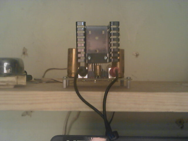

I like listening as soft to moderate levels most of the time.
Measuring with a (probably not highly accurate) iPhone app SPL meter, from where I sit at 2 meters from speakers, if I turn it up so that peaks in music content are 75 to 80 dB, it's moderately loud to me. If I really crank it when my fav song comes on, then 80 to 83 dB peaks seem very very loud to me!
I think all of this means that I am using 1 watt most of the time, and 2 watts to 10 watts on rare occasion. Still I think there's an advantage to having more power available than what I need. The Amp is not having to work as hard. Is this called headroom?
