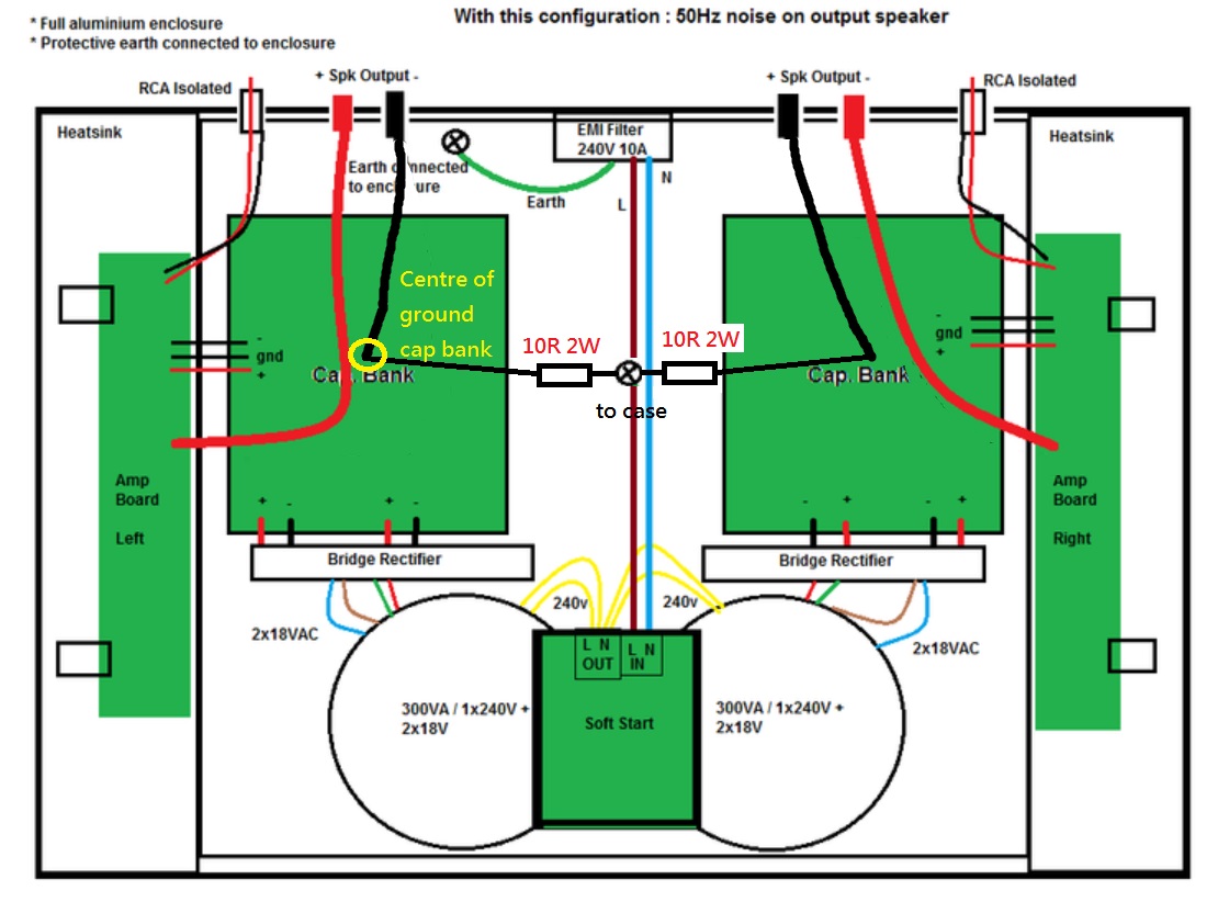

I build a new amplifier (Inspirated of F7 Amplifier /Thank you Mr PASS), but issue with it.
Noise (50Hz) on both channel when I plug the protective earth on the chassis.
Without protective earth ... Dead Silence on outputs.
After few mesurment ... Without protective earth connected, i've ~60VAC on the aluminium enclosure !
i've try to reverse 240V input plug ... same issue.
However, no electic contact between amp boards , capacitor bank , softstart , transformers, outputs or inputs AND the aluminium enclosure ... My questions :
- Why 60VAC present on my enclosure if no electric contact with other parts ?
- Why with protective earth connected i've a noise of 50hz on my speaker outputs (both channel) ?

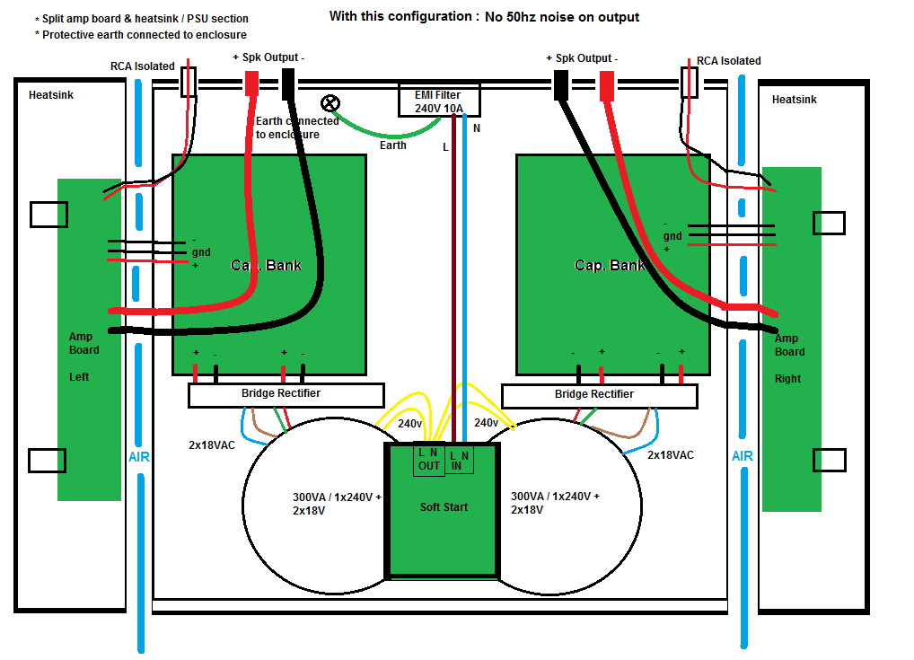

I've try to disasemble the enclosure , and split the heatsinks with amp board to the power supply section ... and it's ok ... I don't understand.
Wiring diagram and photos
Thank you in advance for your help :worship:

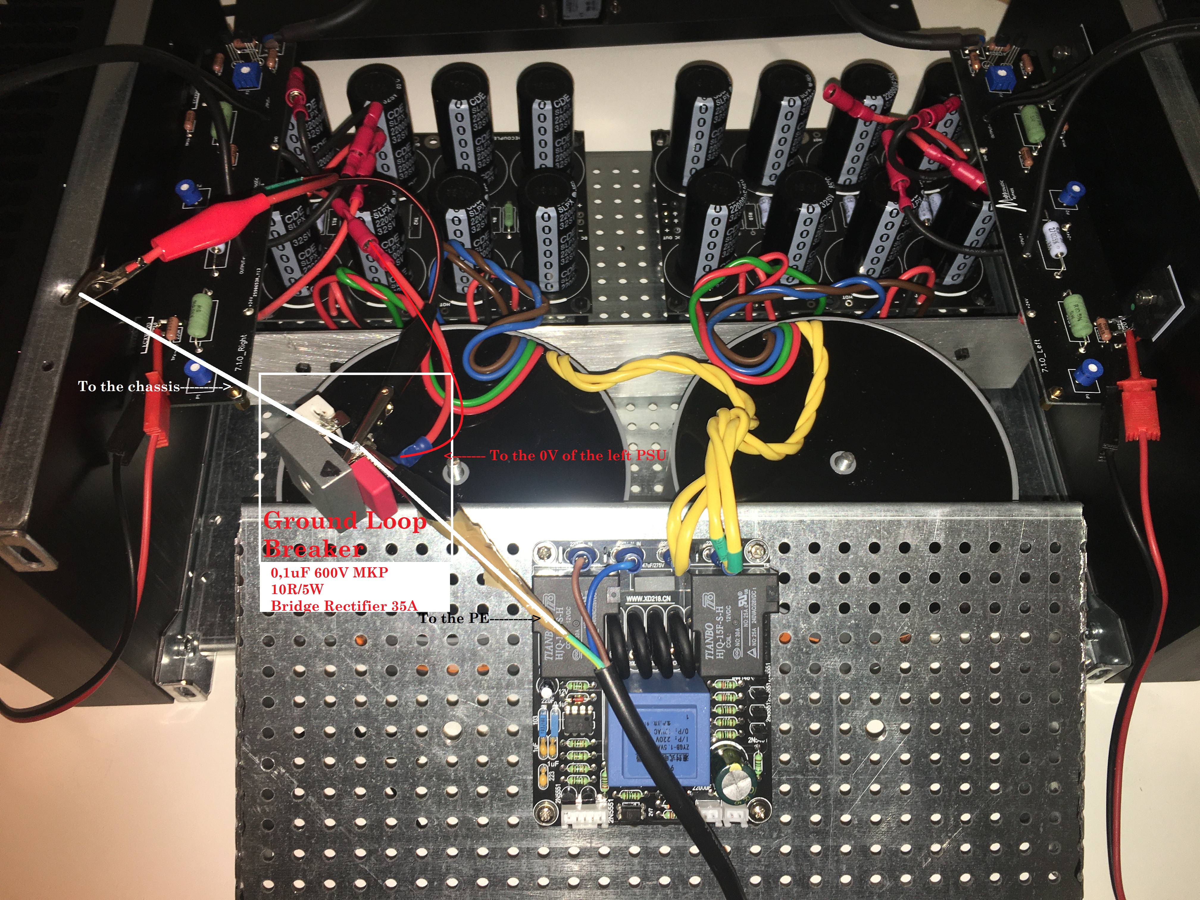

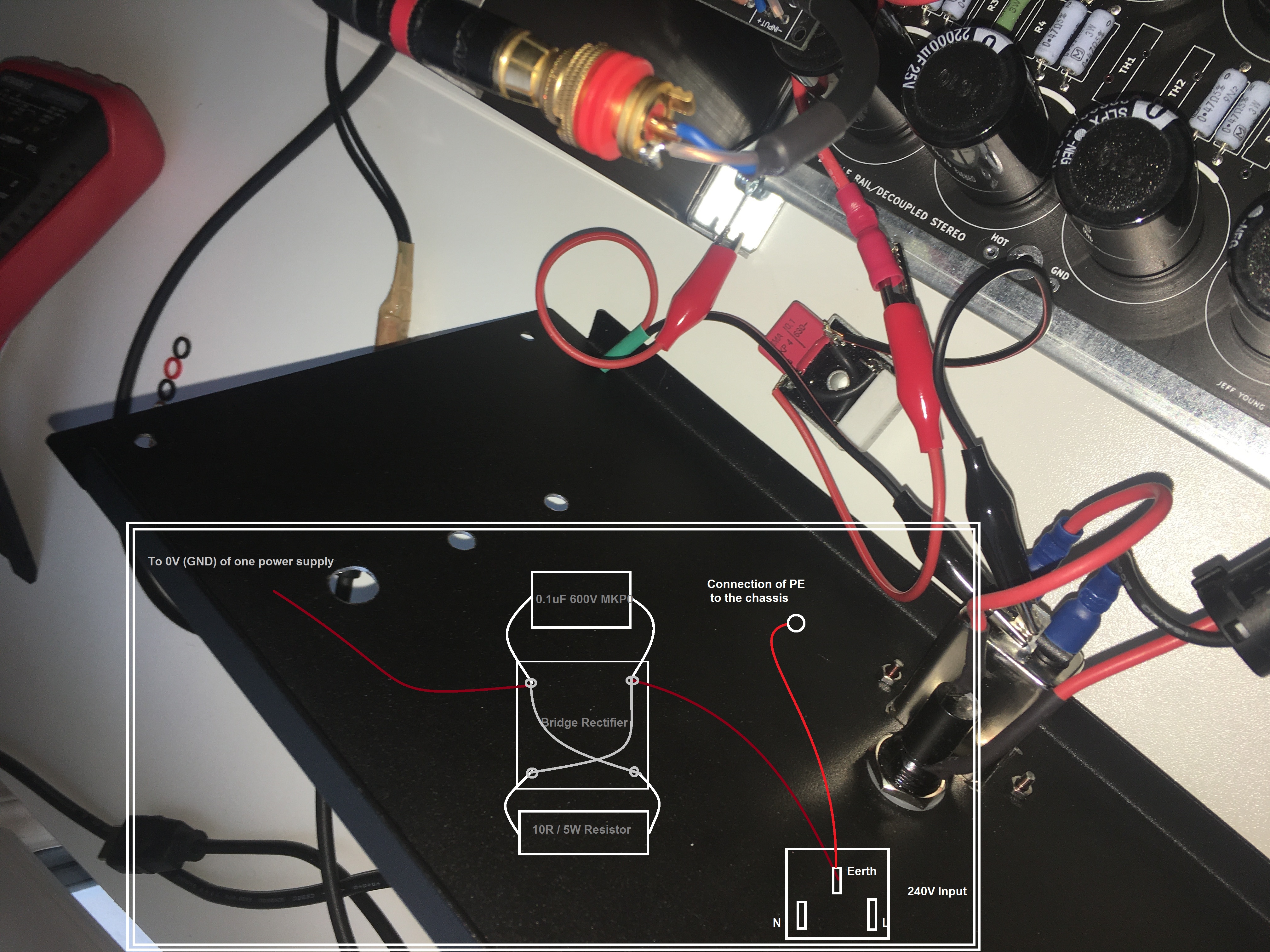

I've try to add a ground loop breaker, like this :
With this quick fix : No 60VAC on the chassis, No Humm 50Hz on my speaker output, but in my opinion, it's not a great solution ...
I am not convinced by the connection of the 0 V power supply unit to earth through this "Earth loop breaker" ...
Another possible solution according to you
It's a bit mysterious why separating the amplifiers would eliminate the hum... I can only guess capacitive coupling of the power wiring to the environment?

I don't think the mains filter is really a problem here, although these have a habit of being screwed to the chassis and establishing a PE connections like that (but obviously not so in this case). Looks like the mains filter capacitors go straight to PE, which should be present if the mains lead and outlet are OK, so their leakage currents are promptly disposed of.
patrick101's 10 ohm resistors are another variation of the "low impedance compared to this, high impedance compared to that" theme. That's another way of breaking the internal ground loop, used by a fair few amplifiers. Using diodes is another, similar trick. You can also combine both, as the ground loop breaker seen above does.
But as I said, I'd rather have the amplifier as a whole more or less floating, with only a weakish PE connection (xx nF, || 100R-1k if you insist). This will require some more care in construction of the primary side be be up to Class II standard (e.g. using a regular double-insulated mains cable internally, heatshrinking connections, keeping mains away from signal stuff etc.) but it's by no means unmanageable. You'll have less trouble with problematic sources this way.

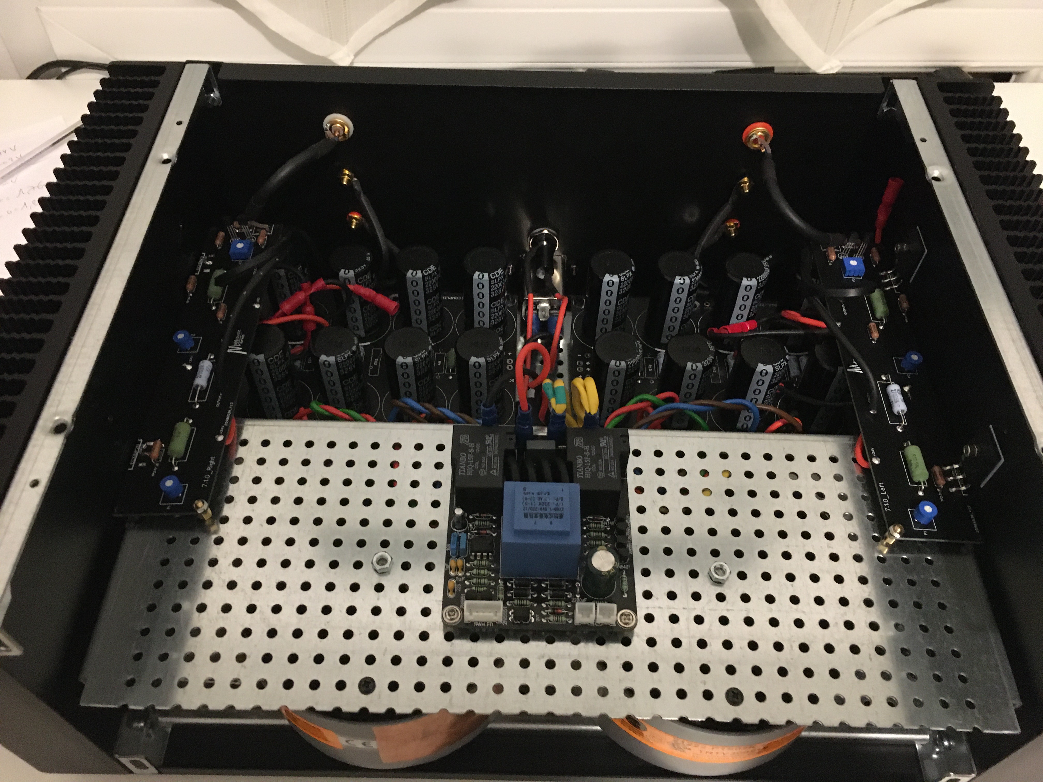

I've investigated , and try different things … without succes.
- First : I’ve try to remove RFI Filter and replace it with direct connection on the softstart board : Same problem
- Second : I removed the metal plate with softstart just over the two transformers.
Before remove this plate, i notice the center fixation of the right transformer is very hot ! And the two transformers vibrate.
After remove this metal plate : transformers stop vibrated and the centrer fixation is cold now.
But the Noise is still present on the output when PE is connected to chassis
- 3th : Adding Ground Loop Breaker like this :
Great improvment in term of noise, but the ears very near to the test speakers : 50hz is still present …

The original photos didn't show it clearly enough.
But obviously (now) you had that top plate bolted down with the transformer bolts.
This would represent a shorted turn to the transformers.
Hence the heat and mechanical buzz in the transformers.
I wouldn't be suprised if the transformers are now damaged.
They might now be generating electrical noise that is getting into the amplifier modules via the wiring.

Remove that top metal plate. Permanently.
Don't use the amplifier module circuit board mounting hole. It's a small light board and doesn't really need it.
Get a different transformer and test wire it outside the chassis.
If that fixes the speaker noise, mount the two new transformers.
Search the forums here as I've seen others with the same issue where all sorts of wiring changes made no improvement and was finally cured with different brand of transformer.
Looks like it may indeed have been a shorted turn issue. That would explain why separating the the heatsinks from the chassis stopped the noise - the short would be broken in that case.
