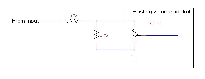

Is there an easy way I can limit the volume or gain on the amplifiers?

I have been doing some tests with different types of amplifiers, speakers and power sources, but it doesn't matter what combination I use all of them are really loud and start to distort at half the volume.

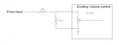

That's pretty easy to fix, just add an attenuator at the input. A couple of simple resistors will do the job quite nicely per the thumbnail. You can hide it away inside the casings so nobody can get at it. You may have to experiment with different values of resistors until you get a good result. As shown it will provide about 10db of attenuation...
