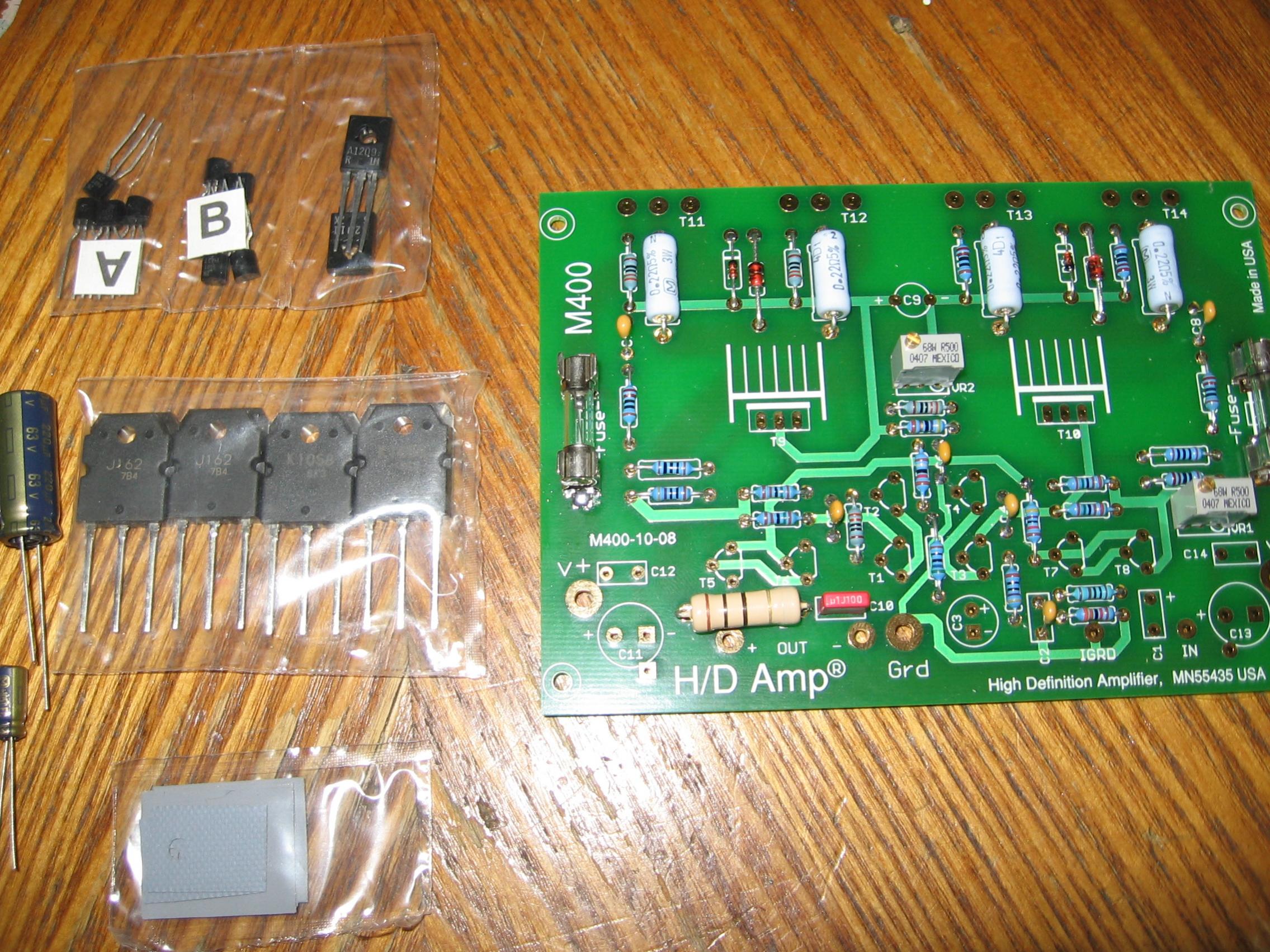

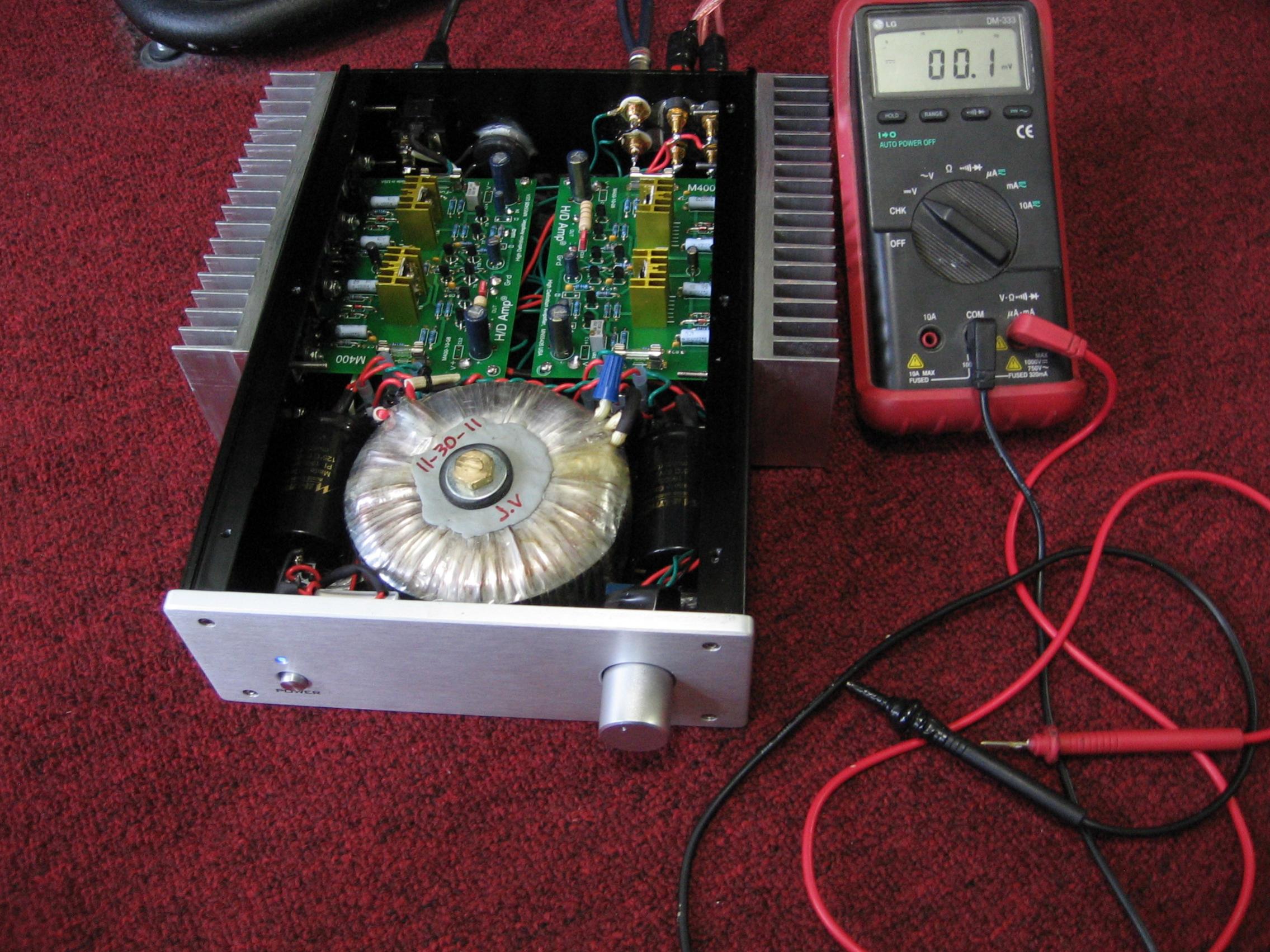

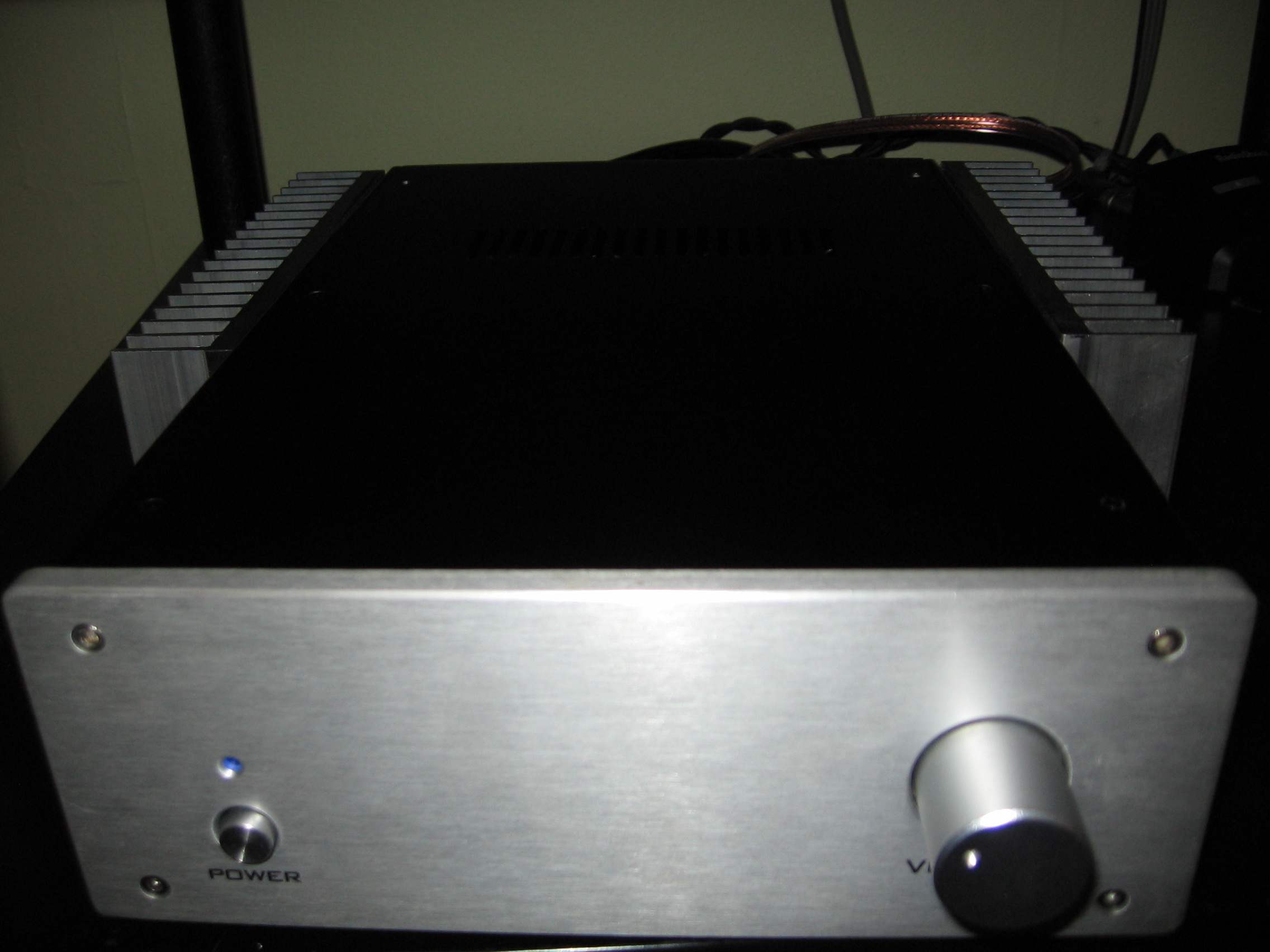

You compare with some comercial amps now!!! I spent about $500 in my diy amp!
2sk1058 2sk2221 irfp9240 mosfet amplifier schematic
then where are the measurements?
I like to see comparative measures too - whats your "reference" amp?
I could build it using dual power supply and use more capacitance (using two toroidal transformers and more caps) but my target was to build it as small as I could, but at the same time make it good. I had a Bryston B60R before this and the sound of this diy amp "believe or not" is better. The Bryston was a little noisy, and fatiguing at high volume and it got extremely hot. also it had back noise without input connected. my diy amp is as quiet as a mouse and it has more power and it does not get as hot as the Bryston. as long as I am happy with sound. all is good!
PS: to be a diy amp it is not so ugly (I think).

not too harsh for a commercial poster pushing a kit without schematic, plausible meaurement plots - couldn't afford RMAA? (free)

I also didn't immediately see the kit offering by lanchile, again I was reacting to the stereotypical audiophoolish ps quality commentary - the pics simply didn't show enough passives to really qualifiy as a superior supply - to claim that using a low esr, esl C was all that was needed is too simple
real amp, ps interactions exist, "simple" schematic amps often have insufficient loop gain and poor psrr, in those cases multisection ps filtering, even regulation can be required for decent performance
alternatively amps can be designed with adequate loop gain, proper compensation gnd reference to have superior psrr - as seen in Self, Cordell books
