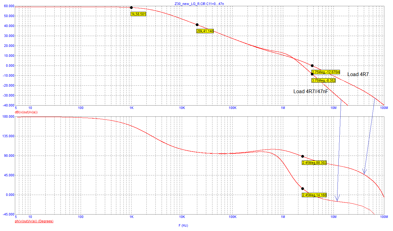

Loopgain simulation says that with a resistor load (4.7ohm) the phase margin at the point where the loopgain amplitude plot crosses 0dB, at 3.75MHz, is about 80°, which is enough for stable operation. The feedback factor (loopgain) at 20kHz is 41dB, which is the factor available for harmonic distortion reduction of this feedback amplifier, at 20kHz. At =<1kHz, the loopgain is 58dB.
![Z30_new_LG_R.PNG Z30_new_LG_R.PNG](https://www.diyaudio.com/community/data/attachments/1159/1159989-696a209b1fe40e35d08303dbccc2f061.jpg)
Now, when 47nF capacitor is added in parallel with 4R7 resistor, the loopgain amplitude plot crosses 0dB at 2.45MHz and the phase margin is now a mere 14°, so the amplifier should be close to instability.

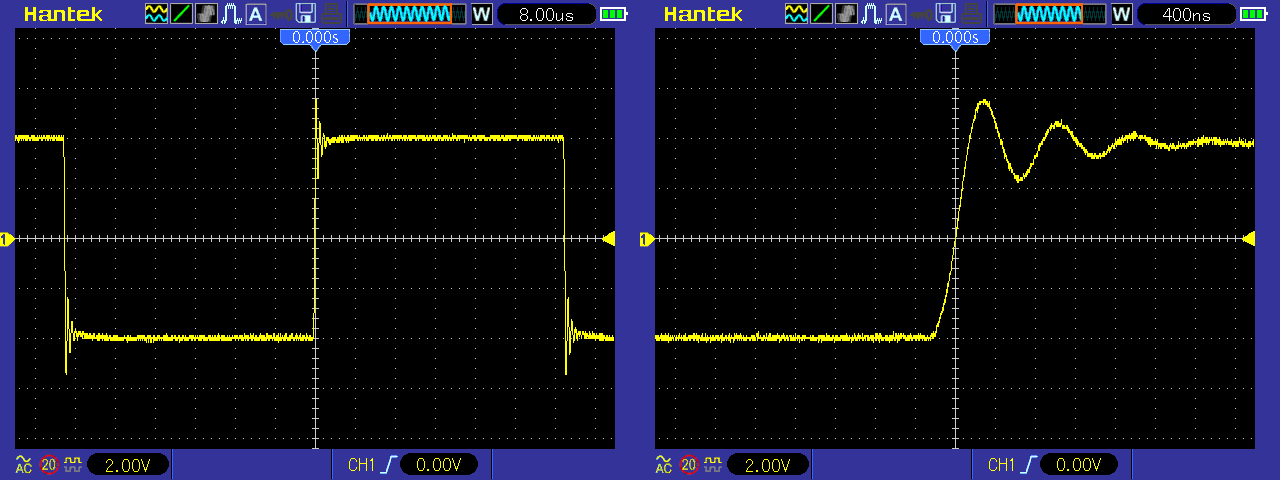

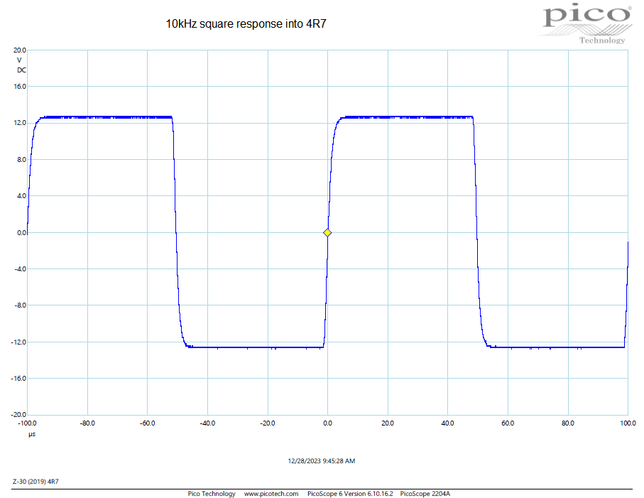

Let's investigate the real amplifier sample, with a 10kHz square wave as an input signal, and both discussed loads.
Response into 4.7ohm resistor
![Z-30_10kHzsq_4R7.png Z-30_10kHzsq_4R7.png](https://www.diyaudio.com/community/data/attachments/1159/1159991-ec7a96cc00c8dbfbb8ad7816d60d0108.jpg)
The response is nicely aperiodic, with no signs of instability. Exactly according to loopgain simulation.

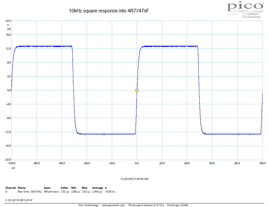

Response into 4.7ohm//47nF
![Z-30_10kHzsq_4R7-47nF.png Z-30_10kHzsq_4R7-47nF.png](https://www.diyaudio.com/community/data/attachments/1159/1159992-f2dca0cc5a1a4f6e4240262582f26212.jpg)

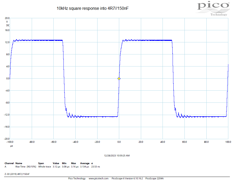

47nF capacitor was added in parallel with the 4R7 resistor, however the square response remained unaffected. This is not in conformance with the simulated loopgain, which would suggest at least heavy ringing, with the simulated phase margin of only 14°.
The amplifier is stable (in the real world) for wide range of capacitances, covering at least 0 – 100nF. First signs of compromised stability we can see with the 150nF capacitor // 4R7:
![Z-30_10kHzsq_4R7-150nF.png Z-30_10kHzsq_4R7-150nF.png](https://www.diyaudio.com/community/data/attachments/1160/1160012-cf9caee899b9f661d24b6eaa02892832.jpg)
So, for this amplifier sample with dominant-pole compensation, the simulation was pesismistic compared to the real world results. Something does not fit, models?

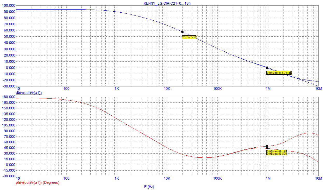

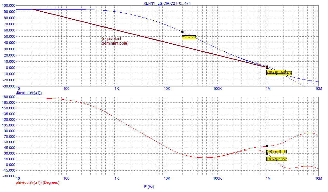

Loopgain simulation says that with a resistor load (4.7ohm) the phase margin at the point where the loopgain amplitude plot crosses 0dB, at 0.95MHz, is about 50°, which might be enough for stable operation. The feedback factor (loopgain) at 20kHz is 57dB, which is the factor available for harmonic distortion reduction of this feedback amplifier, at 20kHz. At =<1kHz, the loopgain is very high 93dB. Brown line in the graph would be a comparison to a dominant-pole compensation with the same unity gain frequency.
![KENNY_LG_compareMiller.png KENNY_LG_compareMiller.png](https://www.diyaudio.com/community/data/attachments/1159/1159993-00232f984c99da452f030691b2443ce6.jpg)
Now, when 47nF capacitor is added in parallel with 4R7 resistor, the loopgain amplitude plot crosses 0dB at almost same point near 0.95MHz and the phase margin is now a mere 30°, not much less than without the capacitor, and the amplifier should be still stable.
Another plot is with 15nF capacitor, and we can see that the phase margin is now 43°, definitely enough for the amplifier to be stable, at least in the simulation!
![KENNY_LG_15n.png KENNY_LG_15n.png](https://www.diyaudio.com/community/data/attachments/1159/1159995-c96e56a17031c3c62bb1db7b752dafb3.jpg)

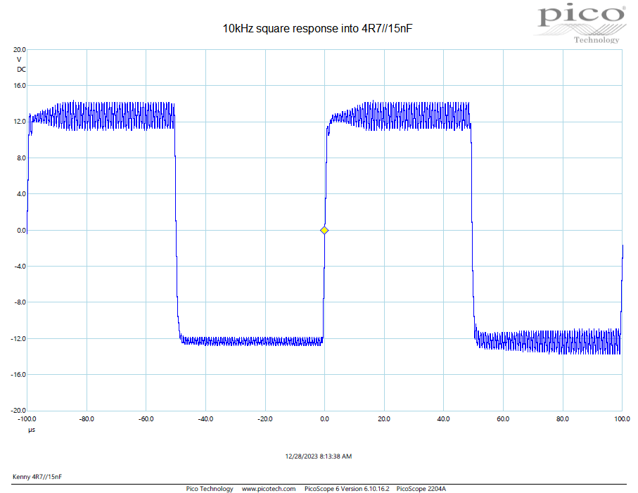

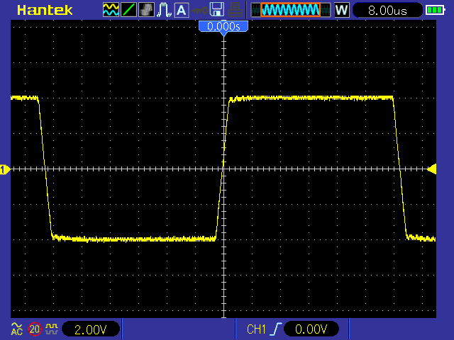

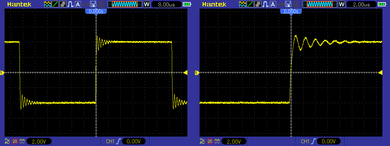

But how about the real world sample?? Alas, the amplifier's response oscillates with 4R7//15nF!
![Kenny_10kHzsq_4R7-15nF.png Kenny_10kHzsq_4R7-15nF.png](https://www.diyaudio.com/community/data/attachments/1159/1159996-3061fe2bfd6acbb1d265106416b8df91.jpg)
And increasing the capacitor to 47nF makes oscillations with much higher amplitude and the amplifier has suddenly blown the T5A fuse in the +rail of the power supply. But, due to very robust MJL21194/93 output pair, it has survived.

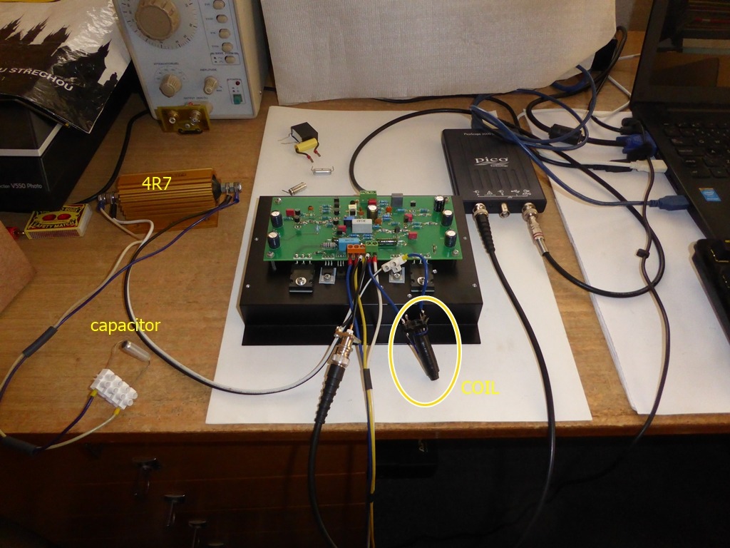

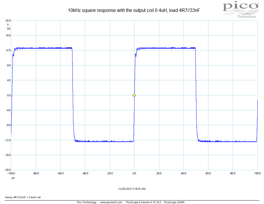

I inserted the 0.4uH output coil behind the amplifier's output ad now it was able to drive 4R7//33nF load with slight signs of oscillations only.
![Kenny_10kHzsq_0.4uH+4R7-33nF.png Kenny_10kHzsq_0.4uH+4R7-33nF.png](https://www.diyaudio.com/community/data/attachments/1159/1159997-57ad1d48cef56b080c29634c10ed11a1.jpg)
Test bench, load and output coil
![testbench.JPG testbench.JPG](https://www.diyaudio.com/community/data/attachments/1160/1160013-630a6888d08e4993d8f47ede41659eea.jpg)

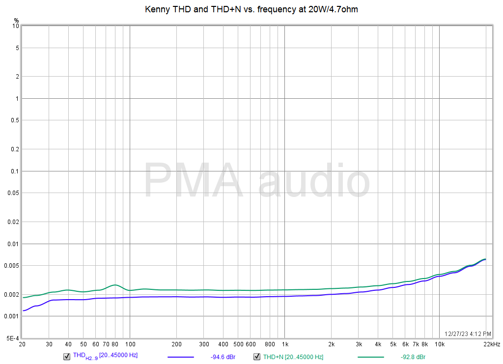

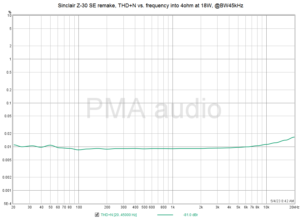

So, with the more sophisticated compensation scheme, we have got this improvement in THD+N vs. frequency at the expense of much worse amplifier stability, though the simulations did not suggest the stability worsening.
![Z-30_thdn_frequency_BW45kHz.png Z-30_thdn_frequency_BW45kHz.png](https://www.diyaudio.com/community/data/attachments/1159/1159998-81ac683a8779bfbb2fb3aca67cb26bea.jpg)
![Stepped THDfreq Kenny 20W.png Stepped THDfreq Kenny 20W.png](https://www.diyaudio.com/community/data/attachments/1159/1159999-95344cdebeab60d55653e1696b0dc9b0.jpg)
It is up to you to make a choice, if you prefer some inaudible improvement in THD+N, or an unconditional amplifier stability. And remember, do not forget to use the output coil with feedback amplifiers!

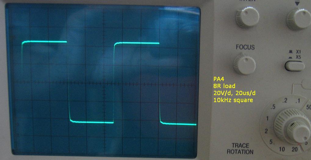

That's too low in my honest opinion. I want for my amplifiers to be able to give full scale output square wave swing.I test all my amplifiers with a 2-3V pk-pk square wave
I know that many commercial amplifiers would have big troubles with such test and I have had bad experience when testing Cello Encore this way.
My PA4 amplifier:
You can always do a power square wave test (see the nx—Amp write up for a scope shot of 70 V pk-pk 100 kHz into 8 ohms).

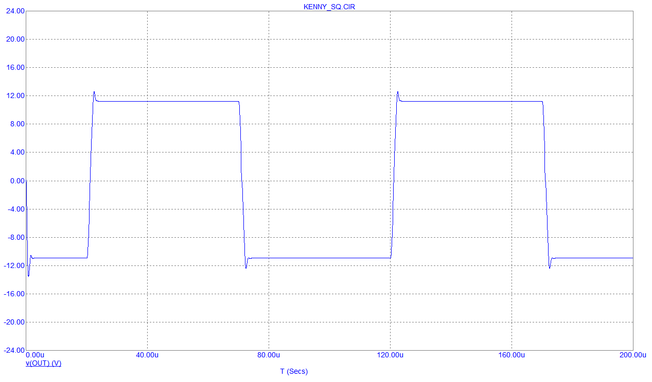

Transient simulation does not fit as well. It has been my long-lasting experience that simulation is inaccurate when investigating stability and HF non-linearities in deep.
Below the comparison of the amplifier #2 (see my post #1) transient (square) response into 4R7//15nF load, simulated generator SR kept same as in case of real generator. Simulation is stable, the real amp oscillates. It is stable only for Cload <= 3.3nF. Of course an output inductor of 1uH in parallel with some 6R8 is a cure, but the simulation does not tell. Projects that finish with simulated results only are all half-baked, and there are more and more of them at DIY audio. DIY means do it yourself, not sit in the armchair and click on keyboard. However, we can see the trend everywhere. It is easier than to build something.
Simulation amp #2, load 4R7//15nF
Measurement amp #2, load 4R7//15nF
One might ask why am I testing such things like large signal square response. The answer is easy - the amplifier must be designed to survive worst case scenario and to keep speakers safe. One of the scenarios is that someone accidentally pulls out the input RCA cable. RCA connector is infamous for the reason that ground connection is disconnected first and live after that. Similarly when someone inserts RCA when the amp is on. Live RCA contact goes first and the amp, depending on system gnd configurations, may go to full output immediately and worse, often goes to MHz range oscillations. I have already seen several broken amplifiers and burnt speakers exactly under the conditions described. So, amplifier operational safety first, under any conditions. Fighting with harmonic distortion of 0.0001% is just a toy game.
