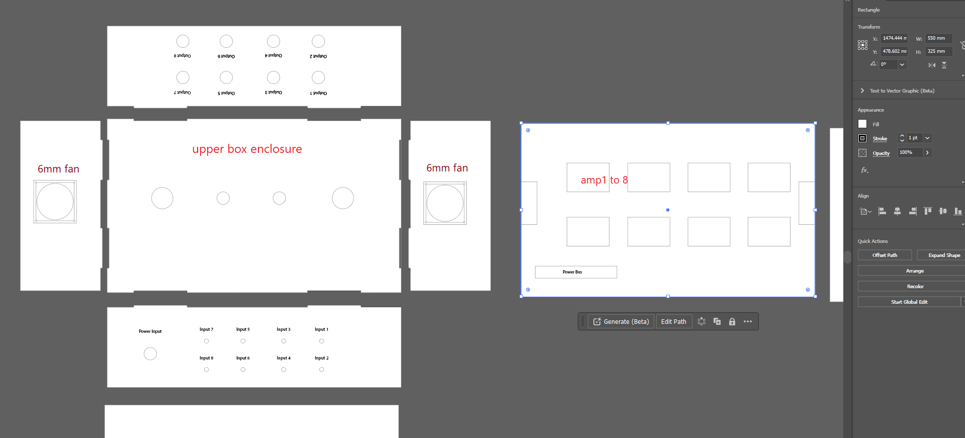

Here is my plan for the box.You will need a large cabinet, proper heatsinking
Size is 550mmx325mm with Depth of 155mm

In general, fine, although not too sure about all that fitting inside such a small box.Here is my plan for the box.
Try it first on a piece of paper, drawing a rectangle on it and physically placing all boards in place, power supply, connectors, switches, IEC connector, everything.
Drawing rectangles on screen is a necessary beginning but does not give you the real idea of physical space use.
Only after that purchase the proper case.
Leave 40/50 mm around each board, power supply module, etc. , 40/50 mm "free" space along front and back panels for connectors and wiring.
You show 2 fans, hope "6 mm" is a typo.
Use 1 or 2 24V PC type fans (3" to 4") on one side (say, left) and punch ventilation holes on the opposite side.
No need for a "hurricane" but you want a good steady flow across so those built-in heatsinks can do their job.
Being efficient Class D not a big deal if it was a single amp but you are cramping 8 of them into a small case.
Plus the power supply.

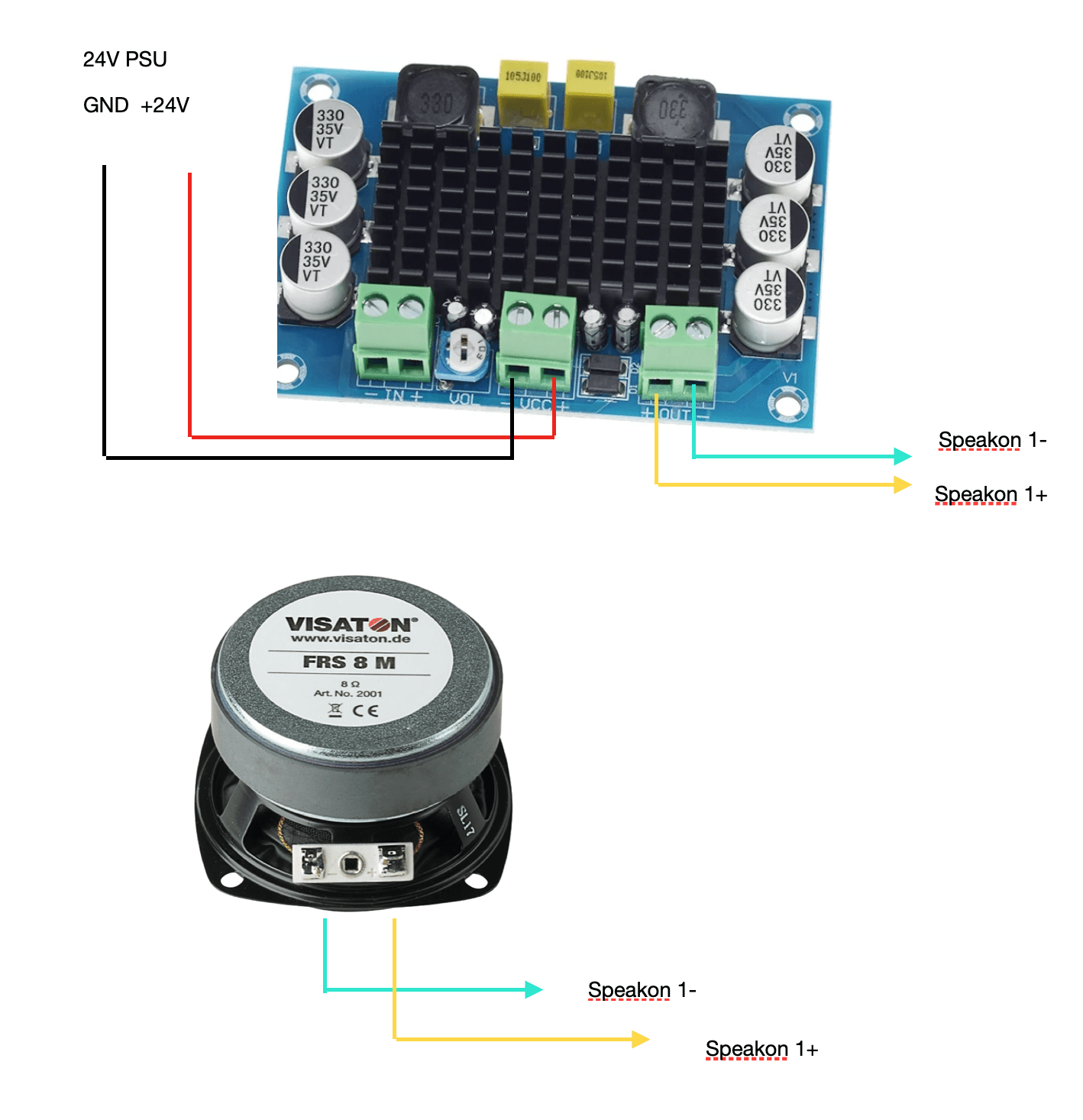

here is a diagram of how I thought of connecting the amp output to the speakon connector:In any case, speaker connectors must be isolated from ground, those amp outputs are balanced/bridged.
a 2 wire speaker cable will connect between the amp and the driver.
Is that make sense? Is this considering isolated from ground?

Actually it will be:
2 wires from each amp speaker out to Speakon chassis connector 1+ and 1- (they are so labelled)
Speaker cable with Speakons at each end.
2 speaker wires to 1+ and 1- connector pins.
Nowhere is any cable connected to chassis or supply ground.
My warning was because some metallic connectors, say 6.35mm guitar jacks, RCA, etc. "automatically" self ground on mounting, unless specially insulated.
No problem with plastic connectors.

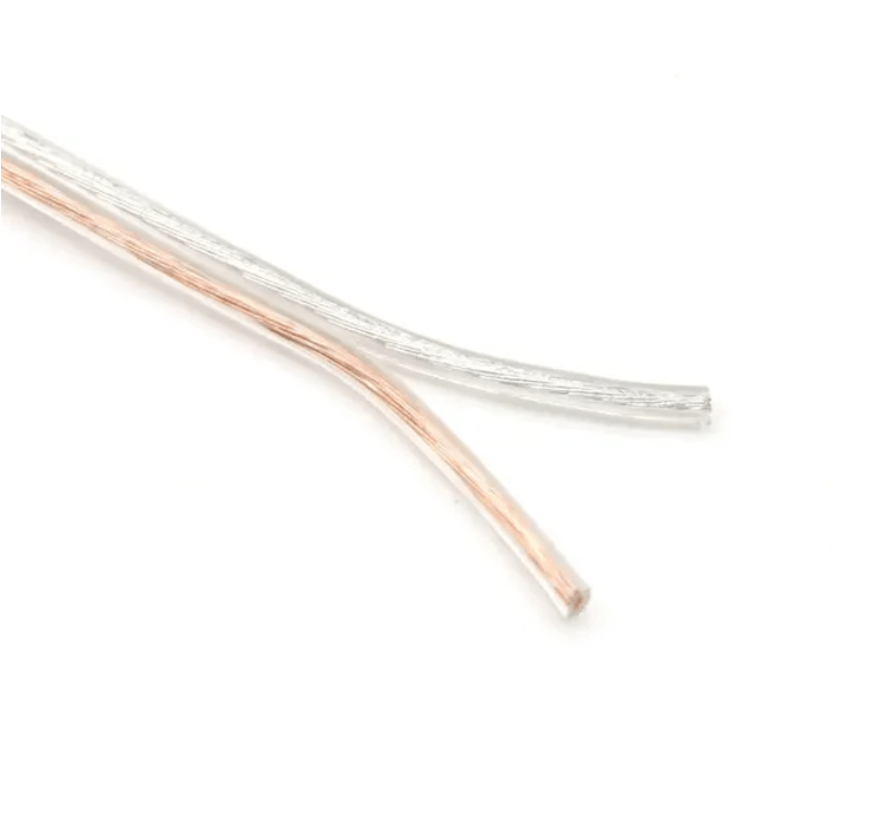

Try to use 1mm² wire if available.
Here it costs same as 0.75mm².
If possible get the red-black "speaker" type to make it easier keeping phase.

You mean this type of speaker wire right? Without the plastic insulation on top the two wiresTry to use 1mm² wire if available.
What the disadvantage of using this type?
I could think of easily the two conductor will separate from one another?
