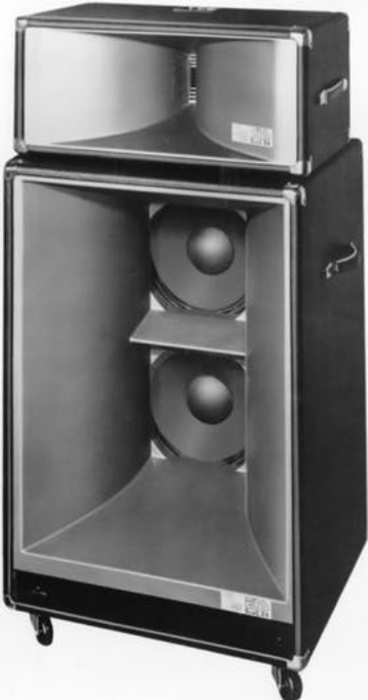

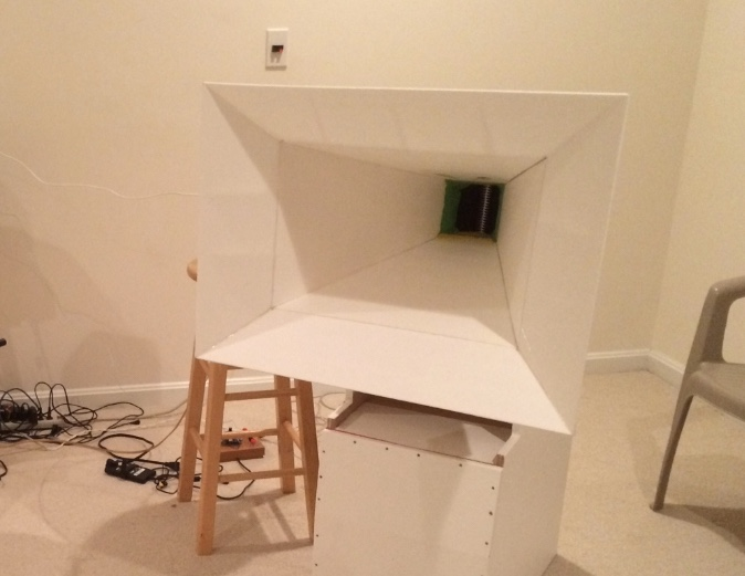

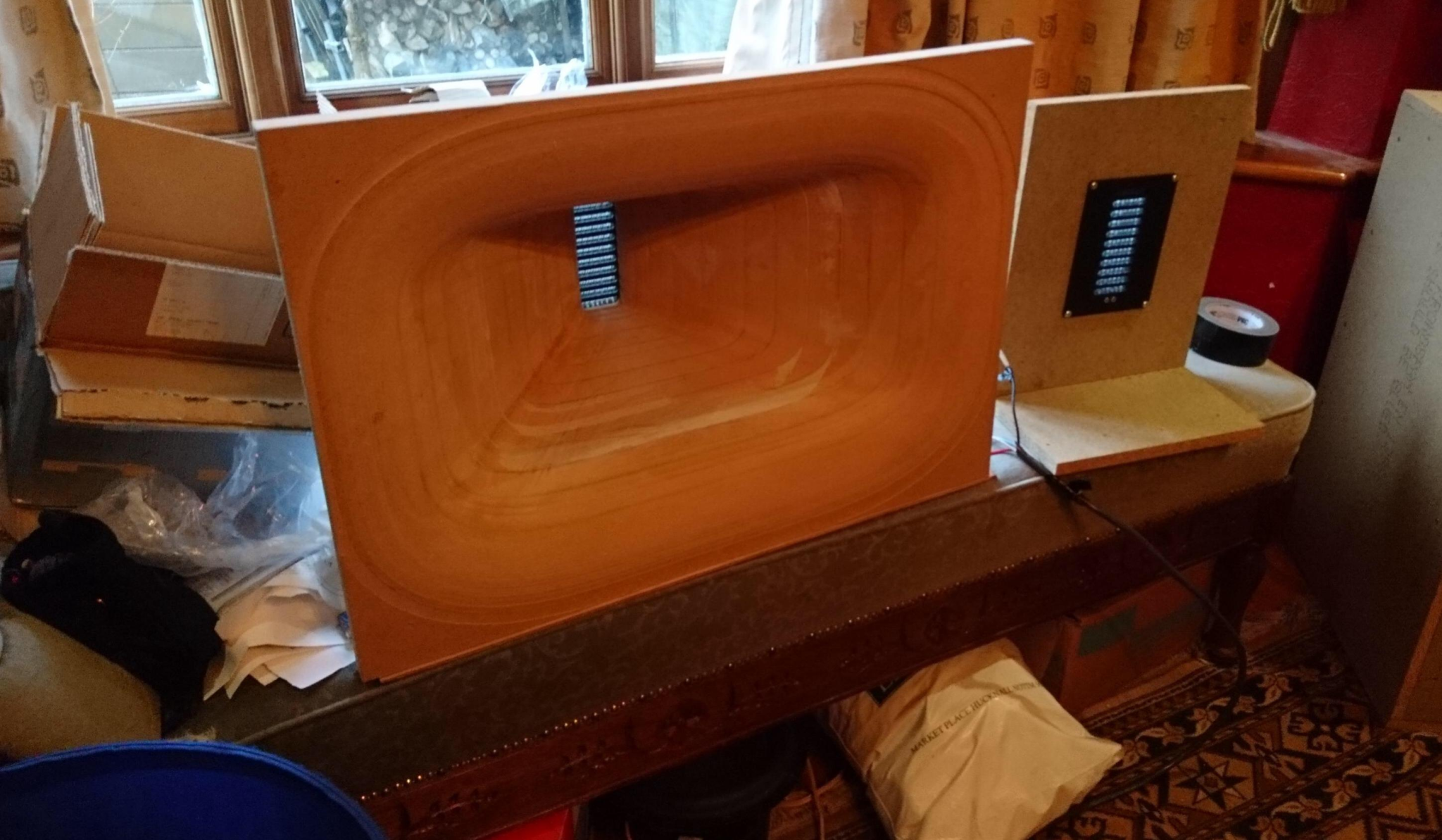

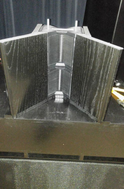

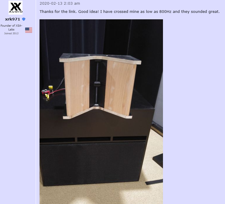

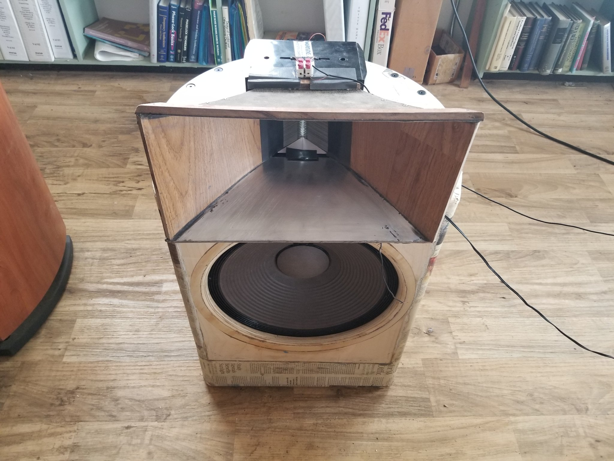

Anyone tried AMT tweeters with a horn or (deep) waveguide - for even more efficiency and extended range?

Multiple designs of interest at this first thread.
www.diyaudio.com/community/threads/ess-amt-1-in-my-projects.349546/

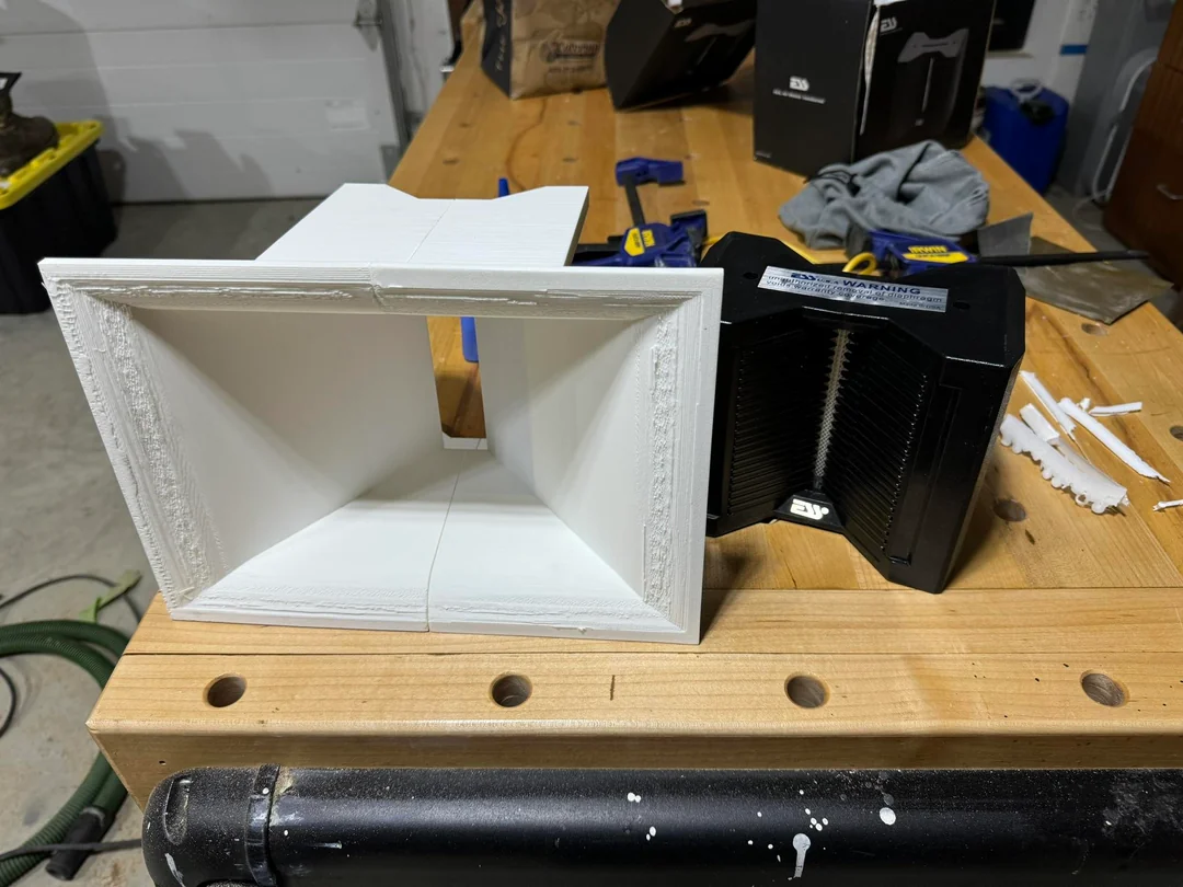

www.diyaudio.com/community/threads/attaching-wave-guide-to-a-heil-amt.403372/
www.diyaudio.com/community/threads/wave-guide-for-midrange-amt.343210/
https://community.klipsch.com/index...-with-wings-possible-kit-for-heritage/page/7/

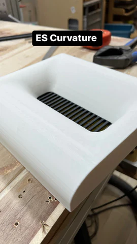

www.reddit.com/r/diyaudio/comments/1gm6wqx/3d_printed_waveguide_for_heil_ess_amt/
https://www.facebook.com/photo.php?fbid=10153076327306866&id=85313456865&set=a.10151010328041866

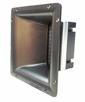

https://josephcrowe.com/products/waveguide-no-1905-for-dayton-amtpro-4-tweeter
https://audioxpress.com/article/tes...sound-amt-and-xmt200-horn-from-eighteen-sound
https://www.beyma.com/speakers/Fichas_Tecnicas/beyma-speakers-data-sheet-amt-TPL150H.pdf

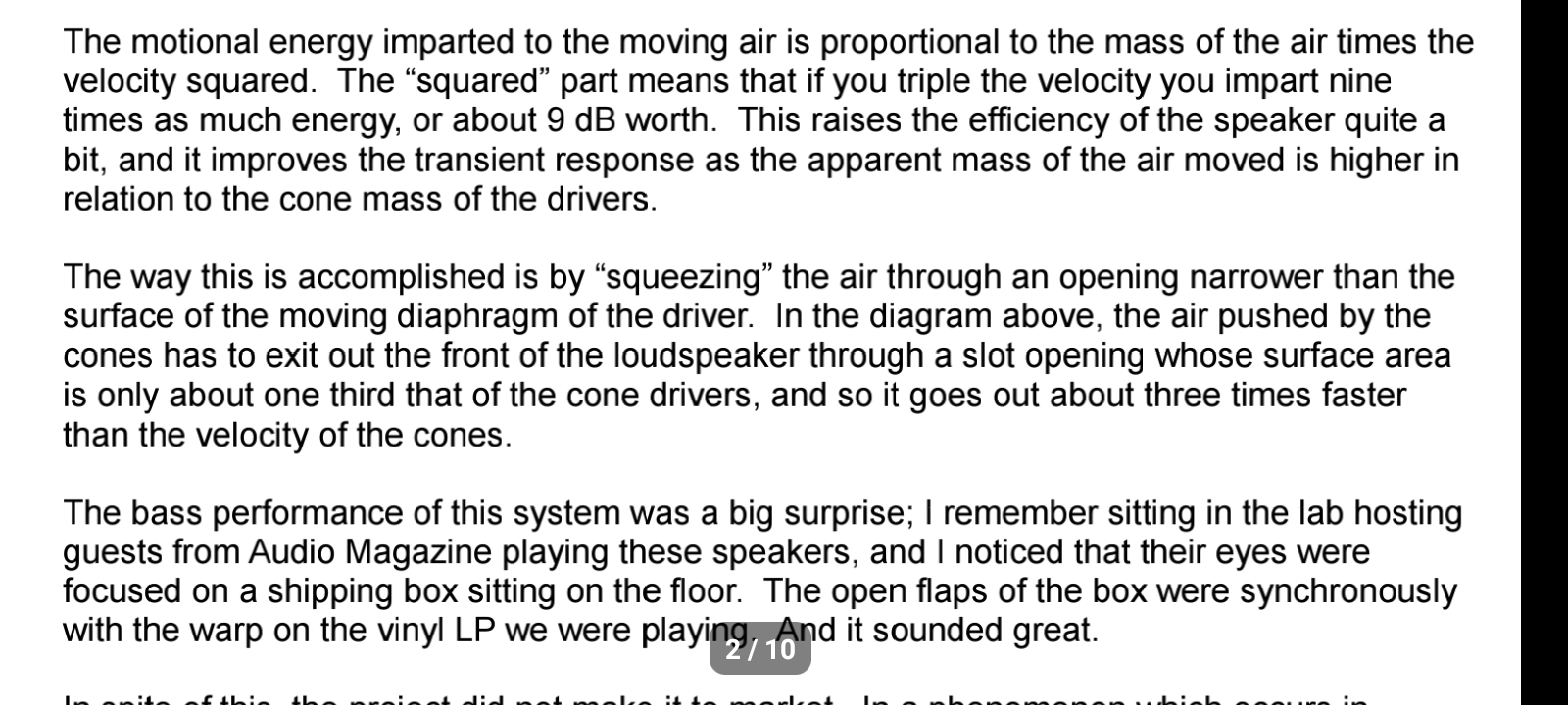

The Slot Loaded Open Baffle Project by Nelson Pass
https://www.firstwatt.com/wp-content/uploads/2023/12/art_slob.pdf
@mattstat
great. Interesting to make a subwoofer slot loaded to a corner making the system more efficient "for free"
Maybe slot loading of two drivers facing each other is not necessary. Just giving the driver only one third of its radiating area as opening.

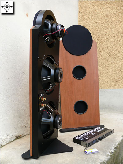

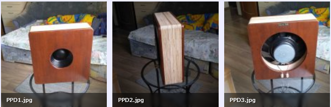

Some Emerald Physics speakers did that, but I'm not sure if it was for the same reason.Just giving the driver only one third of its radiating area as opening.
https://6moons.com/audioreviews/emerald/1.html
The PPD approach also uses a restricted opening.
www.diyaudio.com/community/threads/ppd-subwoofer.393371/
