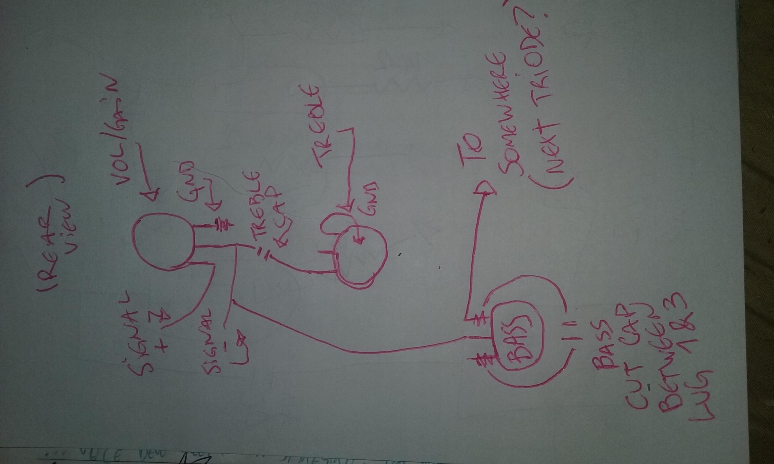

tube amp-wise, either with or without master volume, the 'gain/input volume/drive/volume' potentioneter is usually placed right after the first triode, between v1a and v1b;
so, if we wire the input gain potentiometer with the treble potentiometer in the fashion of 50's style / gibson les paul wiring, we would end up with an effective treble bleed insurance for low volume settings + early treble filtering, if wired exactly like a 1 pickup volume/tone 50's wiring les paul guitar
the benefits of this approach would be more clarity/less treble loss on lowest gain settings, plus less high frequencies distortion on the later stages (highs tend to sound better on clean amps, leaving the mids to be distorted/overdriven)
then, right after this volume + treble a la 50's wiring style, we just add a bass cut potentiometer, with signal coming to the middle lug, shorted with any outer lug 1 or 3, and a capacitor, lets say, 2.2nf with one leg on lug 3 and another on lug 1
this early bass cut could improve clarity, save energy (all bass frequencies demand alot of amplification power) so the little bass left to be amplified could be kept as clean, so it would sound like a clean fender without mud or farting
so in resume it would end up with clean highs and lows... overdriven mids, less components, less loss, yet simplier to build
it seems to be too good to believe, so why this design isnt seen as much in amps and tube pedals?

Low-loss tone controls were used in some bargain amps (because they had very little gain to spare), do a search on cheap, low-end guitar amps and you should find some examples.

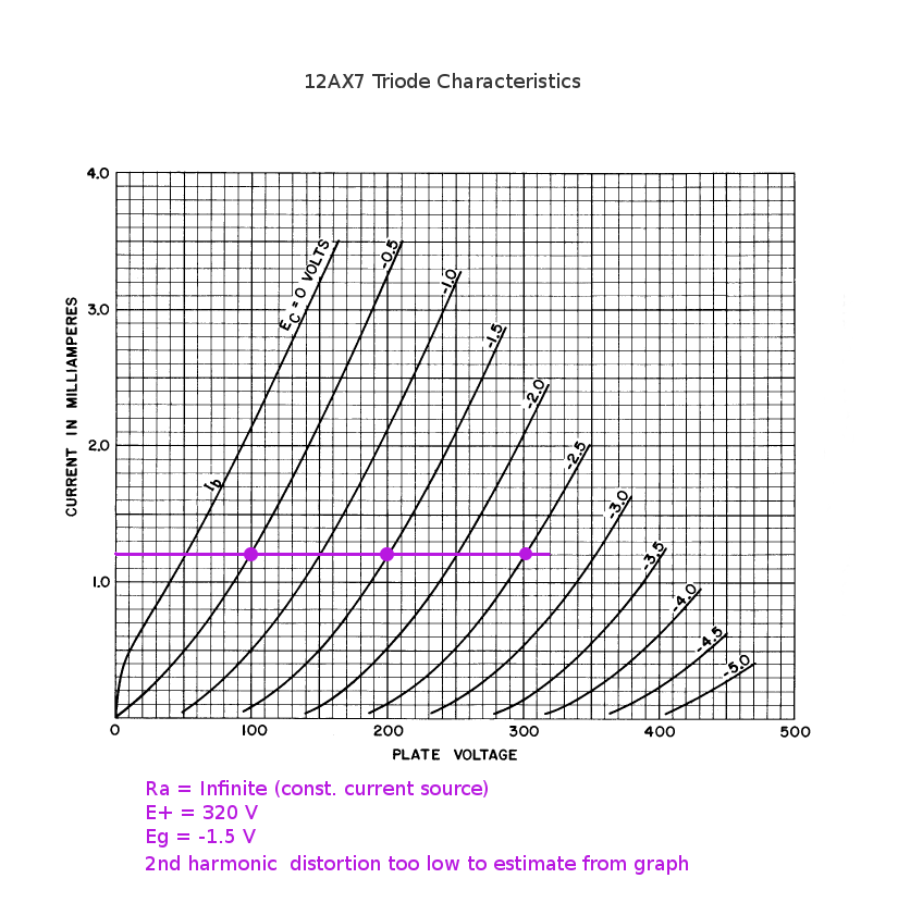

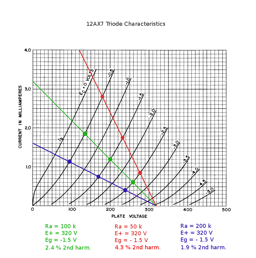

It's true, though. For the same input signal, there will be more harmonic distortion in the output, when a lower Rp is used. Even though the gain is reduced!I never thought that by lowering the RP there would be more distortion...
The attached images show what is happening. I've plotted three different loadlines on the same 12AX7 curves, corresponding to 100k, 200k, and 50k plate resistors. On each line, I've plotted a dot corresponding to the bias point, and two adjacent dots corresponding to +1V and -1V voltage swings at the input.
Because the triode curves are not equally spaced - they are further apart as you go up the graph to higher plate currents - the distance - these three dots are not equally spaced. The +1V dot is a little further away from the central dot, than the -1V dot is. This slight asymmetry causes the lovely "tubey" clean tone that guitarists with good ears want so much.
Given the unequal spacing of the three dots on each loadline, there is a simple mathematical formula that I used to estimate the amount of 2nd harmonic distortion.
As you can see, different load lines (values of Rp) tilt the load line one way or the other, and this changes the amount of asymmetry, and therefore, the amount of (slight) distortion in the clean tone. The lower Rp is, the more distortion there is!

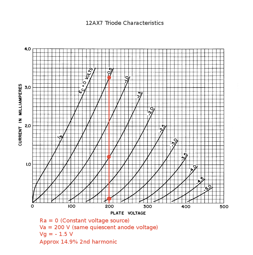

The second graph shows why the valve Hi-Fi crowd like to use constant current sources for plate loads, rather than just a resistor. A constant current source is like an infinitely large resistor as far as AC signals are concerned - and as you can see, it lowers distortion so much, that I couldn't even calculate it from the graph.
What is the opposite of a constant current source? A constant voltage source, which has zero resistance to AC. And a cascode arrangement of two triodes comes very close. If we want maximum "tubey" cleans from a single triode stage, we should be wiring it as a cascode! The last graph shows what we can expect if we use a half-12AX7 as the lower device in a cascode.
-Gnobuddy

For this graphical analysis, I kept Vgk the same at (-1.5V) for all three loads. B+ is also the same at 320 V. Finally, the input voltage was also kept the same in all three cases (2 Vpp in every case.) So this a pretty fair apples-to-apples comparison.
I have also done a similar graphical analysis keeping the same operating point, but different Rp values, i.e., keeping Vgk, Vp, Ip, and Vin the same.
To keep Vp and Ip the same when Rp varies, B+ has to be allowed to vary as needed. (All three load lines intersect at the operating point, but have different slopes, so they intersect the current and voltage axes at different points, so B+ will be different in each case.)
This second graphical analysis also leads to the same conclusion: there is more distortion for the same input signal and same operating point when Rp is smaller, as long as the device is kept out of clipping.
-Gnobuddy
