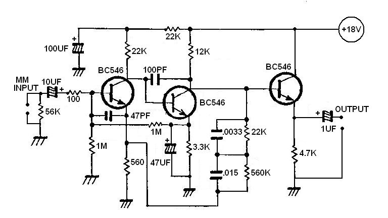

I'm curious about this phono preamp design, and wonder if anyone can do a 'spice' investigation of its design.
Namely to find out it's accuracy (%) at adhering to the standard RIAA curve.
And what a common 3.5mV cartridge would be amplifed to a final level after the Emitter follower 'booster' transistor.

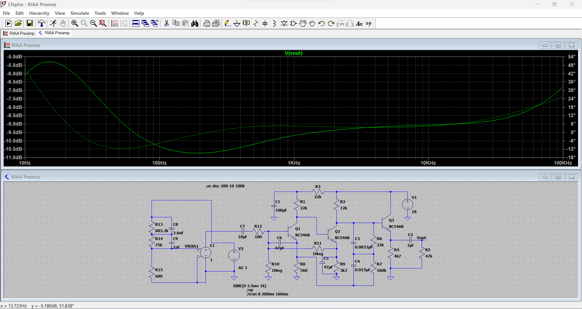

I've simulated your preamp
Here is the file. All you do is click the file and it will open all ready to run.
Click my signature line to see how to install LTspice and here is the link for LTspice. The thread details a lot about where LT installs stuff. To use it just install and click and run using the defaults:
https://www.analog.com/en/design-center/design-tools-and-calculators/ltspice-simulator.html
Here is the preamp file attached below...

I only wanted a bit of help from someone who could take a moment to run it though and give me an idea of how accurate this design is, and if I should or could make any tweaks to bring it within say, a 1% accuracy of RIAA.
This is already on a thru-hole board, and to my ears sounds fine when compared to other commercially built preamps.

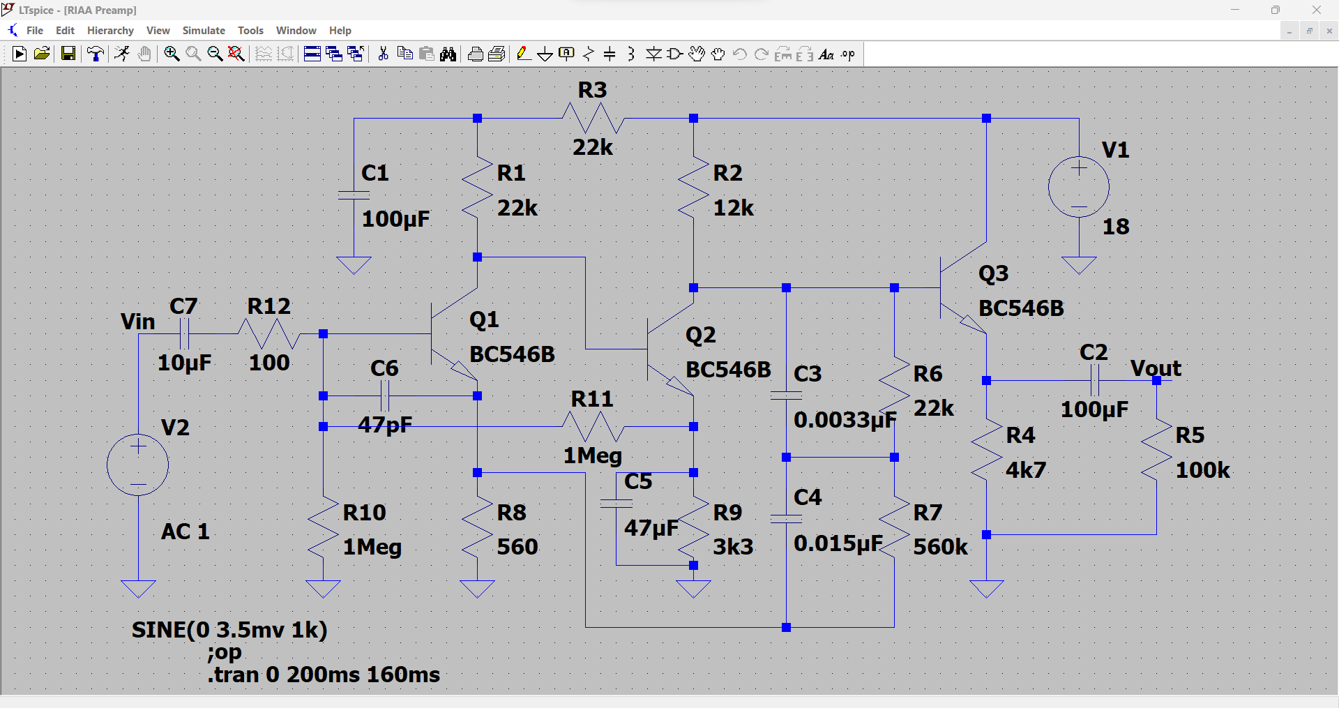

BTW, the output cap you used is wrong - it's a 1uF, and loaded by a 47K resistor in the amp.

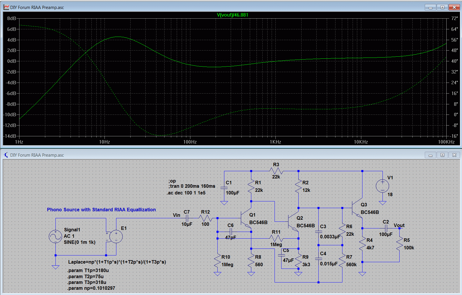

Well, that gives me some idea of its performance.Here is the frequency response plot. At 1 kHz the gain is 46.88 and there is a greater than 4dB rise at low frequencies which would aggravate rumble. It would take some adjustment of the feedback components to flatten the response.
That 'crest' from 70-15 Hz is fixable?
Seems the rest of the response to 20K is pretty linear.

Thanx Bill. Ya, I was thinking it needs a RIAA source. Do we need to build it out with a typical cart impedance? Besides a simple 47K resistor? LOL, you know I don't care beans about vinyl, but the simulation is interesting.Here is the frequency response plot. At 1 kHz the gain is 46.88 and there is a greater than 4dB rise at low frequencies which would aggravate rumble. It would take some adjustment of the feedback components to flatten the response.
