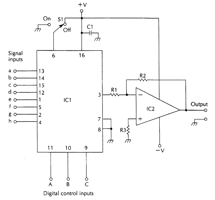

switch current, not voltage, by loading it into a virtual ground.
Wasted 10 minutes into stupid google, couldn't find a linkable image of this very common circuit, so this one will have to do with one important correction:
a) short R1 which is to the right of IC1
b) put an individual R1 at each of the 8 IC1 inputs , meaning each to the left of respectively a, b, ...h
that way the CMOS switches interrupt *current* getting into IC2 "-" input, which is the virtual ground..
Switches in general are more efficient at interrupting current (which need a conductive path to travel) than voltage, which can bypass such an open path by inductive or capacitive coupling which is inherent to any real world wiring.
By the way, the original example shown uses a virtual ground stage ... but connects the switcher in such a way that it switches voltage 🙄
The way I suggested corrects that 🙂

Actually, this circuit can handle a ±50V input signal… with the 3.3V powered switch.
In my test circuit, I use a 10KΩ resistor in series with the switch input and place the switch output at the inverting input of the current to voltage converter stage. So, the switch has 1.9Ω resistance, and the feedback resistor is 3KΩ, so I can put ±50V into the input, limited essentially by the resistor's breakdown ratings and the voltage swing of the output amp. The 3.3V supply of the CMOS switch is not an issue - the switch sees 10mV or so of signal with a 50V input... Again… I'm switching _current_ and all of the voltage has been dropped by a factor of 5000 by the input resistor ahead of the switch. The inverting current to voltage amplifier that follows the switch converts the signal current back into a voltage and all is well again.
You have to compensate for the shunt capacitance of the switch, because it destabilizes the current to voltage converter stage, but it's not such a big deal. Each switch is around 27pF, so the product of the feedback resistor and the feedback cap should be greater than the product of the switches shunt capacitance and the input resistance. Not hard to compensate for at all. In this case, with a 27pF switch and a 10KΩ input, I'd use 100pF across a 3KΩ feedback resistor, and it's stable.
Current mode is a far better thing to do with a CMOS switch - you eliminate on-resistance variations with voltage, and also shunt capacitance variations with voltage, both of which generate distortion. Eliminate the voltage, and you eliminate most of the problems with a CMOS switch.
Off leakage also gets nice since you can shunt the input signal current to ground when the switch is off - it's a DPDT switch, so when it's on, you can wire it to feed signal current into the virtual ground, and when it's off, send the signal current to ground. So when the switch is off, there is very little signal voltage that could feed through to the output amplifier.
Again… current mode is the way to use a CMOS switch. Voltage and CMOS do not get along well, so twist up your circuits and use them the right way!! 🙂
