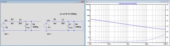

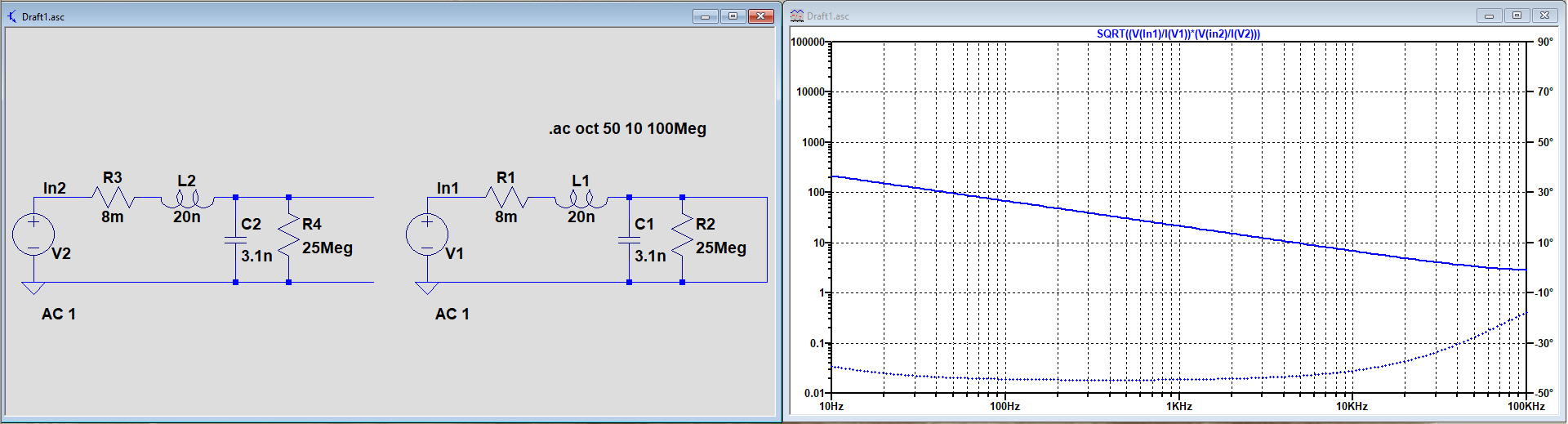

I was curious about the Townshend statement concerning their Isolda cable with a characteristic impedance of 8R.
L=20nH/m, C=3.1nF/m R=8m/m G=(1/25Meg)/m
A simple way to measure the characteristic impedance is Z0=Sqrt(Zopen*Zshorted).
Thats exactly what I did in LTspice.
See image below.
Only at 7Khz is the Char. Imp. equal to 8R.
When I haven't made a mistake, Townshend's claim is far from accurate.
Hans

Audio Engineering Society Fellow, Jim Brown Wrote in a paper.
Transmission Lines at Audio Frequencies, and a Bit of History
If you study transmission lines in college or from the ARRL Handbook, you will learn the classic equation for characteristic impedance.
ZO= [ L/C) ]1/2
What most of us have long forgotten (and that few universities teach) is that this is the simplified form of the equation. In engineering classes, we make equations simpler by assuming certain conditions will be true for what we think will be the conditions when we use them. That’s fine as long as we don’t forget those assumption, but in this case, most of us have. The full equation for characteristic impedance is
ZO= [ (R+j2πfL) / (G+j2πfC) ]1/2
