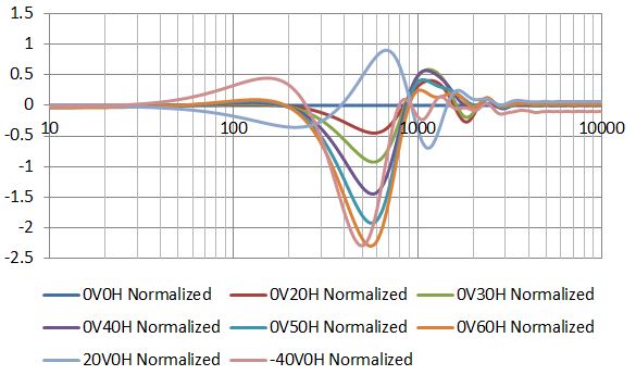

Hi Folks,
I was intrigued by Grimm Audio's claims of the benefits of a wide baffle, so decided to explore how they affect perceived timbre, with some simulations, and start a new thread here. I've attached the complete pdf, but some high level observations are:
Grimm Design Philosophy: “What we can do is decide where to put the baffle-step frequency. Psychoacoustics tells us that below about 300Hz the ear will no longer clearly discern direct sound, first reflections or reverberant sound. Presumably the evolutionary background of this is that the vocal range starts here. Anyhow, we can live with a transition to omni below 300Hz. If we can get reasonable, constant directivity above that, we have a design spec!” “doing it right means: a single unit per “way”, spaced closely together on a baffle of at least 20” wide. Now, wide baffles have a reputation of less than stellar imaging. This is because diffraction artefacts become audible as distinct reflections whereas on narrow baffles they are perceived only as colouration. The solution is simple enough: generously round off the edges”
After modeling the diffraction of the Grimm LS-1 and comparing to a standard narrow baffle:
The LS-1 is a carefully designed system where the baffle width was chosen to counteract the specific driver’s change in response off axis out to 30 degrees, leading to greater flatness within a 30 degree listening window. Since the design is optimized for near field recording, this is staple requirement. The trade-offs are larger off axis nulls due to the larger woofer. However
• The wider baffle decreases the off axis response from 200 to 700 Hz by ~ 3 dB, relative to the standard narrow baffle. Stated another way, equalized to flat on axis, the LS-1 (or other large baffle designs) will have up to (the full spherical diffraction would need to be calculated to arrive at an exact value) 3dB less power response in this frequency range than a narrow monitor. A speaker with excess 600Hz can sound “hollow”, so this tuning will be the opposite of that (less hollow than pure accuracy?), but can also reduce the clarity of bass lines or thin out guitars.
• The similar is of course true for the narrow box. Equalized to flat on axis, the narrow monitor will have up to (same caveat for full spherical diffraction) 3dB less power response from 700Hz to 1.2 kHz than a wide baffle speaker. A speaker with less energy in this range can sound less “punchy”. The 500Hz to 1KHz region produces 35% of the intelligibility, while the range from 1 to 8KHz produces just 5% of the power but 60% of the intelligibility. So the wider speaker may offer enhanced intelligibility.
I think it is these last attributes: differences in power response; that probably most distinguishes the sound of the LS-1 relative to an equally well designed narrow monitor: it puts the power response “hole” in a different frequency range than a narrow monitor. This is akin to providing less “power” BDC while maintaining a flat on axis response.
I can see how this could be “interpreted” as more accurate. With less energy in the lower frequencies, there is less upward masking, therefore more perceived detailed. It’s impossible to ascertain if it’s truly more accurate, as true accuracy would involve a perfect engineer capturing the live event perfectly on his recording system, and a playback system with the same on axis and directivity as the recording system. So, is the LS-1 design or are other wide baffle systems more accurate than a narrow monitor? This is impossible to tell due to the circle of confusion. Is the LS-1 a very well-engineered loudspeaker with a relatively unique choice of trade-offs for the consumer? Definitely!
Epilogue: The LS-1 design brief on the Grimm Audio web site contains a comparison of LS-1 directivity to that of a narrow M-T-M. This is misleading as it’s an apples and oranges comparison. The negative effects of the MTM under discussion were due to two woofers increasing off axis comb filtering, along with the greater diffraction presented to the tweeter by the 2 woofers vs 1 woofer. Neither of these drawbacks will be worse relative to the LS-1 for a well-designed narrow M-T.
Full details attached. Comments welcome, looking forward to others' findings with wide baffles (especially measurements).

Hi All,
Based on email received, I want to clarify something in case it wasn't clear in the paper.
When the notch in the power response is moved to lower frequencies by wide baffles, it will tend to sound more like a frequency response change. We hear the integrated room response as timbre below ~ 500 Hz (Grimm quotes 300Hz, Toole 500Hz).
With a standard thin baffle, the power response is higher in frequency (~ 1kHz) and has less impact on the timbre as direct sound starts to dominate timbre. We integrate timbre over shorter time windows as you go up in frequency.
Of course, side wall reflections will still affect tonality at the higher frequencies if the side wall reflection is close enough (some quote 10 ms, others 15 ms) to the direct sound.
Comment still stands about the room modes having more affect on the power notch with a wide baffle.
This was a bit oh an "AHA" moment for me that I hadn't seen elsewhere, so thought I'd share.

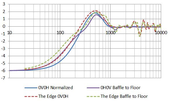

Grimm chose to limit the maximum baffle size for the sake of appearance.
I simmed up the on axis diffraction if they extended the baffle to the floor (floor notch/reinforcement not included). Attached the graph. Also included sims with the Edge as a data check.
Extending baffle to the floor adds about a 1 dB boost on axis below ~ 200Hz. Since Grimm equalizes for flat on axis anechoic, that means the large baffle would lean out the perceived response by 1 dB below 200 Hz, given that it's the room power response that dominates timbre at those lower frequencies.
