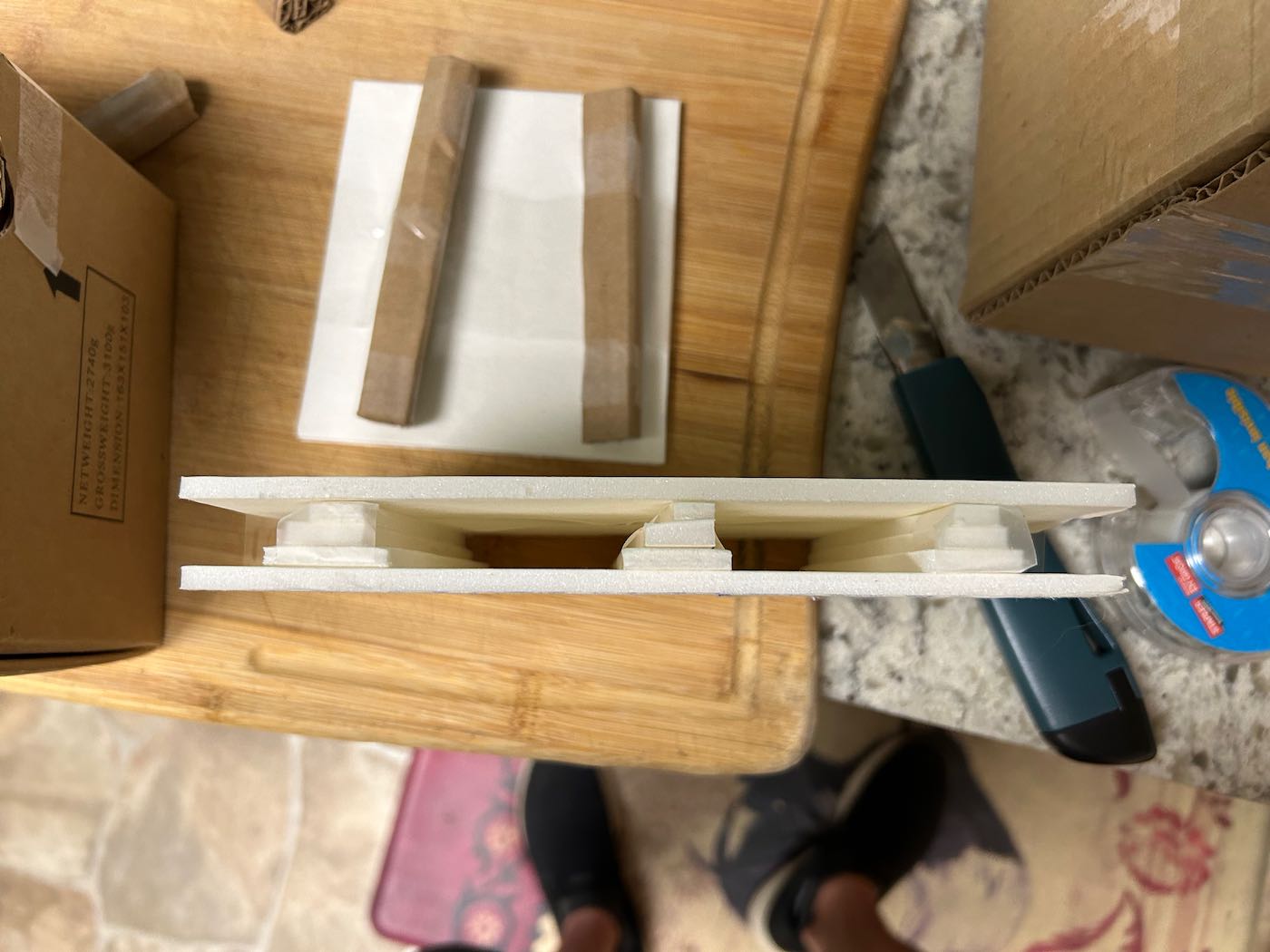

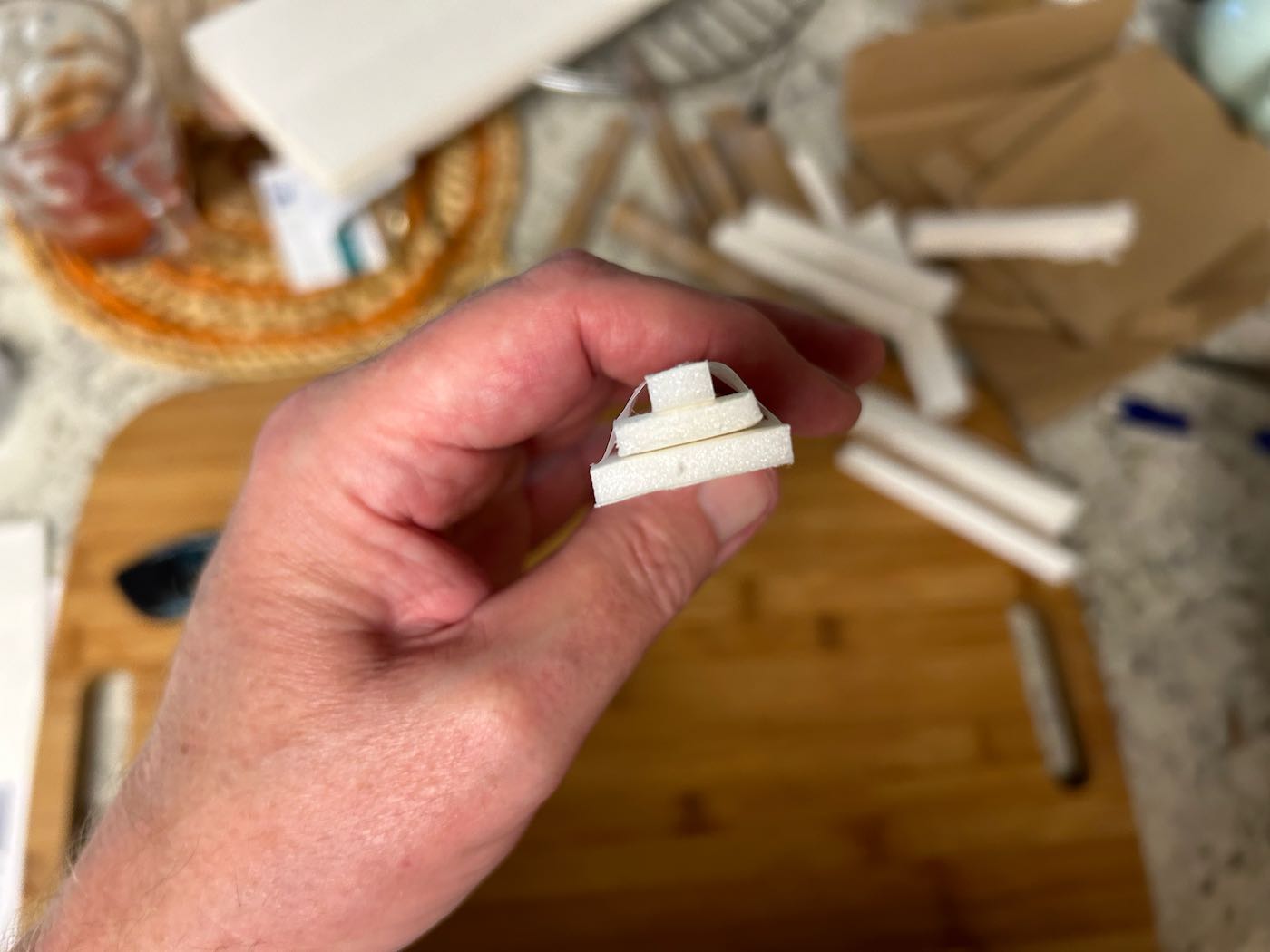

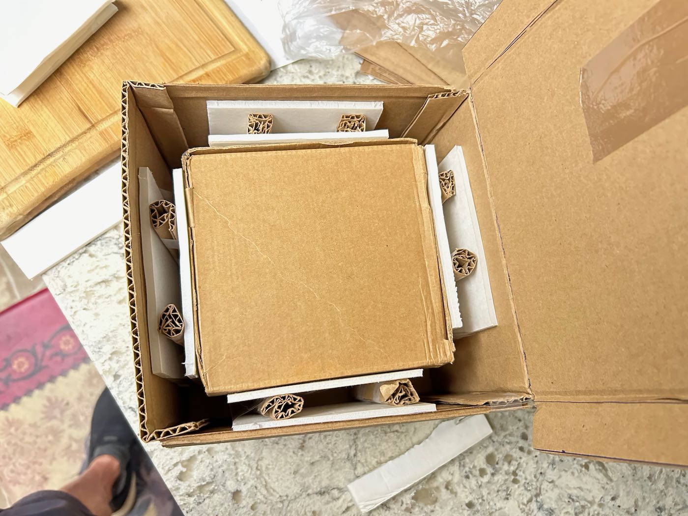

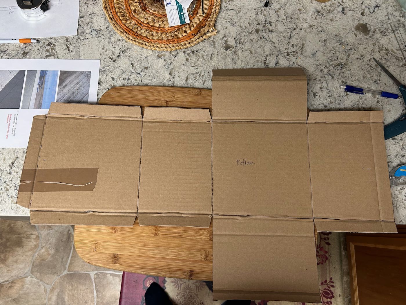

When you want to ship overseas, you keep it strong and impact resistant obviously, but as small and as light as possible. I am soon to send a pair of tweeters across the water. The cost is astronomical as you go up in size and mass. Hmmm... nothing around the right size at home but there is some large cardboard boxes in the basement. This is what happened.
Measure what you need, lay it out and cut it up.
Figure out how you are going to protect the contents on all six sides
Go to work with your box cutter and tape.

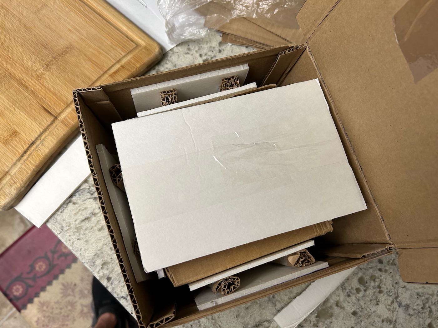

The inner box has a pair of Aurum Cantus G3Si tweeters. Top and bottom are the foam board sandwiches and sides use cardboard rolls in the sandwich.
Bon Voyage my precious little ones.

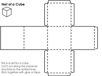

So, your tweeters will have flown the nest? Let's face it, Cal, you can't keep them wrapped up in cotton wool for ever!
Making a big box into a smaller box is a great idea. I found this handy net on the 'net. 🙂
Excellent Galu.
You can see my diy is similar but seems to have the wrap around tabs at different locations. Other than that, it's good to know your diagram is available to us all. Perhaps I should have googled, but it also looks like I did, what I should have.
Not bad for a rookie 🙂
I am pleased with my impact bumpers. I sure hope they do the job.

Cal, not trying to be pedantic, but drawing on shipping of literally 1000's of boxes.
Looking at the attached, those filling parts on the sides can (and often do) move sideways with transport vibrations. So they end up in the corners and the center package then may move, with possible damage. The corner cavites should be filled to fix the side fill elements. Just my € 0.02.
But your construction is far better than many I have received ...
Jan

all criticism is good criticism. So many persons think negative criticism is the only kind. I say they are thin skinned. Yours is always welcome.
I know my photography skills are bad but I did only a temp attachment at the corners when loading the top, bottom and side impact units so I was able to tension it when doing the final taping. The box is actually a bloated square. I hope that helps overcome the chance of slippage and is the reason I did it this way. The reason I used the top and bottom 'crumple zone' foam core layers was because I could not achieve the same thing in the other plane.
The corner reinforcement, does have the extra layer of tab but I chose not to add anything more as it would have meant altering the lid.
Remember, I am new at this and just had a shipload of fun building a box out of something other than wood. 🙂

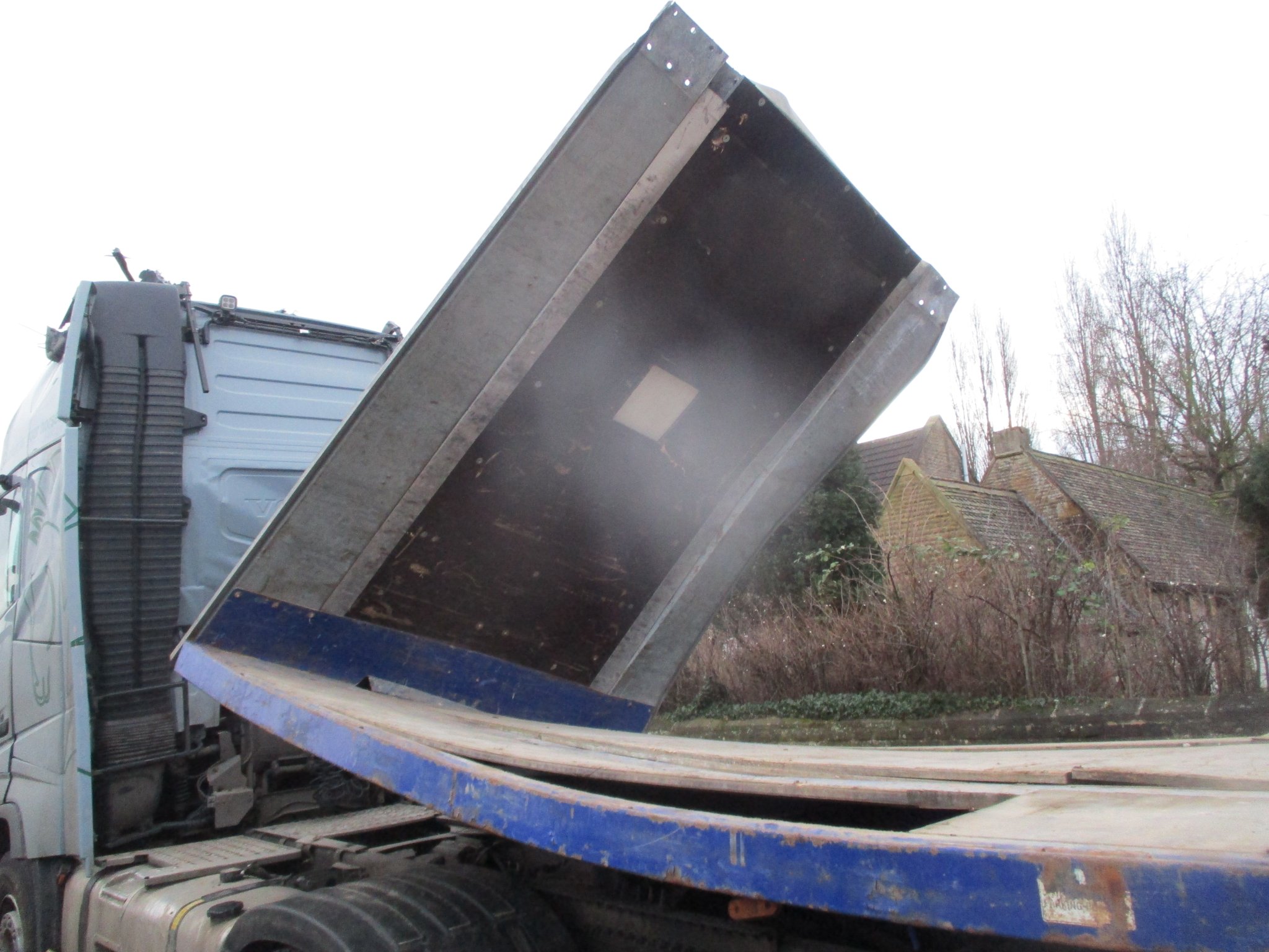

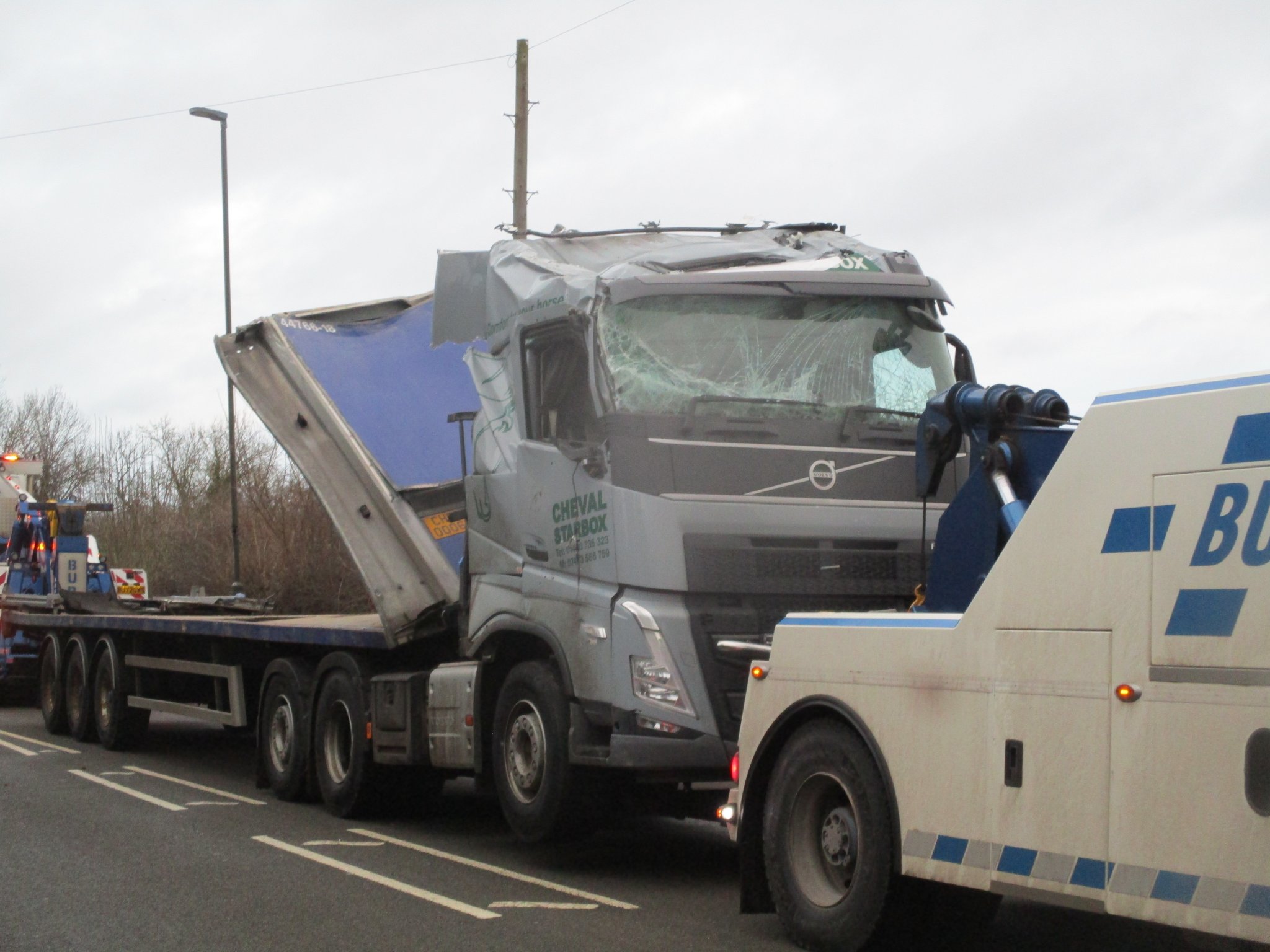

With heavy items with fixing points such as a speaker driver I screw it to a bit of pallet wood so that the wood is the same size as the base of the box. Some drivers may need spacers but it stops any bits of packaging getting into the cone where it may dent the dust cover.
When mail bags were shipped by train you used to be able to watch them loading and unloading the mail car.
The throw distance was the width of the platform plus the width of the mail car.
The new throw distance it the from the tail gate of a truck yo the back of the cab.
Wood survives traumatic shipping even better than the truck that is carrying it.
Deroofed!!!
