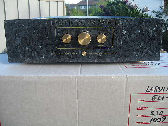

Does anyone know how, where to anodize already anodized aluminum knobs ?
They're black but need them to be gold. I guess stripping off black color comes first. There are anodizing kits online but I don't want to pay an arm and leg for changing the color of small knobs 25mm and 35mm in diameter.
Maybe someone has already such a kit at home ?
Willing to pay for a good service 🙂

It is easy to remove the anodizing, lye will do it. But the black color most likely is a dye used under the finished surface. You are better off starting with natural aluminum. Most folks offer the same knobs in both colors. My anodizer charges $45 minimum. The idea of how to anodize is simple, getting good results is not.

This is an old integrated amp, they ceased production ten years ago. Old but so far I have not been able not find anything better and I went through many.
