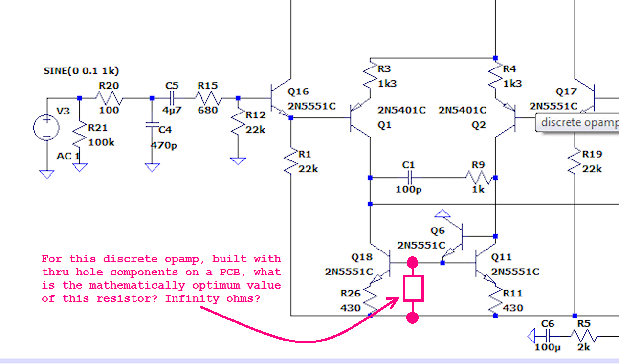

Heres another discrete OPAMP
Lets remove the offensive Q6 and replace it with a jumper. Probably this transistor is the bane of IC chips

In the JFET configuration, they are completely useless (and I might argue that detrimentary). In the one with the two BJTs, the first BJT is an emmiter follower, it should provide higher input impedance.What is the purpose of Q16 and Q17?
Ed

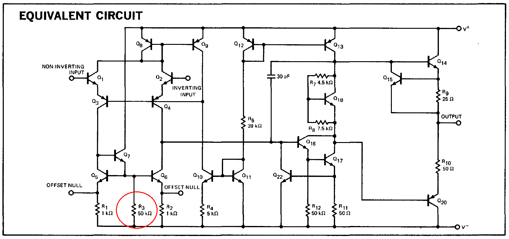

The people who designed the uA741 opamp integrated circuit in 1969, had a similar 3 x NPN current mirror to post #1's Q6-Q11-Q18 .
But on the uA741 IC, emitter follower transistor "Q6" is provided with an resistor from emitter to negative rail. Unfortunately the schematics attached to post #1 of this thread, do not include any resistor from Q6 emitter to bottom supply rail. It's not a match.
I would like to ask, why is this? What mistake did they make in the uA741, which this circuit repairs? What is the mathematically optimum resistor from Q6 to negative rail? Infinity? 2E7? 2E6? 2E5? some other number?
Thank you

Thanks, it was probably for stability or linearization. A lot of work was done in that golden age, they also had to use exact tolerances to have nano and pico DC offset valuesThe people who designed the uA741 opamp integrated circuit in 1969, had a similar 3 x NPN current mirror to post #1's Q6-Q11-Q18 .

Hi Mark am sorry I took so long to answer your question. There's a way to calculate a suitable resistance. In this case 22k to 30k should work just fine. For OPAMPs there may be stray capacitances on the die,The people who designed the uA741 opamp integrated circuit in 1969, had a similar 3 x NPN current mirror to post #1's Q6-Q11-Q18 .
Thank you

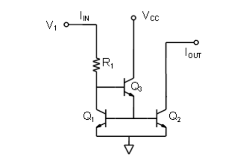

Any two conductors that are separated by a dielectric form a capacitor. It doesn’t matter if these conductors happen to be placed on a semiconductor wafer or if they are traces and planes on a PCB. If you look at certain components (such as coils) or the surface of a typical PCB, it’s easy to spot some pairs of conductors that will have some capacitance.
Another consequence of adding the emitter follower buffer is, in general, a loss in the frequency response of the mirror. Transistor Q3 is potentially operating at a very small current of 2IB. If there were to be a significant capacitance to ground at the base connection common to Q1 and Q2 the current available to discharge this current will also be small equal to 2IB. But the current available to charge this node is potentially equal to ßQ3IIN which is very much larger than 2IB. This asymmetry in the charging vs. discharging current available for this node in the current mirror can lead to very undesirable response to fast changes to IIN.
A Wilson current mirror would require all transistors have the same current gain ß.
Just because the uA 741 designer chose to perfectly match his R3 and his R12 {uA 741 schematic in post 12}, and then to make both of them 50K, doesn't automatically mean that 50K is the best value for your input stage with your bias currents.
So what IS the best resistor value for your discrete opamp? Assuming you'll build it using thru hole components, on a standard PCBoard made of standard FR4 expoy fiberglass.
