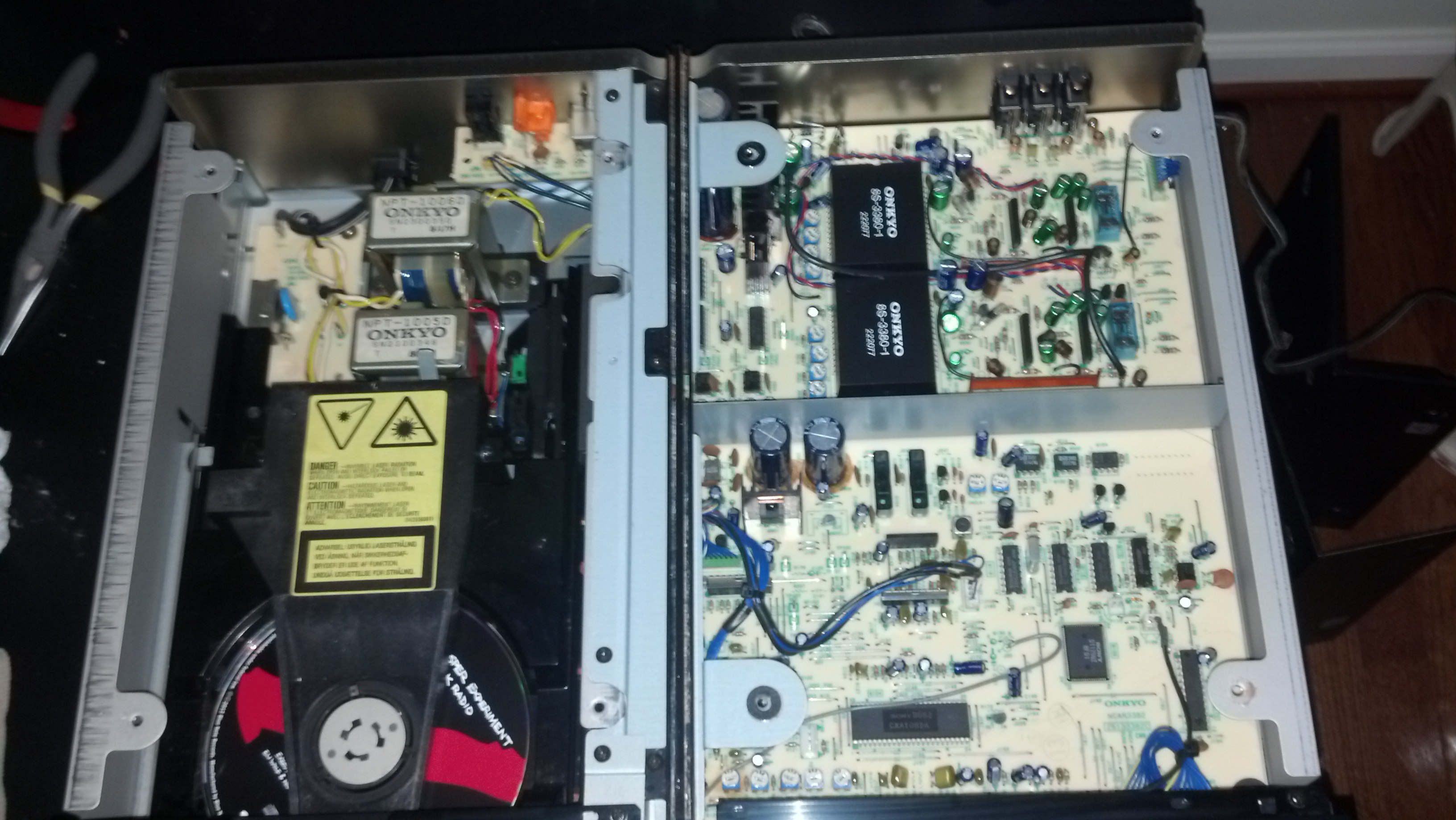

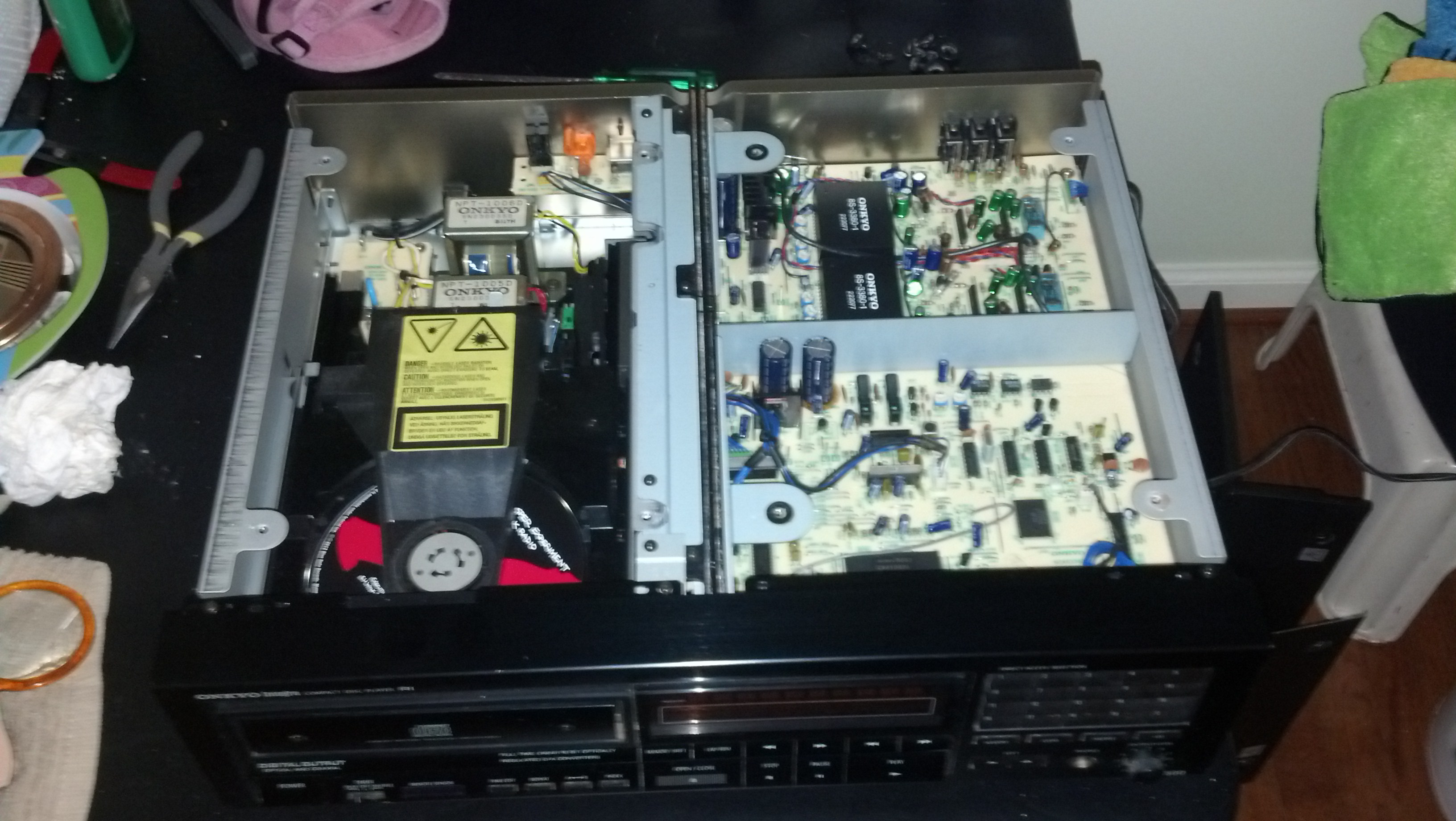

Found a DX-7500 in a yard sale today. Paid $5 for it...
Cosmetically its in very good shape...I see ones like it selling for $300 elsewhere.
Plugged it in expecting issues...and there are some.
Transport needs lubing,...it doesn't open or close all the way without a little help... easy enough.

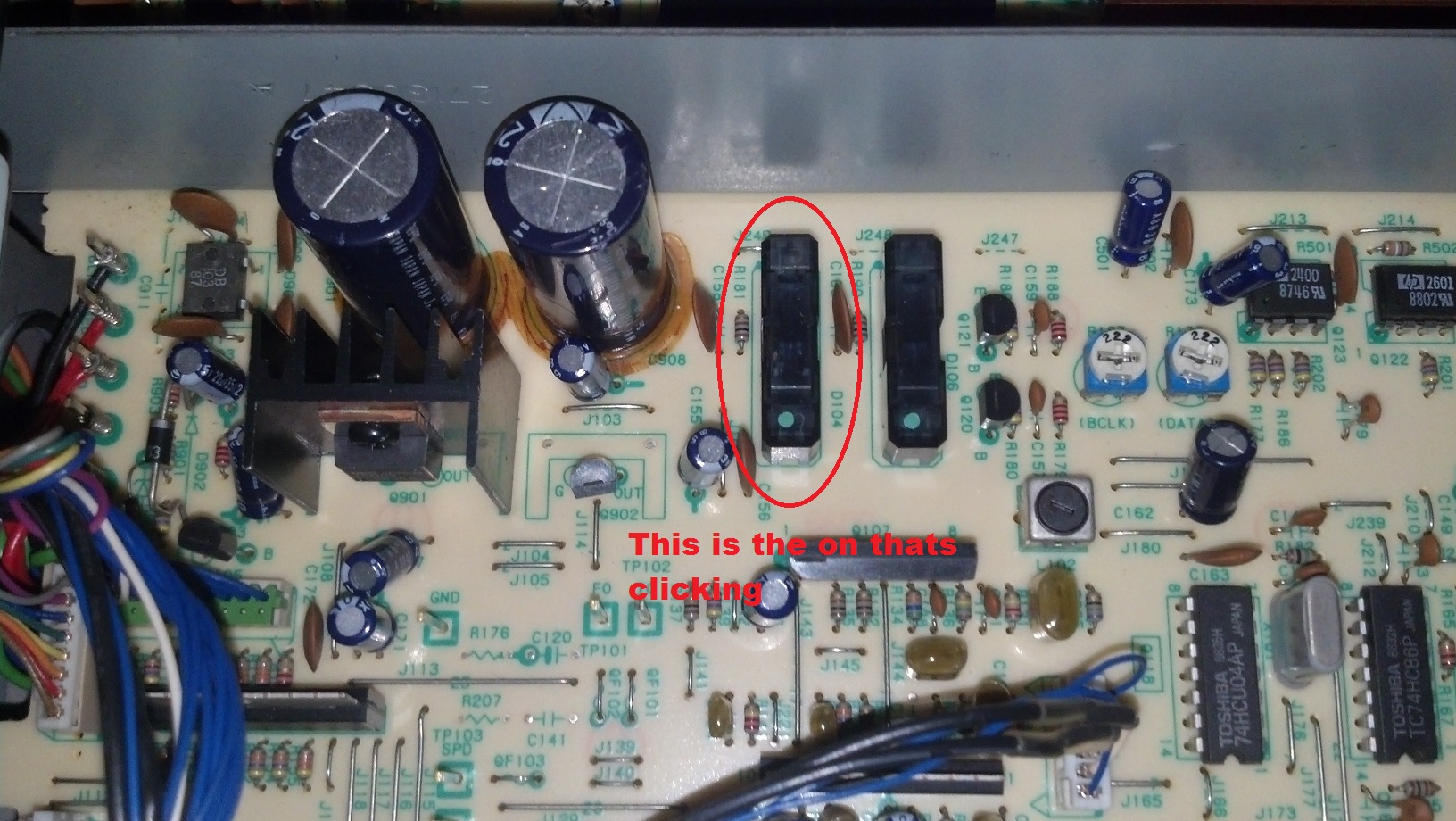

My question is around a clicking (relay?) sound coming from the mainboard and a Diode that goes off/on in response to the clicking. There are 2 of them on the MB (D104 & D106), and its the left one (D104) that goes off/on in time with the (what I will call a relay sound) relay click sound... In looking at the service manual, these diodes (FCNE-S-001G) are part of a Photo-Coupler circuit. I also notice that when the diode is lit, the CD is assumed being read (track counter is moving), with the click sound, the diode goes out and the track counter stops.
I'm trying to save myself some trouble shooting if anyone else has had this happen and know what the offending component(s) is/are. Is it an issue with Q124 (TLP5212GB) or the diode itself?....or something else?
I've attached some pics for reference. any help is appreciated!

I had the same problem and I just solved by cleaning the lens and the calibration of the laser (I adjusted with the trimmer resistance increasing it from 930 ohms to 870 ohms)
