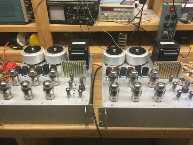

The big mono blocks use two AS4T430 in parallel, and two little ones under the chassis. Traditional OPT (1650W). The little amp really sounds nice - and has no global feedback.
They are not really a 115V primary - even the spec tables show performance (loaded and unloaded voltages) at 120. Just design with these values in mind.
Ive only used their power transformers. Even turned around as tube output trafos. They work well when used within their design flux density (Ie, keep the speaker output voltage at or below rated secondary voltage). I’ve got it in the plan to run some of the big (1600 to 1900 VCT) units with the 120 as the speaker output. Early experiments say it will work, but far to early to see if reliable, or if the HF performance is good enough. Plenty good for bass and mids, and it will be 3 way active. If they wont properly run tweeters (2” CD’s) then there are always traditional alternatives for the HF band.

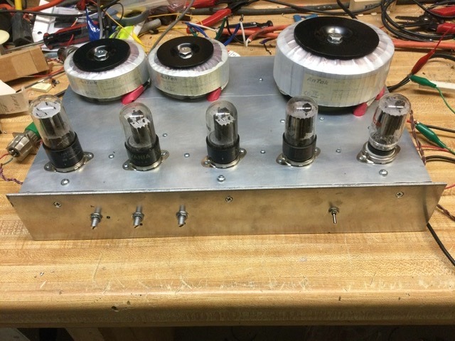

I've used a couple of dozens of Antek power transformers and just recently started using their PTs as Push-Pull OTs. They're ugly but work like a champ! My daily listener is a MOSFET pre + 6360 PP output, no global feedback that is amazing. I use the AN-0206 as OT with secondary in parallel. Can't say that I've measured the FR, but to my ears, good to 17k, there is nothing lacking. I get covers from ebay that I like better than the cheezy antek covers with acorn nut on top. YMMV.
