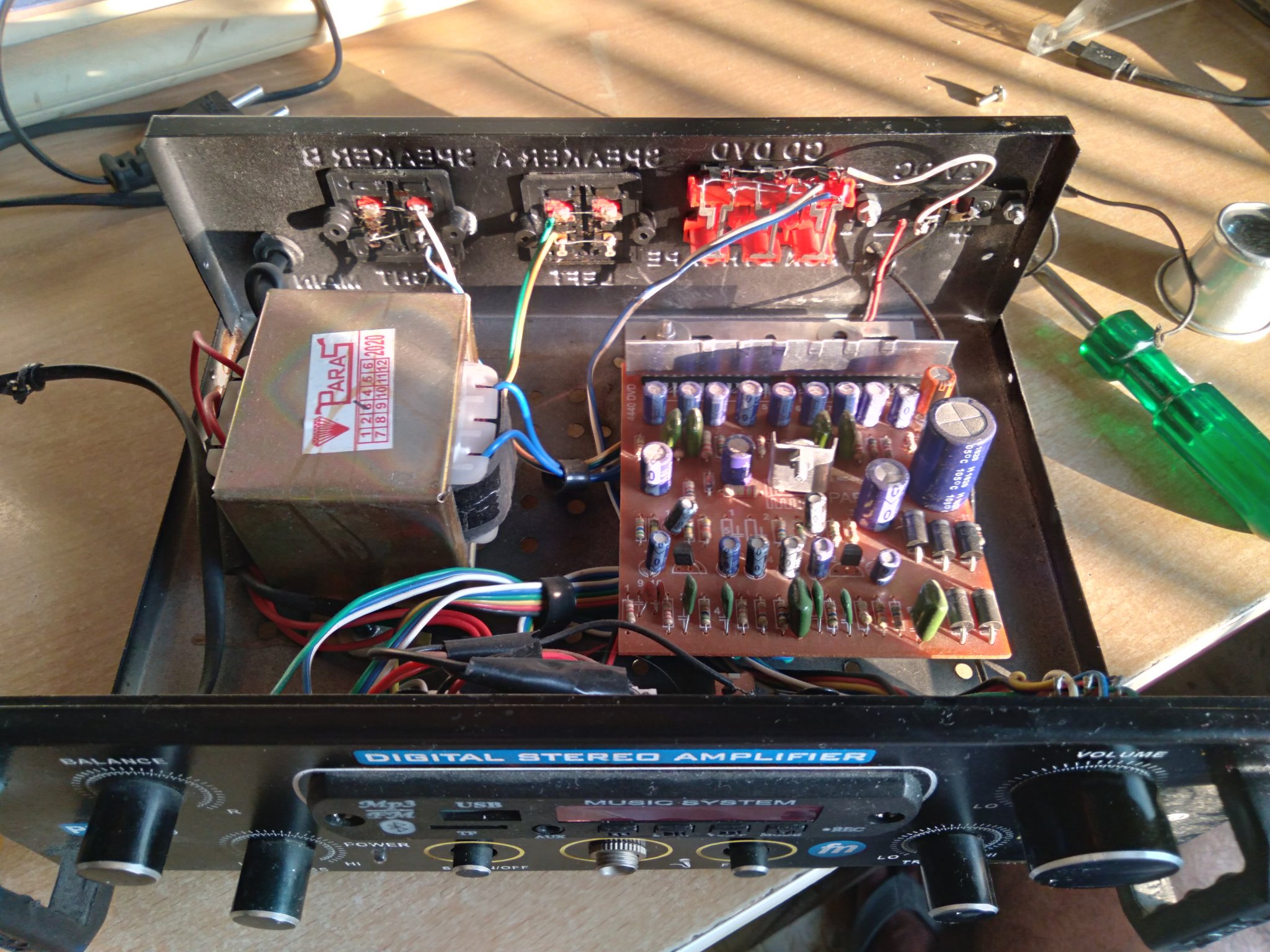

The FM module is good, for its price. Reception is clear.
It also functions as pre-amp / selector, and price is about $1.5.
They work well enough, 7805 is used to feed them off the amp
supply.
Some have been used to add SD card / USB / Bluetooth / remote operation to older systems which do not have the functions, being from the CD and even cassette era.
The amp is selected from several PCBs, as per supply and output watts.
The cheapest here is $10, it is a complete unit with 4440 iCs, 12V internal transformer and so on, it can be used with a 12V battery also, so used a lot on buses.
Higher outputs are available in 2030 / 1875 variant, 2955/3055 variant, STK 4141 variant, and Mosfet, in increasing order of output.
Even 3116 and 7297 may be available.
Both types are sold, complete amps, and 'kits' (populated PCB, ready to connect).
There are some suppliers in Delhi, you can go through their websites to get some more information.
