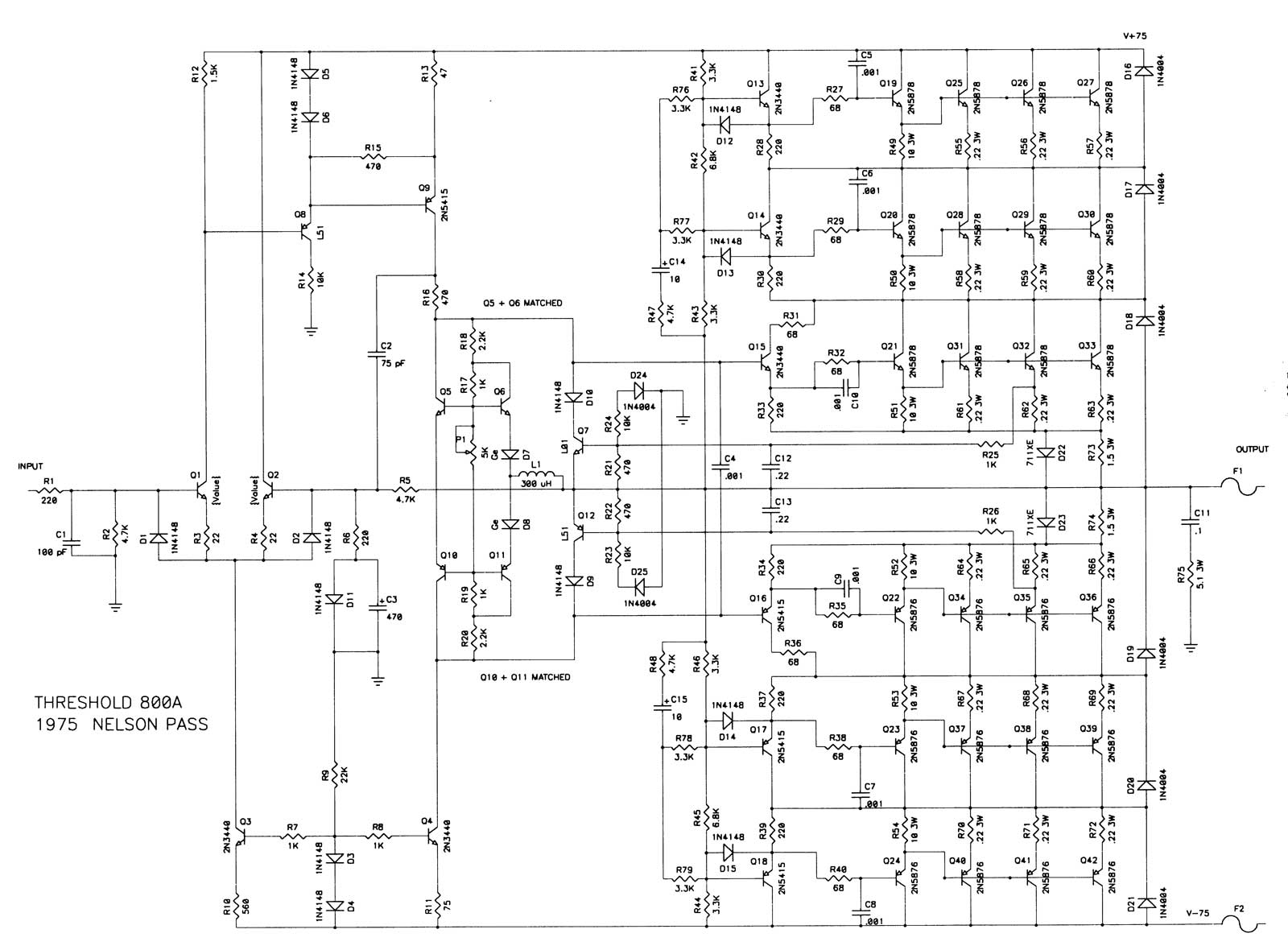

Copy what the high end crowd did in 1974 with rather cruddy BJTs: stack transistors in series to cut down the voltage stress; connect several of those stacks in parallel to reduce peak current, peak power, and SOA stress. The most famous example is James Bongiorno's "Ampzilla". Here is another example.

Using a bunch of 60 or 80 volt transistors, which was all you could get back then, except unreliable switching types not available in PNP at all. These amps suffered from dynamic balance issues - at high frequency it didn’t divide evenly anymore and BANG. Especially if it broke into oscillation like the Tigersaurus did. I’ve done this successfully to extend SOA and allow +/-125 volt operation with MJ15024’s, but an individual device will actually block 250 volts for a few us at a time, so square wave drive won’t blow the amp. Those old 80 volt epi-base devices won’t take it. MJ4281’s will, and the fT is pretty high.

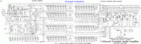

Of course not new in 1974. 11 years before that, Burwen published 64 devices (all PNP!) series/parallel for 1,000 Watts. He did not take series real far: bridged on +/-15V. That made impedance awful low but his app allowed an output transformer (even so, lead-inductance ate his sizzle). All this in a rack the height of a man. (What would it be today, 1U?)

There is a good reason several commercial designers abandoned vertical mosfet outputs and switched back to more expensive bipolar.
