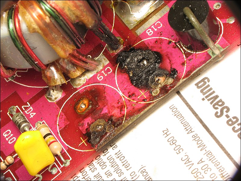

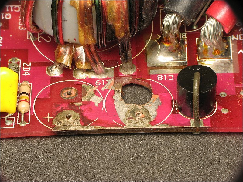

You should be aware that the capacitors in these amps leaked doing significant damage where the circuit board has to be cut away to allow the amp to be used. The example below shows a smaller amp but the damage is similar.

Hi, Thanks for your reply. It sounds like after seeing your pictures that,I should have the amps opened up and checked out fully. As for the sound quality comparison of the two amplifiers. Have you personally heard the hifonics zeus on a 2 way or 3 way set up,and do you think because of the extra headroom,I will get even better sound quality than the alpine 3544 amp is putting out.
