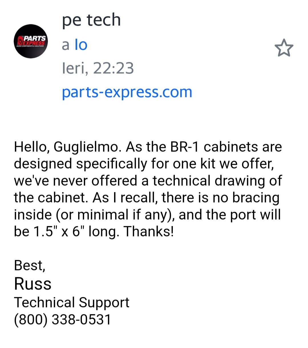

I am interested in using the BR-1 cabinets for a personal project but to do this I would need a detailed drawing of the interior spaces and the exact position of the reflex in order to organize all the internal components. Where can I find it since it is not in the manual?

Parts Express reply:

Good to get the reply from PE: I'm assuming you're buying the finished BR-1 cabinets and not making your own?

Just be aware that the BR-1 tweeter cutout is for the DC28F-8. Its flange diameter is 110 mm which is larger than the standard 104 mm. I made a trim ring to fill the gap when I used a standard sized tweeter. I also used a woofer slightly larger than the DC160-8 (165 mm flange diameter) so I had to enlarge the woofer's flange rebate.
Pending Dennis' reply to you, I think you could use the Classix II cabinet, with the BR-1 port (i.e. 1.5"x 6". The Classix II port is 1.5"x 4").
The external dimensions are so similar I can't see that making any difference: BR-1 is 36h x22w x28h cm, Classix II is 38x 21.5 x29cm. 0.5cm in baffle width shouldn't really make any difference to the sound, I think, at least, with my hearing. Just make sure the tweeter centre distance is the same from the top of the cabinet as in the BR-1.
Once you factor in that the CII cabinet uses slightly thicker material (3/4" vs 5/8"), internal volume is almost the same.
However, the tweeters in the BR-1 are offset from centre, and that does make a real difference. You should be able to get reasonably close by making a scale drawing from the manual photos and the dimensions given.
