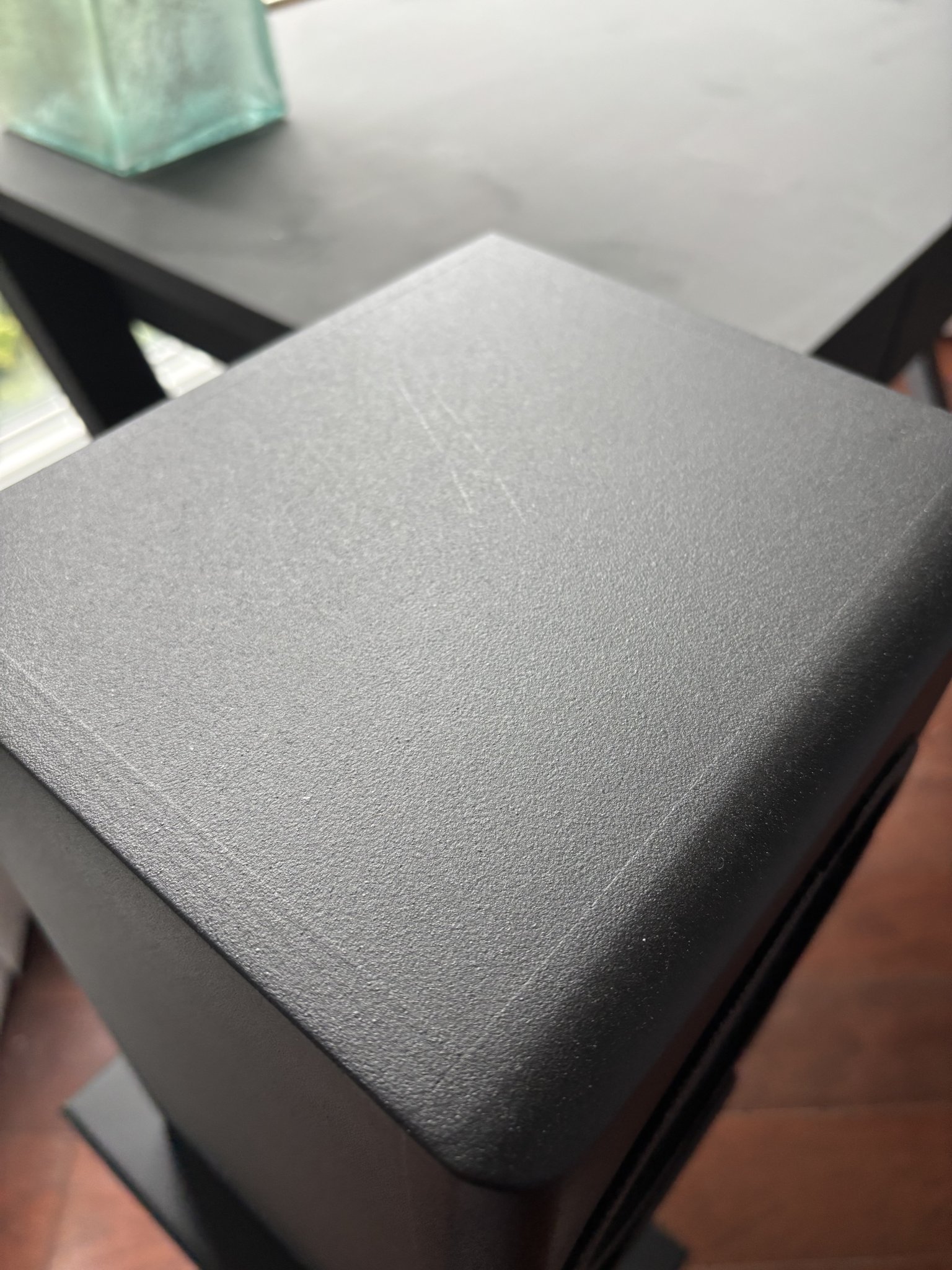

Does anyone know a reasonably-priced speaker cabinet painter in the GTA area? I want to get some baffles painted with spray-grade Duratex.
I just need a reasonably uniform coat. I don't need anything fancy.

If you use a foam roller you get a pretty smooth finish. I have rolled and sprayed it and the difference wasnt that large.
Well, maybe, but the samples AcryTech sent me tell a very different story. The rolled on sample was much more textured and much shinier. I particularly dislike the extra gloss.
This was sprayed on with a 2mm tip and diluted the max they recommend. I don't think you can can any smoother than this. I used duratex for my surrounds, but for the best look I use Lamp black from General finishes (this paint is SUPER delicate, I love it but it marks very easily).
