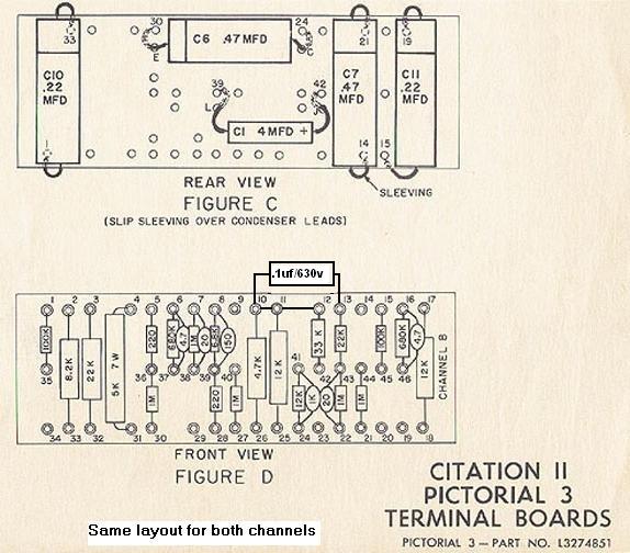

I may have just missed it but am kind of surprised there's not a step by step HK Citation II Build. Is one on audiokarma but it's missing all of the pics. Yes, very aware of McShaneDesign and while great info, I'd so like to find where someone documented every step as if building it.
I have one that someone started to restore and then became an unfinished project. They stripped everything off of it and repainted the chassis, installed new sockets and that's about as far as they went. I have the build manual and pics that go with it but while I can solder well, am very ignorant on tube gear so if someone took the time to do a build tutorial on one of these, man I'd love to find it. Plan on doing Mcshane upgrades but sure a step by step would help me tremendously.
I need to get started on it soon or will end up having to sell it

Have you communicated with Jim McShane and Mike Samra? While the "paint by numbers" guide you want may not be available, helpful hints to get and keep you going will forthcoming.
I'd avoid double work and assemble the PSU bracket with Jim's stuff, from the outset.
Definitely read, with great care, the "sticky" safety threads at the top of the page.

The original instruction manual shiild have step by step assembly instructions. No there's not a photo of every single connection but that really shouldn't be necessary. The manual is quite clear on what to connect where and in what order. But he has some hard to find replacements for meters and a solid rep for tube sales.

Getting into tube technology by building something of this caliber, even as »painting by numbers«, means a very, very steep learning curve for an unexperienced. Maybe well too steep. I'd start, and I think most of us here have started with a simple and unexpensive design.

I guess I have to jump in here. Jim is probably the leading person for the Citation. I'd tread a little easy when asking for help and in the same breath raising heck. I'm sure your going to find a lot of help here on the forum. I've never tackeled a citation but its nothing I wouldn't take a shot at. Arm yourself with a schematic and simply put it back together. If you can read a schematic and own a VOM meter it can't be hard.
http://quadesl.com/pdf/cit2_pfacts.pdf
The also have a nice cap board.
http://quadesl.com/refurbishment/pdf/cit2_capboard.pdf
If it were me I would purchase some bare PC board material and some turret terminals and produce my own replacement board if there are none available. Most of the older boards on some of these amplifiers can have some heat damage associated with years of usage. Proper/better component placement can add to less and fewer maintenance stops in the years ahead.

hence my hoping someone documented a build. I don't claim to be an expert but I repair and upgrade my own ss gear and a long long time ago before retiring for disability, I used to repair inertial guidance systems for the minuteman missile and various aircraft so I do know my way around a soldering iron and troubleshooting using schematics.Finally also keep in mind that many of the original parts will have to be replaced with more modern ones that are different than stock. So even if you have the factory step-by-step manual you'll often have to use different parts than are described/shown in the original assembly instructions.
I've read through the assembly manual probably close to a dozen times and feel pretty comfortable giving this a shot.
Time is a consideration as far as cutting my teeth on not as involved projects 1st so basically have 3 choices
1. pay someone to build it for me - not economically feasible at this time
2. sell it for a pittance - what's one worth that has been stripped down, $400-$500 maybe.
3. Build it myself - I used to have a Mingda MC34ab that I loved, lost it when divorced and think of this as my opportunity to replace an amp I figured could never be replaced
I'm jumping in with both feet and choose 3

Since you worked on sophisticated electronic systems, I don't think you're giving yourself enough credit. Work slowly and carefully. Things should work out just fine.
A Cit. 2 in good repair is a leading contender for "best" amp. The "iron" is stupendous. While I don't know the Mingda, I do know the Cit. 2. I think you are going to be very happy.

Just because it is posted on the internet doesn't mean its accurate, truthful, or even related. You should have no trouble building the power supply and wiring the heaters. The hardest part will be the turret board. It is a 3 dimensional construction with both the top and bottom of the board being utilized, which can be confusing. I believe the coupling caps go on the "bottom" of the circuit board. Most the Cit.2 were kits so, following that or farming out the circuit board if you get in trouble would save you from shipping the whole thing. cheers.
The Citation II is an all-pentode, U-L rigged Mullard 5-20 with a wee bit of plate-to-grid FB included. It is not that out of line or complex. It has no active regulator for the screen supply...or any number of other complex tricks. It is a solid amp, and it should be quite possible to build from the kit instructions as long as you're properly scared of it to be careful.
