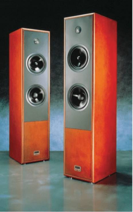

In this box, why is there such large driver spacing?

Not exactly sure why they spaced them like this. I'm pretty sure they were separate chambers the lower units tuned more for the bass and the upper, mid/bass, even though there were no crossovers. They were triwired as well, so each driver could benefit from its own amplifier, 3x naim NAP250s, these were designed on NAP250s if I'm not wrong, I know the slightly earlier es11s and 14s were for sure. At least with three separate supplies I suppose you could if you really wanted to balance the drive units sound with different gains on each amplifier. Although I never thought they were unbalanced ever even with one amp. They did need a lot of space though for relatively small and compact speakers, positioning was more critical with these speakers than most. Twin rear ported, one on the lower chamber and one on the upper.

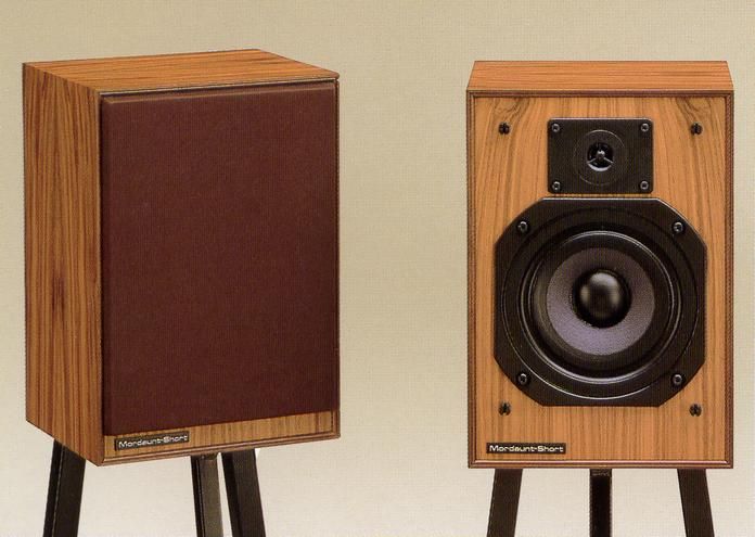

I have a pair of Mordaunt-Short MS100 speakers from the late 80s.
The mid/bass driver runs 'full range' and relies on its natural roll-off, initially 6dB/octave above 5000Hz, to blend in with the tweeter.
Any attempt I've made to low pass filter that driver simply sucks the life out of the reproduction!

Heresy alert! I run the replacement tweeters via a 2.2uF cap in sympathy with the MS100's minimalist vibe!

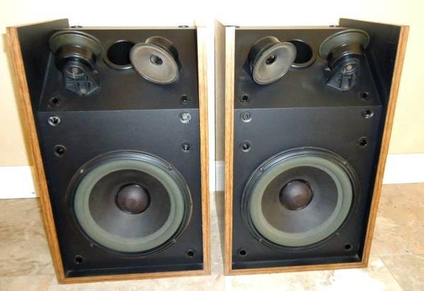

I encountered a similar, airy minimilism when renovating my friend's Bose 301 Series 2 speakers.
P.S. I think Jim has just summed up the design philosophy of the MS100. It doesn't have a poly woofer, but it does have a real wood veneered cabinet which helped justify its price! 😉

The MS100s were certainly promoted for their minimalism....they were not even promoted as having minimalist crossovers as a feature.
A "pseudo-active drive principle" is how MS described the directly coupled mid/bass driver.

I notice the top and bottom speaker drivers look slightly different, with the top having slightly smaller dustcap. Maybe the top is for mid and bass, bottom for bass only. It would create a baffle step like freq response, a 2.5 way I think that's how it is called.
