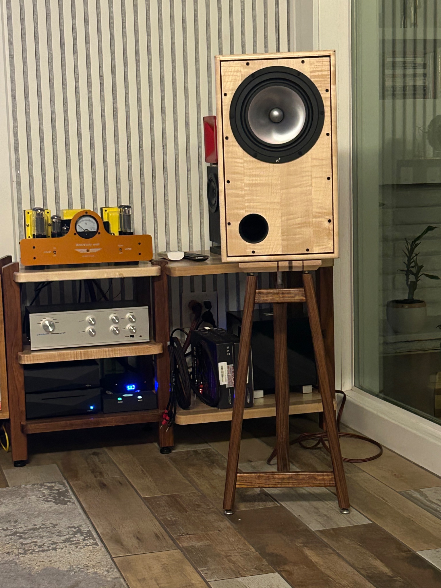

I had them playing for about 30 hrs.
I really don’t like them. They’re too bright and not enough lower frequencies. Maybe they need more brake in time. Maybe 200-300 hrs. I was anxious to listen to them. Or maybe the 30-liter cabinet it’s too small. Tomorrow I’m going to disconnect them and let them play in the garage for 10 days non stop and see how they sound then.
Please do share your run-in results, though I wouldn't expect a miracle. I was the first to buy them in China and listened for a couple of weekends straight, totalling about same as you have done. After a few hours very high frequency came in (sound opened up) but otherwise the mid-to-high wide range had the characteristc (likely intented for no-toe-in) Mark Audio hump ~7-14khz. By pointing them up toward the ceiling I got a natural, tonally flat response, omni-directionally. Off-axis 30-45° flat to 15khz was confirmed by umik-1/REW. So maybe try no toe-in at all. As for bass, 30-hour run-in was not enough, but the MA200 reached down to produce "basic requirement" 42hz in my 17L TLonken (6.25:1 tapered 1.5m-line effective quarterwave resonance ~40hz). Just listened -- audibly deep though "dry" rather than "full" sounding bass. Your 30L ought to do better loudness-wise, if made into a TLonken (folded tapered ML-TL).I had them playing for about 30 hrs.
