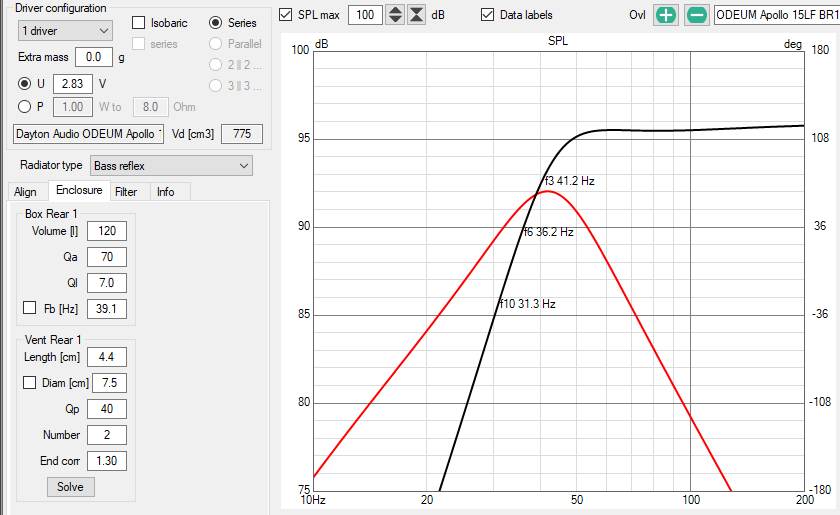

Their lower Qts values do tend to reduce the low-frequency extension that's available in a close-to maximally-flat low-frequency alignment. It's the natural tuning that can be obtained using their Thiele–Small parameters.These new Dayton woofers look promising, although having a lower Qts.

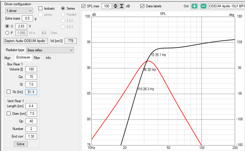

Here's a VituixCAD simulation of the 15LF in a 120-litre enclosure.
Increasing the enclosure volume to 180 litres gives us some extra bass performance, albeit with a shelved response function.

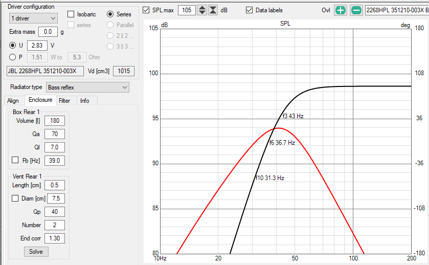

The VituixCAD simulations for the JBL 2268HPL driver mounted in a 180-litre vented cabinet are shown below. The −3dB point is at a highish 43.0Hz, which is just barely adequate for reproducing the lowest note on a bass guitar with some fidelity. Still, it would be capable of a decent amount of SPL at that frequency. But it is not really into subwoofer territory with this particular alignment.

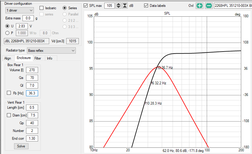

If we over-volume the more standard enclosure by 50% to 270 litres, the following response is obtained. The −3dB point has been reduced to 36.7Hz, but there is now a step-down in the bass response of about 0.5dB (which seems relatively minor).

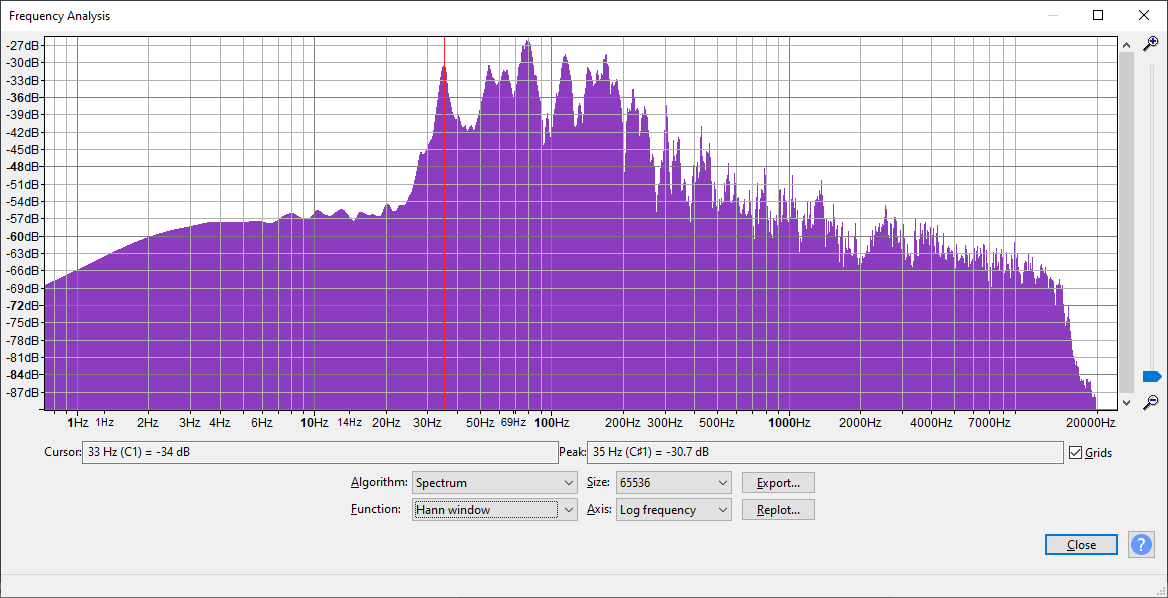

I've done a frequency analysis of the first portion of the audio that's in the YouTube video. Below are the results. The recorded music seems to have plenty of low-frequency energy at 35Hz, and also between about 52Hz and 85Hz. I wonder how low in frequency these 220-litre vented boxes can go? Those Sica 8 M 1,5 CS midrange drivers have a very high sensitivity of 98.7dB.This is an experienced diyer he makes acoustics for people to order. Midrange speakers are doubled sica 8 M 1.5 CS, tweeter is also sica, the volume of the box is 220 liters:

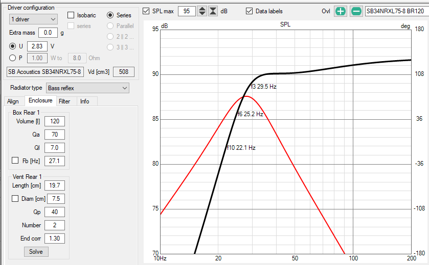

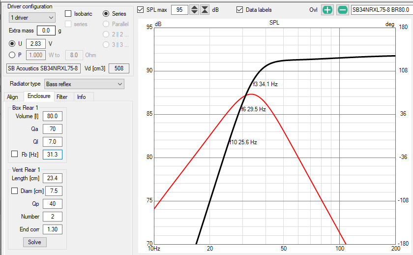

The VitiuxCAD simulation for the SB Acoustics SB34NRXL75-8 woofer in an over-volumed 80-litre vented enclosure (160 litres for two drivers) is shown below. The −3dB point is 34.1Hz, with only a 0.5-dB step-down in the bass response.As I said before, the SB34NRXL75-8 and its neighbor models are very good cone drivers which don't cost as much as other higher end woofers. I would need 2 of these per side...
The above is still not subwoofer territory. It is only able to handle the 30.9-Hz lowest note on a 5-string bass with 6dB of attenuation. To get down to 29.5Hz at −3dB would require a 120-litre enclosure for one driver, which is shown below.

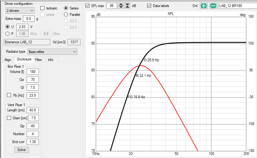

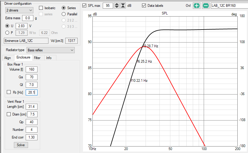

Those are nice drivers. Below is the VituixCAD simulation for a pair of Eminence LAB 12 drivers connected in series mounted in a 180-litre vented enclosure tuned to 23.9Hz. The −3dB low-frequency cut-off point is 25.9Hz. The −6dB low-frequency cut-off point is 22.1Hz. To reduce chuffing, there are 4 ports that are each 7.5cm in diameter, which keeps the vent air velocity below 17m/s at 200W (re 8 ohms) input.You will need four of these: https://eminence.com/products/lab_12#frequency-response
For comparison, below is the VituixCAD simulation for a pair of Eminence LAB 12C drivers in a 160-litre vented enclosure tuned to 28.1Hz. The −3dB low-frequency cut-off point is 28.7Hz, while the −6dB low-frequency cut-off point is 25.2Hz. To reduce chuffing, 4 ports each 7.5cm in diameter are used.
