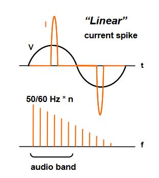

Hi
first page of the white paper
can you explain:
Current is following the voltage at he given load R. Why is the current rising at the top of the voltage? i remember that the maximal "event" is at the "zero crossing"
chris
That refers to the offline convertor. It uses a stage of Power Factor Correction. Note reference to 50/60Hz.
ah..ok thx

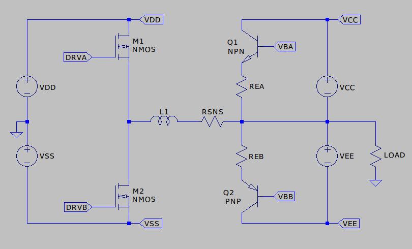

Conceptually it is not really all that. Without referring to the patent documents you end up with something similar to that pictured in the attachment.
In respect of patents they seem to have been granted in the US but have fallen over in the EU. This is not unusual.
The rest is just a few sums and the implementation. Post the schematics, pcb, gerbers, BOM and pick and place when your done.
