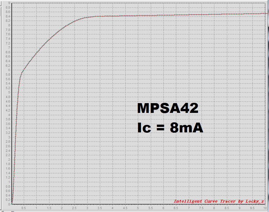

Finally the red MPSA42 might want to be a different part number, the 'A42 suffers from relatively severe quasi saturation. Measured IV data attached.
