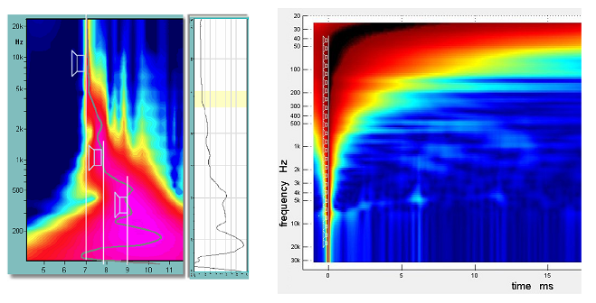

Here as a couple of graphs from the website
TDA 3D presentation (decay)
DFR (group delay per section ??)
![a8c59cf857443f7bbb95a66e26f61c2f_f143.png](https://aplaudio.com/conc2/files/cache/a8c59cf857443f7bbb95a66e26f61c2f_f143.png)
![7914a917fb6aabf9bc7697f7e120d18d_f145.png](https://aplaudio.com/conc2/files/cache/7914a917fb6aabf9bc7697f7e120d18d_f145.png)

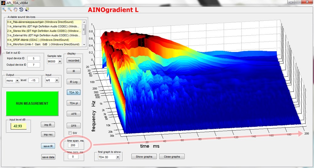

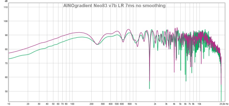

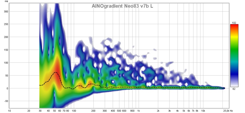

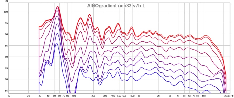

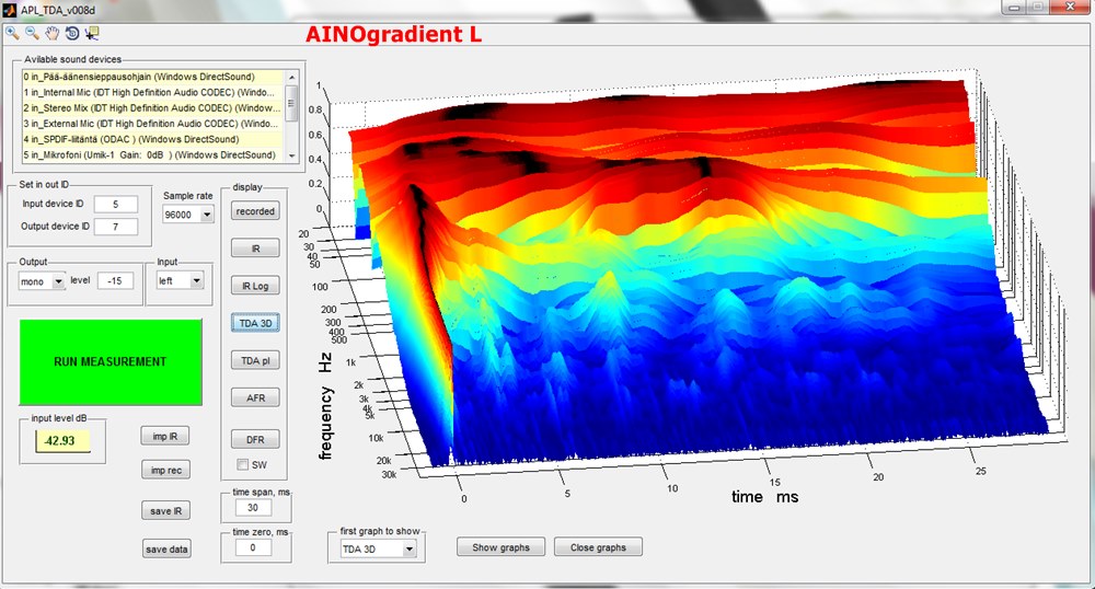

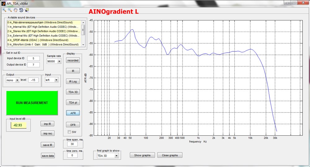

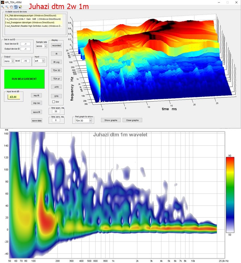

Okay, I two hours of my precious free time to get comparable measurements with REW and TDA.
Output: Laptop-usb-odac-analog-minidsp-amplifiers-speaker drivers(4-way AINOgradient)
Input: UMIK-1-usb-laptop
Measuring distance roughly 9ft (2,7m) LEFT speaker at normal position 2ft from wall (which makes the rising bass response) Microphone on stand at 3ft height 4ft from backwall. Sidewalls 10-15ft away.

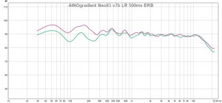

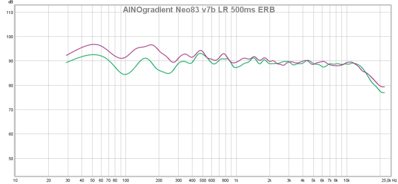

SPL response - Similar, if REW is set to 500ms and ERB smoothing

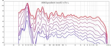

Wavelet vs. TDA3D analysis - Similar except for graphic presentation details
DFR TDA can show delays in a simple way - the room makes the humps

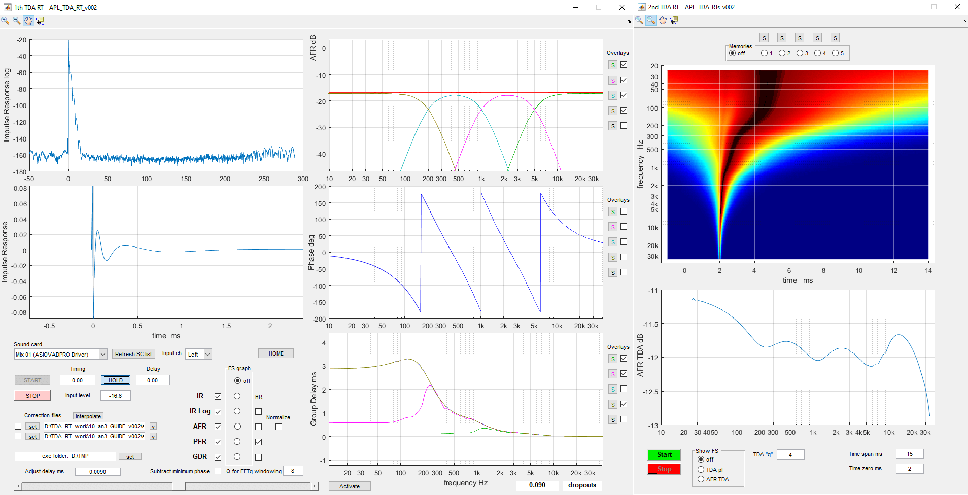

Some update to TDA
As you would know, it is very important to do basic loudspeaker`s measurements with confidence and our time is valuable.
Here is some contribution to that. Please meet the Real Time version of TDA program - 3 measurements per second, graph latency is about 0.5 second.
Take a look on short videos how to tune up the linear phase crossover in 2 minutes
and our usual minimum phase crossover in 3 minutes
You can get the demo version of TDA RT here: http://aplaudio.com/installers/APL_TDA_RT_v002_setup.zip
The installation and quick start guide is available here: http://aplaudio.com/downloads/TDA_RT_Installation_and_Quick_Start_Guide.pdf
Good luck,
Raimonds
