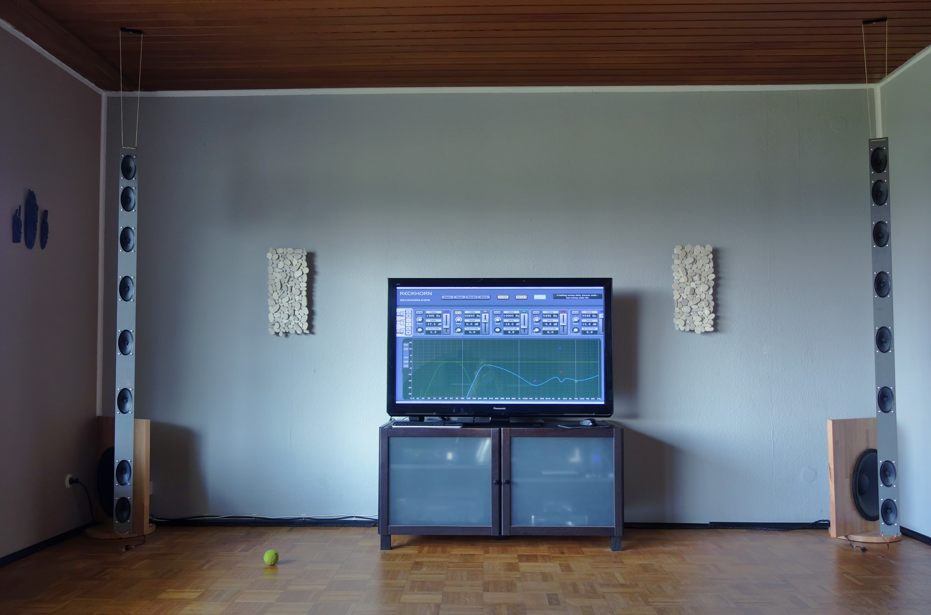

The room height is 250 cm
I wanted a line array that is at least 70% of the height and decided to make the array 180 cm high.
The speakers vertical dimension is 12cm x 8 speakers = 96cm covered by the speakers.
So there are 84cm left of my baffle
Divided spare room by the ruler length of 34 = 2.5cm
This "base unit" is multiplied with the golomb distances between the units,
e.g. from 0 to 1 = 1 * 2.5, from 1 to 4 = 3 * 2.5, etc.
Finally added arbitrarily 4 cm on top and bottom of the baffle just to have something to fix the thing somewhere.
The center of the array is at listening height.

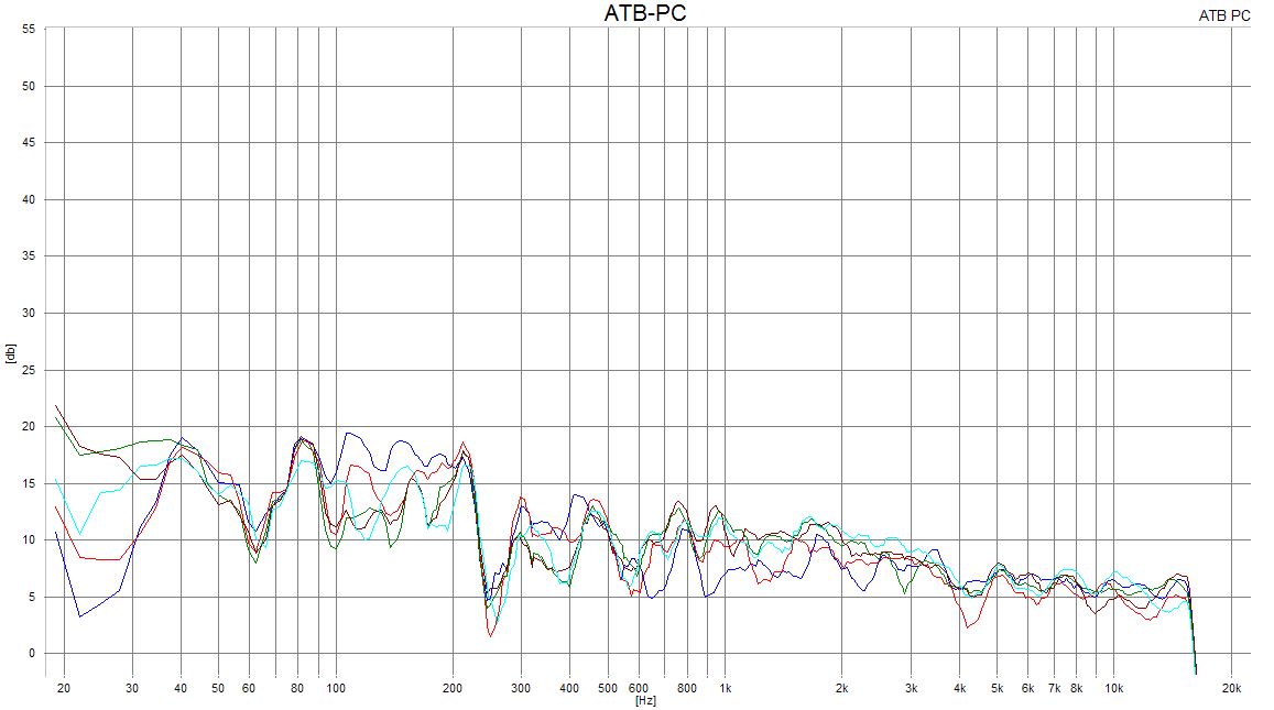

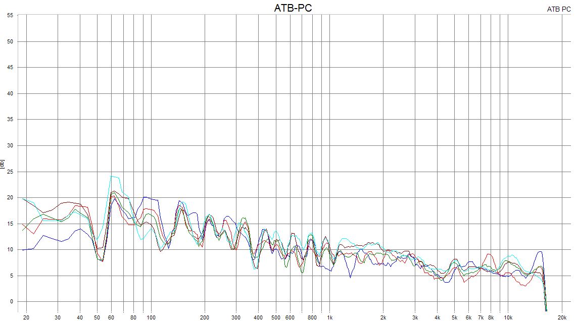

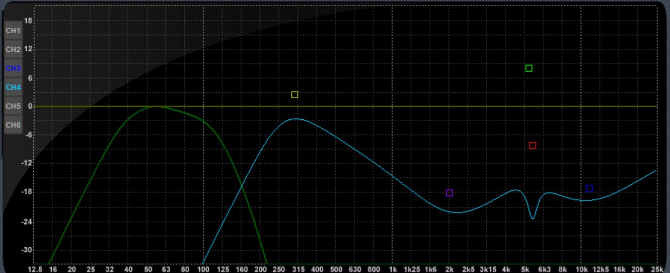

I attached the DSP settings and measurements at different distances and heigths
They show that the speakers melt nicely together at about 350cm distance which is my listening position.

Elnag, tell me more about those diffusers...
In fact these are no diffusors but two wall lights made of multiple small flat stones so that the light shines trough the open edges and also the back illuminates the wall
I do not know if they have any effect on sound. I know the walls could tolerate some sound optimization but I like plain clear walls.
Overall the listening room is a mess. There is a huge panorama window on the left reflecting sound as hell but I cannot use curtains because of an amazing view.
To the right the room opens to the dining room and kitchen so left and right are completely different which makes a good stereo reproduction difficult. Perhaps this is a reason that the line arrays work better here compared to single sources.

------ I like the result, but here are some downsights I experienced
Somebody wrote in a forum and thread I cannot remember that if a chassis shows some flaws and you put it in a line array you will get the sh*t back ten times, and that really need to be considered.
The SL breaks in a bit around 4Khz I think because of the vertical beaming of this chassis around this frequency. Also this is close after the first dipole peak so we need a compensation here. And the little dip
But around 5.5Khz the SL713 shows a peak in the plot that turns out to be a really heavy peak in the open baffle. I think this is result of resonance / trapped air between cone and basket, a thing that all small cone speaker show more or less when used in open baffles.
So now we got a dip at 4Khz directly followed by a peak at 5.5Khz which isn't a nice thing to compensate resp. that requires some considerable DSP
Perhaps a more sophisticated and expensive driver will be easier to handle here.
Overall, do not use a too cheap driver in a line array.
The Golomb thing gives the chance to save some money because of the lesser number of drivers that can be put in better ones.
