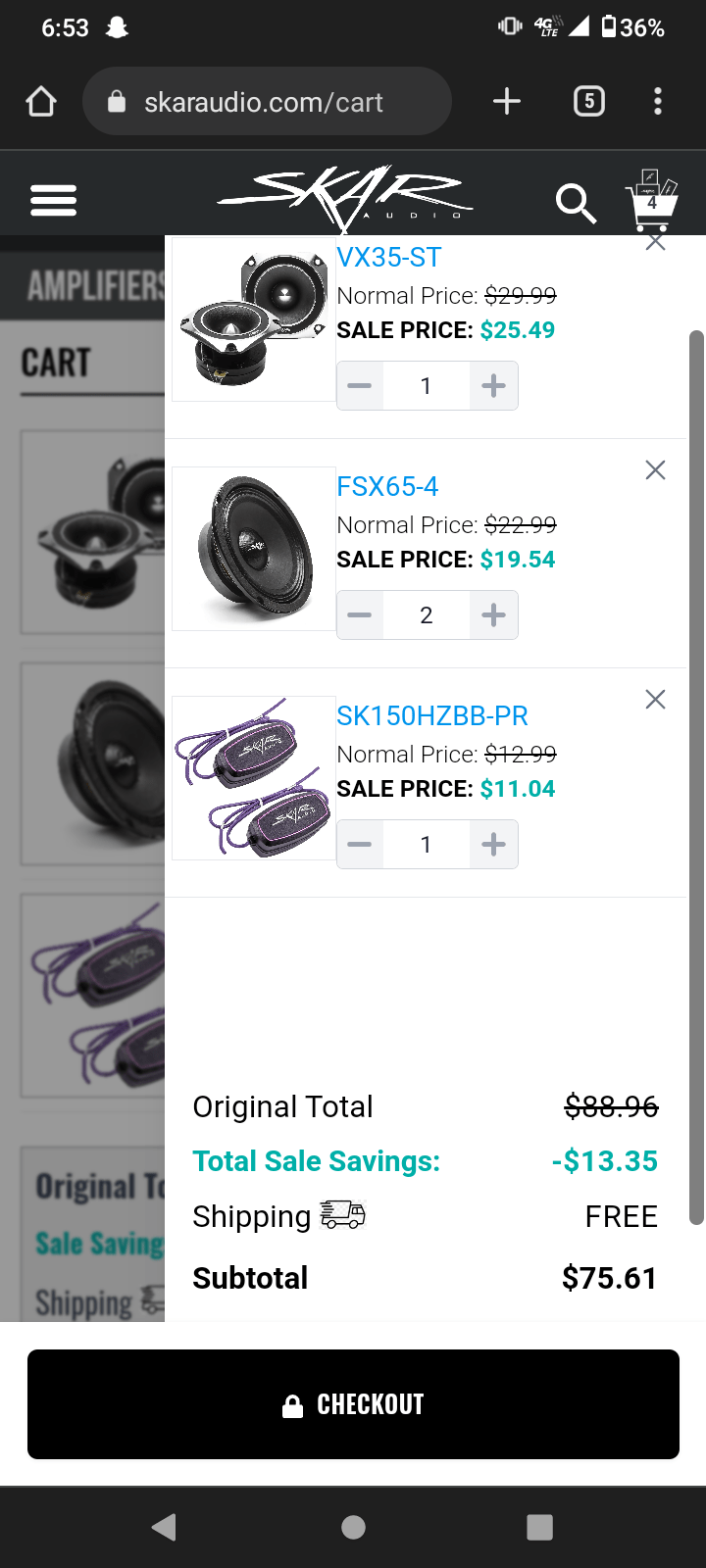

Hey all I'm trying to put together some cheap speakers for general listening in my garage. So far this is what I've landed on for the components
My question is what is the correct ohm rating crossovers I need? The frequency response for those mid ranges are like 100hz to 4k. I'm gonna put the crossover before the midrange to block out 250hz and below and then wire the tweeter and mid in series for an 8 ohm load. Do I need an 8 or 4 ohm?

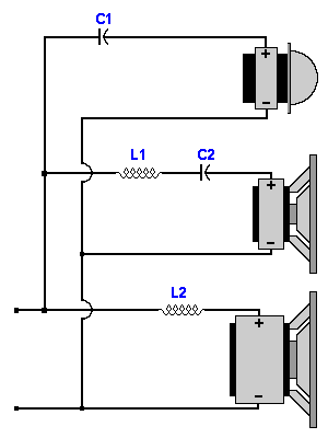

Welcome to the forum! It's best to make your own crossover to match the distinct specifications (presently unknown) of your chosen drivers.
Your idea of wiring the midrange and tweeter in series is non-standard, so I will assume your knowledge of crossover networks is minimal.
To run a 3-way woofer/midrange/tweeter system, you would use a 3-way crossover layout like the simple one shown in the attachment.
You can wire the crossover up using individual capacitors (C) and inductors (L) that are obtainable from Part Express.
If no one else chimes in with a suggestion, I can suggest component values to suit 4 ohm drivers and crossover frequencies close to those you mention.

I'm not looking for audiophile sound I'm going for cheap diy for my garage so I can listen to music while I work. All I'm trying to do is eliminate low frequencies that the mid should not be playing. I'm not looking for a 3 way set up that's why I'm wiring them in series to get the 8 ohm load for my amp. The mid bass will be in a separate enclosure and on a separate channel.
Wiring the lows and highs in series doesn't increase the impedance. Once you cut the frequencies away, they don't see each other any more.
Therefore, using an 8 ohm woofer and an 8 ohm tweeter doesn't make a 4 ohm speaker.. it will be 8 ohms.
In any case you seem to put more concern into impedance ratings in general than is usually necessary. There are other more important things.
Extremely bad idea. Drivers go high impedance at the Fs. Your mid might be working against a tweeter impedance of 80 ohms at Fs. Wattage intended for the mid may burn up the tweeter. Wattage indended for the tweeter will be burned as heat in the mid.
If you insist on buying these unspecified drivers in post #1, put a 4 ohm resistor in series with the mid, and another 4 ohm series the mid. A capacitor series the tweeter can reduce the mid frequencies. A capacitor across the mid can short off the tweeter frequencies. See chapter 6 of book referenced in post #3 for some way to calculate these, once you know frequency response of mid & tweeter. Since the manufacturer didn't tell you, you'll have to measure them after you receive them. Not worth my time to measure **** like this. I'm sorry, forum insists on enclosing my post in quotes.

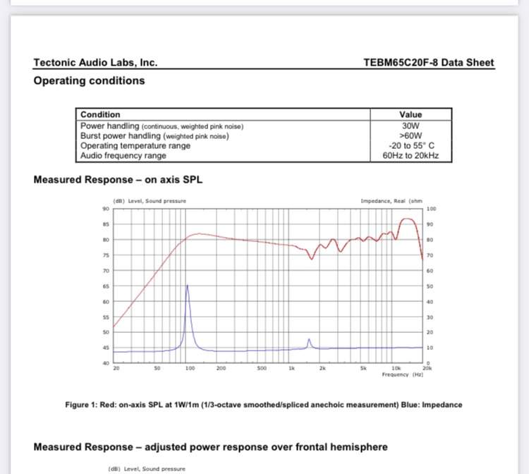

I’m from an extensive car audio background and I think you should consider looking elsewhere from skar. A super simple and super effective garage stereo to me would be the tectonics 3.5” bmr and the Dayton Audio dsa135 designer series passive radiator in the denovo .23cf knock down enclosure. I had a surprisingly good result with the bmr 3.5” in a .52cf cabinet with a 6.5” pr. Super easy and way better sounding than the skar stuff for various reasons.
This is one powered speaker per box that will play from around 60hz to 16,000hz with the aid of the passive radiator. The passive radiator reinforces the low end similarly to a port but can be adjusted with washers that change the tuning frequency. I had mine tuned in the 30’s at the expense of loudness. Basically mine would play low but not loud. A good way to learn with adjustable speakers.

That picture and links got my attention tho. What's the high end frequency response on that Dayton driver? Would you say that it's ample enough to not need a tweeter? I bet the bass response is right and deep with that pr
Don't wire them in series.
Wire a 150 uF NP electrolytic capacitor in-line between your amplifier positive terminal and your midrange driver positive terminal:
https://www.parts-express.com/150uF-100V-Non-Polarized-Capacitor-027-364?quantity=1
Wire a 10 uF NP electrolytic capacitor in-line between your amplifier positive terminal and your tweeter positive terminal:
https://www.parts-express.com/10uF-100V-Non-Polarized-Capacitor-027-340?quantity=1
(Each driver's negative terminal is wired directly back to the amplifier negative terminal.)
Crude, but should be effective enough for background listening levels in a garage.
EDIT: I'm assuming 4 ohm drivers - half the capacitor values for 8 ohm drivers.
Treble performance is actually a little bright and would possibly need to have the treble knob backed off a hair. In my house, where I’d be very seriously listening on occasion, I would be looking for something a little higher end than this particular bmr. But, in a shop where you have rattling tools, all kinds of other distractions, this fullrange driver in my opinion about the best for the job. To jumble up a bunch of car audio speakers and then try to figure out crossovers would be a shot in the dark compared to a set of beefy and capable fullrangers. Here’s the manufacturer response data which is pretty realistic to my ears.I did poke around on there to find some crossovers but I didn't know the right one to get so I figured I'd just run them in series to match the out out resistance on my receiver which is rated for 8 ohms. In my car I had a component set of Alpine S series that I wired in parallel with the in line cross over that is included and I figured it would work the same way. Wire the 250hz lpf first then from there to the woofer, then to the included capacitor in the tweeter.
I love my 2” bmr as a mid tweet in my shop with the Anarchy 7” woofers and Dayton Reference 8” pr’s. I would still be running the bmr 3.5” in these enclosures but I wanted some major bass extension so I went with a long throw woofer and a ridiculously long throw pr (20mm) 🤯
Just a quick run through in winsld to show the basic bass charectistics of the bmr 3.5 in sealed and pr enclosures. Both present the 2db bump around 150 hertz which may or may not be audible in my opinion especially in a shop environment. With the pr I suggested useable response can be had down to the mid 40’s. If you’re planning on using a separate subwoofer then the sealed cabinet is probably better and these speakers and a sub would probably be fantastic.
