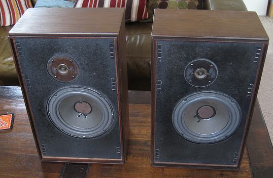

I've just pulled out my AR 6 out of storage. Normally I use big Advents and not afraid to play them loud as they handle it just fine. But I haven't used the AR 6 for about 10 years and forgot how much they can handle compared to the Advents. I'm guessing it should be same but I'd welcome any reassurance before I give them some good power. That is from people that have them off course. They sound great, it's been a looong time. 🙂
Good luck with that. 🙂 Even if they ever could play at whatever you consider loud, the suspension and foam is not what it was in 1970.
If you need speakers to abuse, sell those and get something more modern. I'm sure a lot of AR fans would love to have them.

Nah, they're in perfect shape, I've changed the surrounds over 10 years ego to the material that doesn't deteriorate. Checked everything, the speakers are like new and all ready using them for couple of days at moderate levels. I NEVER abuse good speakers.
One of my friends used to have the AR6 in some version. They work best close to the wall and with a 10 inch bass go very loud indeed.

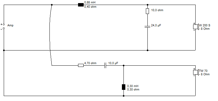

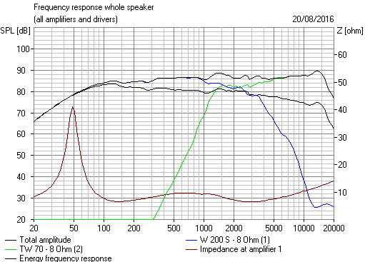

AR used various filters over the years, some overly simplistic like single cap IMO. The main points are in the one below which is a sort of hybrid of early and later models. The tweeter was very flat and ferrofluid in later models, and would do better than the Visaton TW70 I used for the sim which is not so flat. The Monacor HT-22 would probably be a good replacement for a broken tweeter.
What made them sound good was the tweeter had significant output to 1.5kHz, so dispersion (power response) was good. You couldn't push a dome tweeter this hard at low frequencies. And the acoustic suspension is a very linear way to damp a cone, so low distortion when loud.
