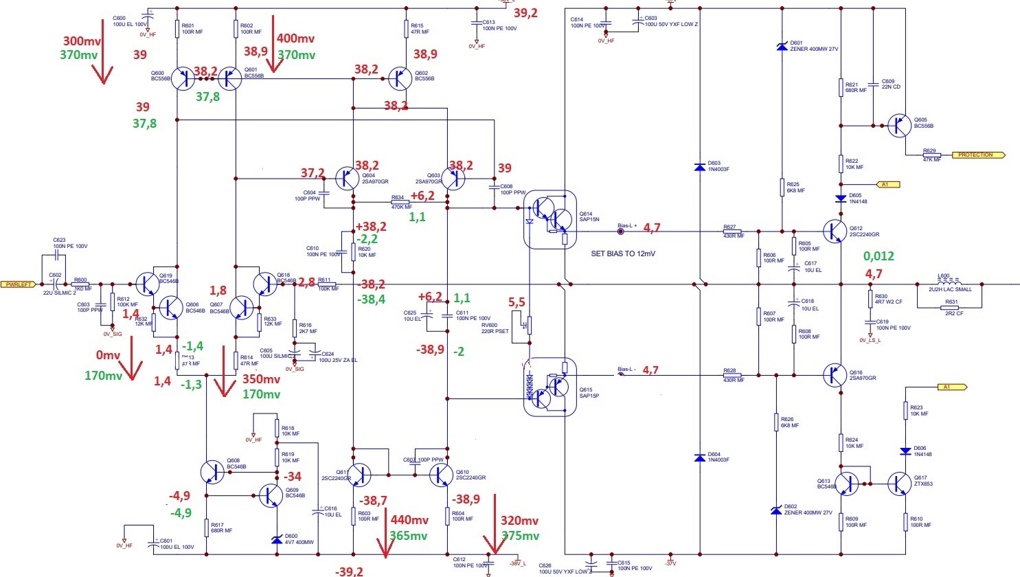

I also have one Arcam A65+ with 4,2V dc on left chanell output. I have measured almost all transistor and found no failure. I changed 10uf c625 and amp was going on for 3 seconds and again in protection. I have 1,2v on one side of capacitor and -1.2v on perfectly working Right channel but on Left side -39v and on other side of a cap +5.4v...so then i have around 4.8v on bias trimer and around 4.2 on output and around 4,7v on both bias points. I can post later picture schematic with testpoints to easier clarify where are differences in testpoints.
As i wrote when i was replaced C625 10uf elco it was turn on for 3 seconds than again in protection mode.
Q615 appears to be failed, as your measurements show base to emitter (-38.9 -4.7)= -43.6V. Your working channel shows 2V, much more reasonable.
You mentioned measuring the transistors--- how did you test them?
Q615 is the likely culprit, but I suggest an additional in-circuit test. With power off, use ohmmeter to set RV600 to minimum resistance so that bias current is minimized. Then apply power and try measure base-emitter voltage directly at Q615 leads. The objective is to rule out any open connections and prove the transistor itself is at fault. Be very careful, as a slip with the probes can provoke massive damage. A safer procedure is to solder-tack test wires with power off and bring them out so a safer place to make the powered measurement.

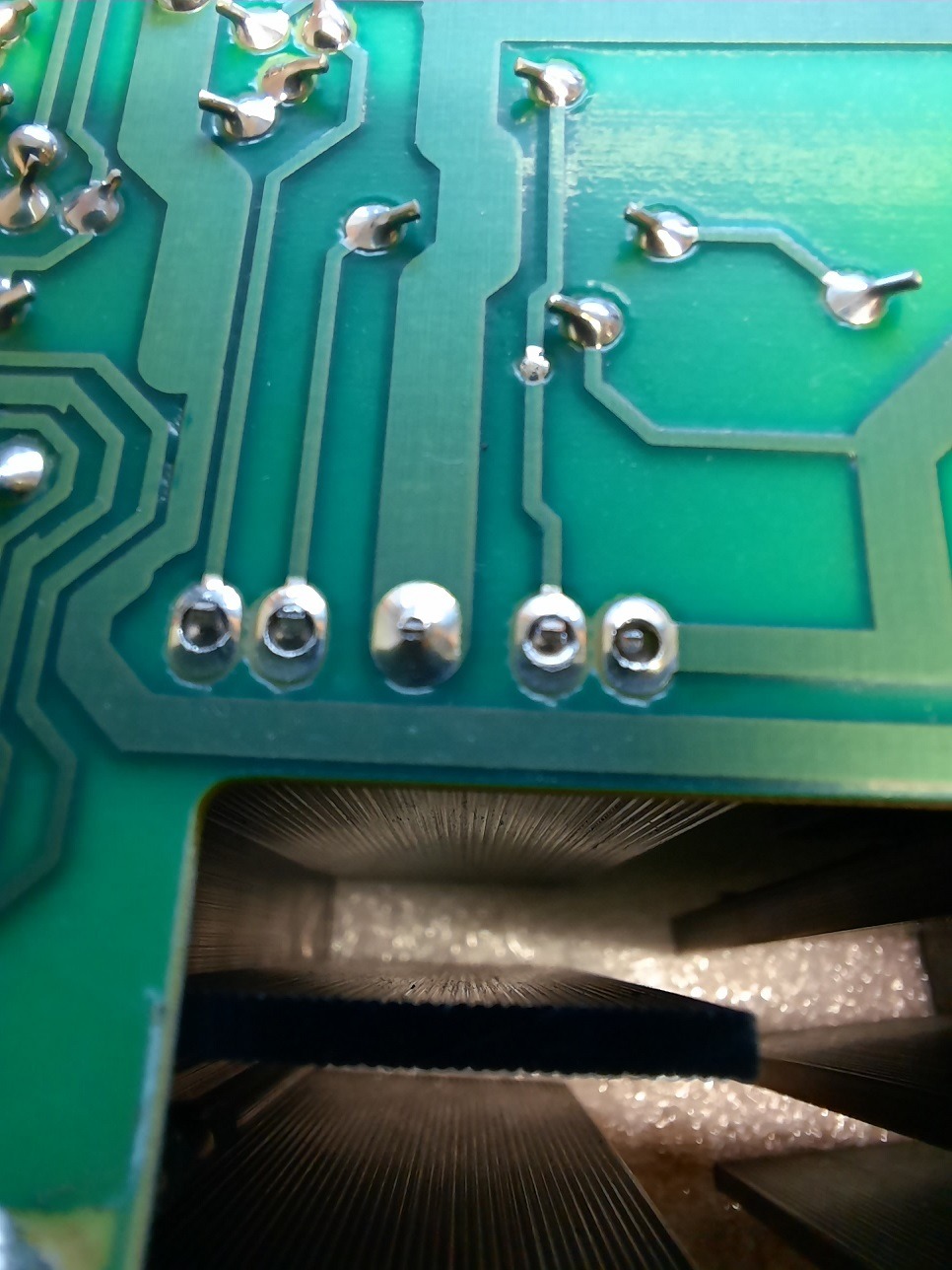

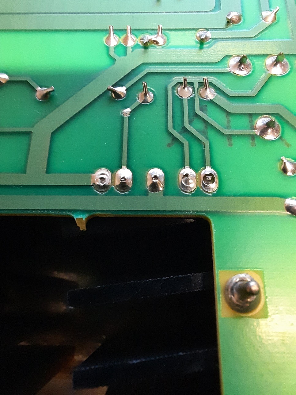

I also thought first that output darlington is partly damaged, but when i compare multimeter diode test values were the same on both pairs. So today i deceided to demount whole pcb out, because i did not find any faulty part. Look what i found when i turn around the pcb around 😉
