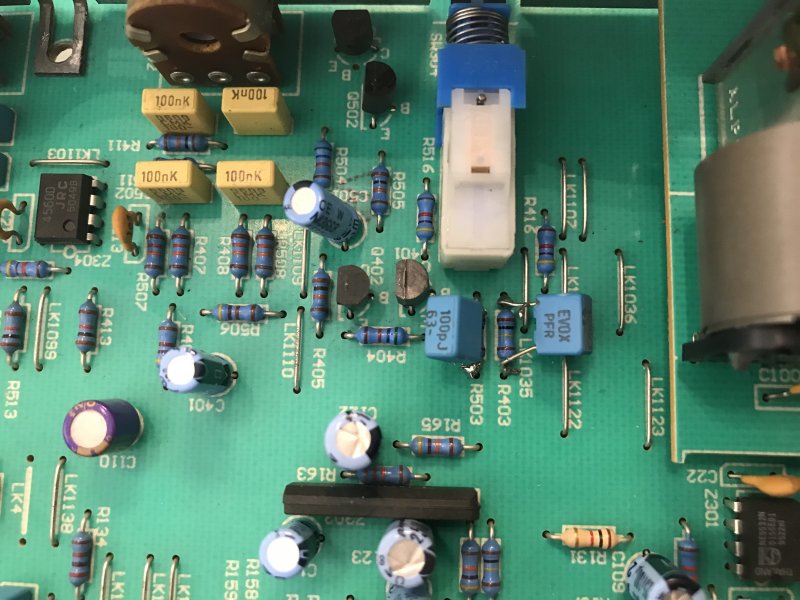

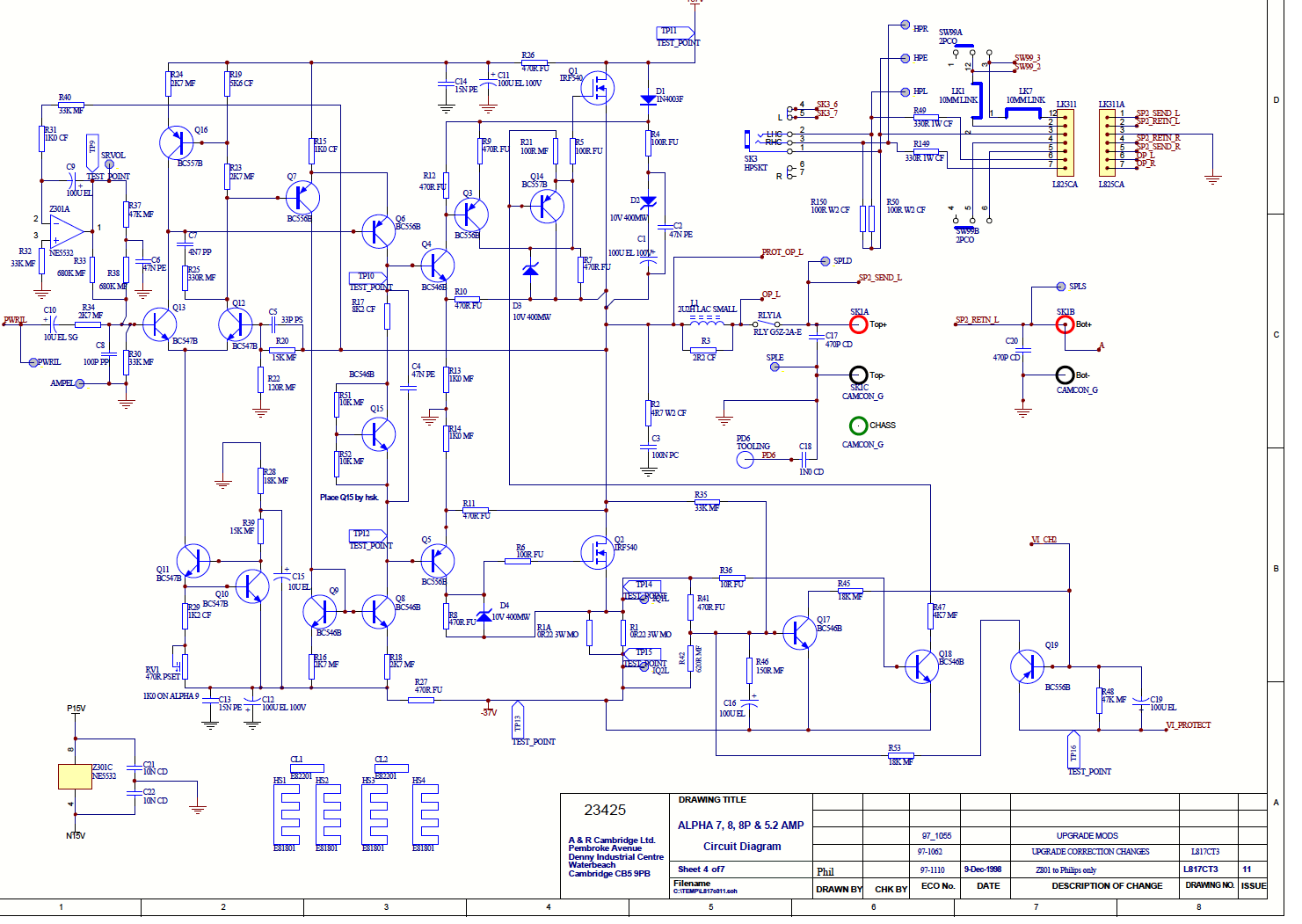

While testing the amp R2 blew. It looks as though it has been replaced before so I wonder if some dodgy repairs have taken place in the past. Some caps have also been added across resistors R403 & R503. I've replaced R2 but now the left channel doesn't work at all. The noise has gone though. The pre-outs work normally but the tone bypass button intermittently cuts of the power for some reason. Also the circuit diagram I have doesn't exactly match my PCB which doesn't help. I wonder if there were some revisions to the design as the diagram I have is from 1998 but the PCD is dated 1996.

So it looks like someone has tried to fix a problem in the past by fitting the caps. R2 blew before I removed the caps but after I'd changed the op amp in the tone control circuit. Now the left channel is dead (with just some faint hiss) but the pre out is fine. Not sure why the tone bypass should cut the power off. I should probably use a bulb current limiter before powering it up again.
It is better not to introduce a modification when troubleshooting. Chances are that the new opamp was oscillating/made the device oscillate. The caps were added for a reason. So putting back the 100 pF capacitors and the old opamp seems wise. If R2 blew your amplifier certainly was oscillating. Fixing the oscillation should be done first.

The op amp was a straight swap - a new RC4560D as I thought the old one may have been causing the noise on the tone controls. It's shared accross both channels. The 100pf caps were a modification soldered onto the component side of the board presumably when R2 blew previously. I'll put them back.
