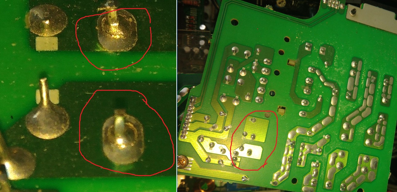

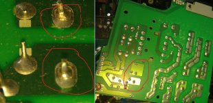

I found the problem. The reason is the destruction of the soldering of the Relay contacts in the power supply unit. As an example (picture) repair of the AVR 300 receiver. I hope I helped
There are a number of other soldered connections that look suspicious too. That's slack inspection work and the board should have been sent to rework, following the appropriate inspection, IMHO.
This could be fatigue failure over time I think, not lack of inspection. Probably due to thermal expansion of PCB and relay differing (relays heat up internally when active).
I continue to show defects Arcam:
there is a lot of soldering destruction on the motherboard,
a swollen 1000x10V capacitor on the DSP board
so-look for soldering defects (relays, diodes), inspect the capacitors for BLOATING.

In the case of the Arcam AVR300, limit yourself only to soldering the destroyed soldering, and replacing two capacitors 3300x25V 2200x1000V
Chinese solder contains less tin than is desired, and Arcam is partly to blame, for cutting the price to unprofitable levels for the supplier, who is left with little choice but to reduce quality.
If it is RoHS lead free solder, reflow all joints with leaded solder, as lead free tends to crack after some years, it is brittle.

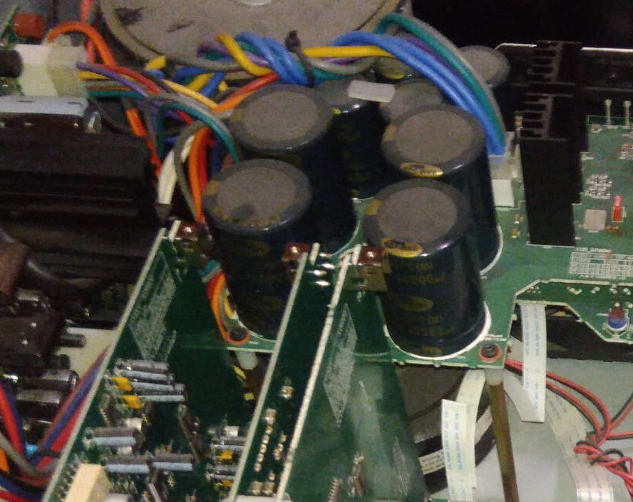

Better to replace all Samhwa caps, good or bad, with standard 105 degree capacitors.

The cap failures might be due to the Capacitor Plague a few years back. The formula for cap electrolyte was stolen from Elna and used by some Chinese start up cap companies.
Unfortunately they didnt get all of the formula and didnt include the additives that inhibit corrosion. I think it caught out quite few well know companies.
By the way the high speed lorry anecdote was coined by Enzo Ferrari when he was running Alfa Romeo's and was about Bentley,s in the 1920's. They were high speed lorries but won Le Mans.

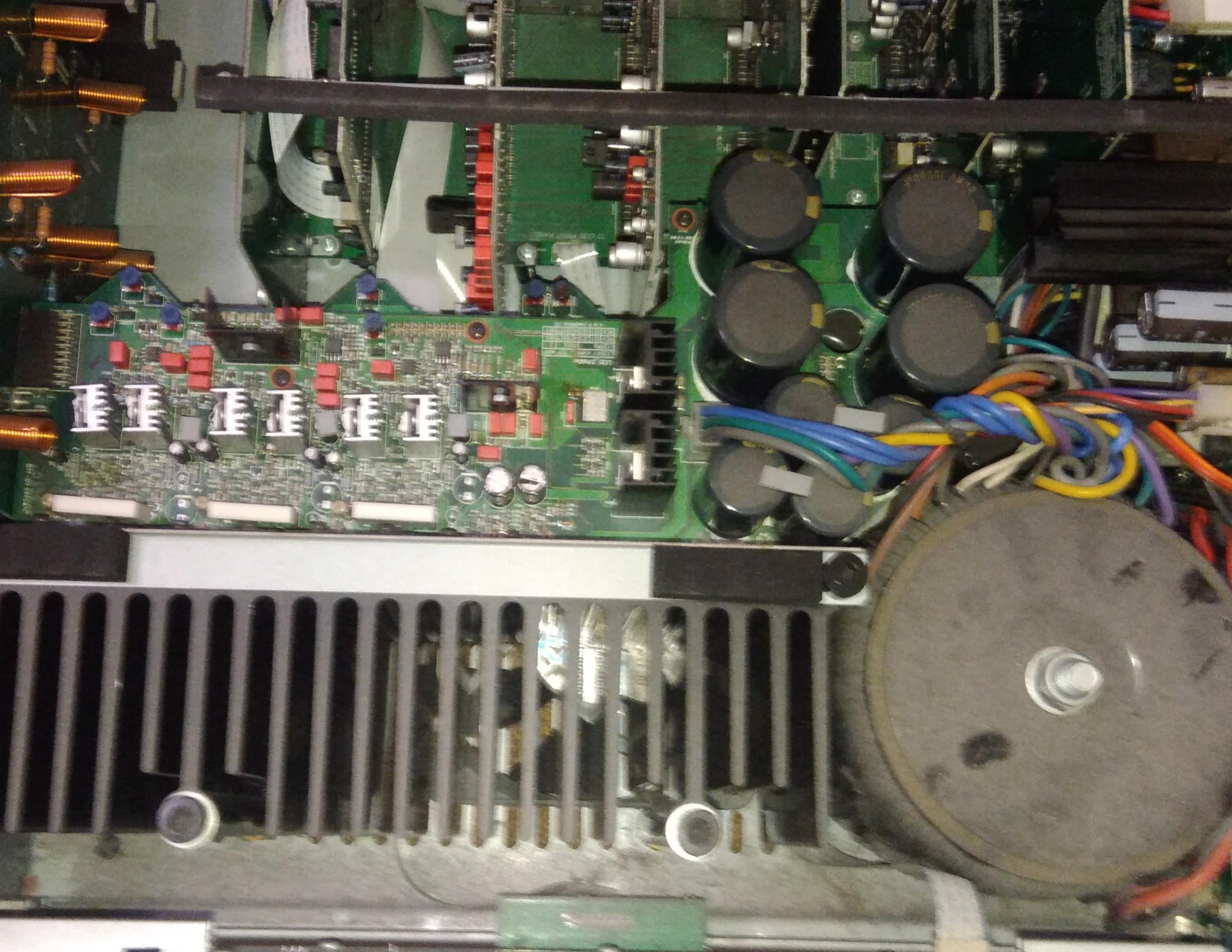

1. 1000x10V
2. 3300 x25v ( x35v); t-105C
if your capacitor is not swollen, then first just solder the contacts of the power relay (the first message is at the top, a small side board). build arcam and turn it on. if it works (and via digital input ) then finish the repair on this.
if your capacitor is swollen, then replace the 3300x25 capacitor, a new one (necessarily at 105С !) place it vertically in the standard holes.

on the photo of the Arcam AVR600 (2010 years, China) . it is clear that cheap samwha (samsung) capacitors are installed.
the Chinese Arcam AVR600 had a lot of breakdowns ! I don't think that because of the capacitors, the symptoms- Clicks, loss of sound or timbre - it was a horror.

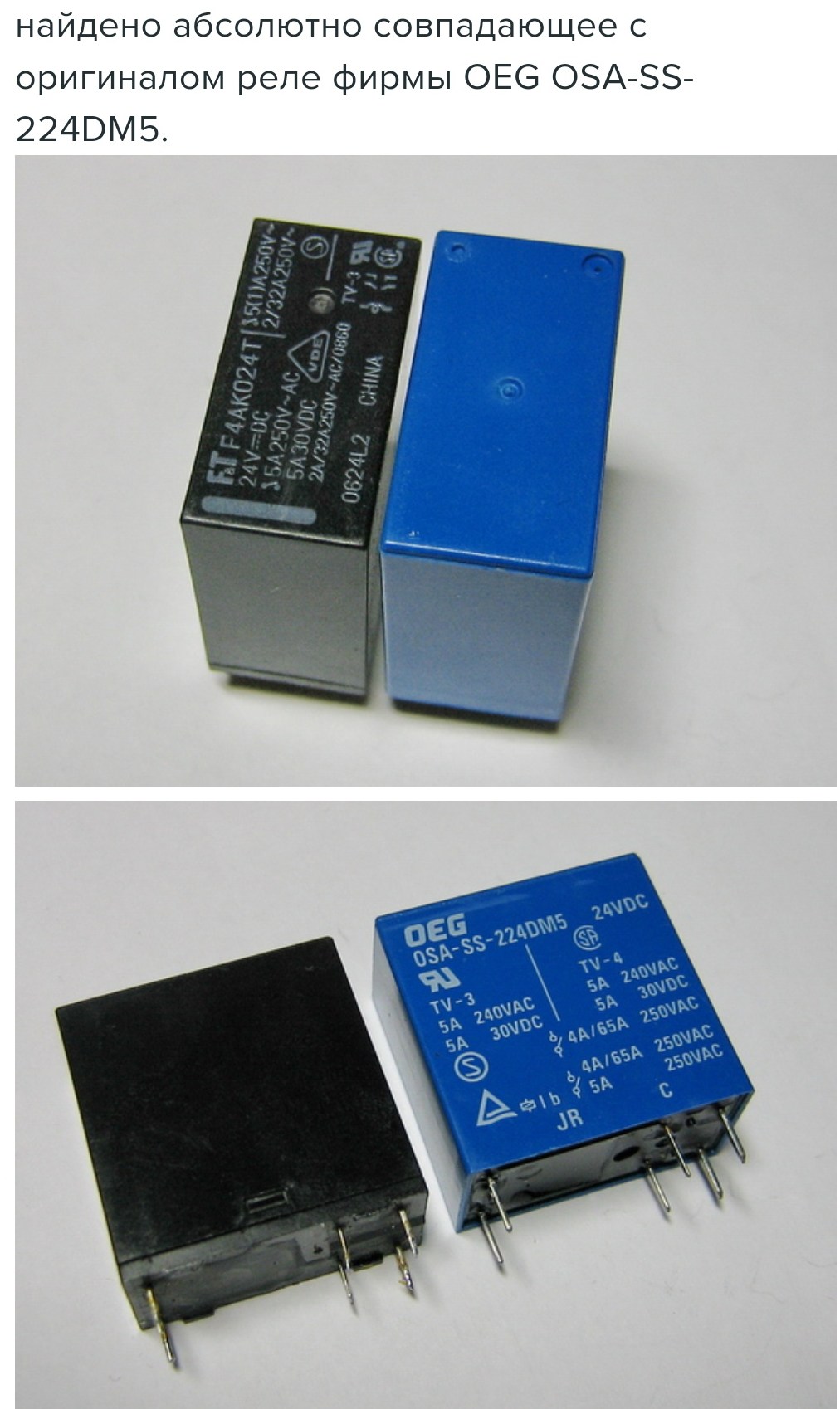

I was repairing the relay in the PIONEER AX10.
The defect was as follows - when turned on in one channel, the sound was quiet (or there seemed to be few high-frequency frequencies), when the volume was increased, the problem disappeared. I was removing the relay. I turned the relay upside down and drilled (with a dental drill) holes in the relay cover, injected a wurth contact cleaner. I turned the relay upside down for one day so that the liquid would leak out. Soldered the relay back. the result is that the relay has been working well for 2 years.
I didn't want to buy Chinese relays in China and I want to leave my native relays. I don't believe in Chinese goods at all - they save money everywhere and spoil the native (original) product. The Chinese are the complete opposite of the Japanese.

the photo shows the exact analogs of the relay from China - maybe someone will need it
